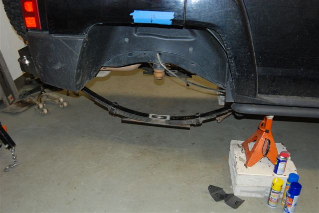

I got (4) big jack-stands...not sure the actual rating. During the SAS, I put each stand on 8" tall piers made from (4) 16x8x4 solid concrete blocks. I used the rock rails to support from, since I would be hacking and welding on the frame. This kept the stands out of my way for the 3-month duration of the project. I used some smaller jack stands to support the axles while I got them positioned under the truck. It was very solid, and worked great. It worked so well, that I decided to keep the (16) blocks around for future H3 work...
