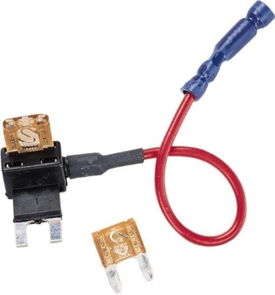

Yes, very easily using an Add-a-Circuit fuse tap. Install it in any keyed fuse position, and run the jumper to the load side of the cig lighter circuit. I did this in my wife's H3 so she could use a GPS speedometer without it being on when not being driven.
can you post a pic of this add-a-circuit
