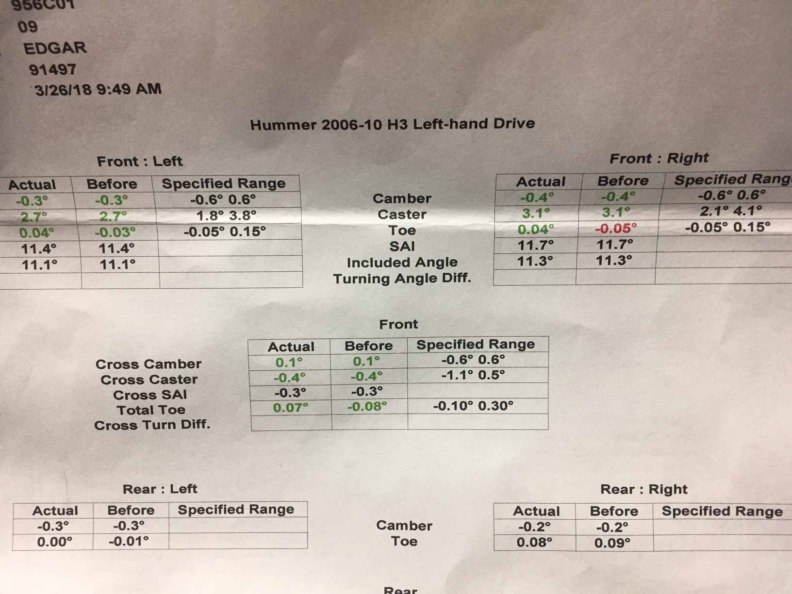

Got new Moog Camber Guide Pins replaced on the upper arm mounting wall on the frame and new Moog Camber Bolts & Nuts with Guide replaced and had the MMW adjustable tubular upper arm installed properly and final alignment setup as following:
Any comments in the alignment setup on camber and caster value, I have try to get the following caster setup:
Caster +/- 1.0 Degree
Left 3.10º
Right 2.80º
Cross Caster (L/R) +/- 0.6 Degree
0.30º
but was not able to setup it up as per value so just set at the above photo indicated value which is actually used for a H2 ! The ride drive ok on highway at 60MPH no vibration or drifting to one side when the steering wheel is left without hands on for 5 sec !
