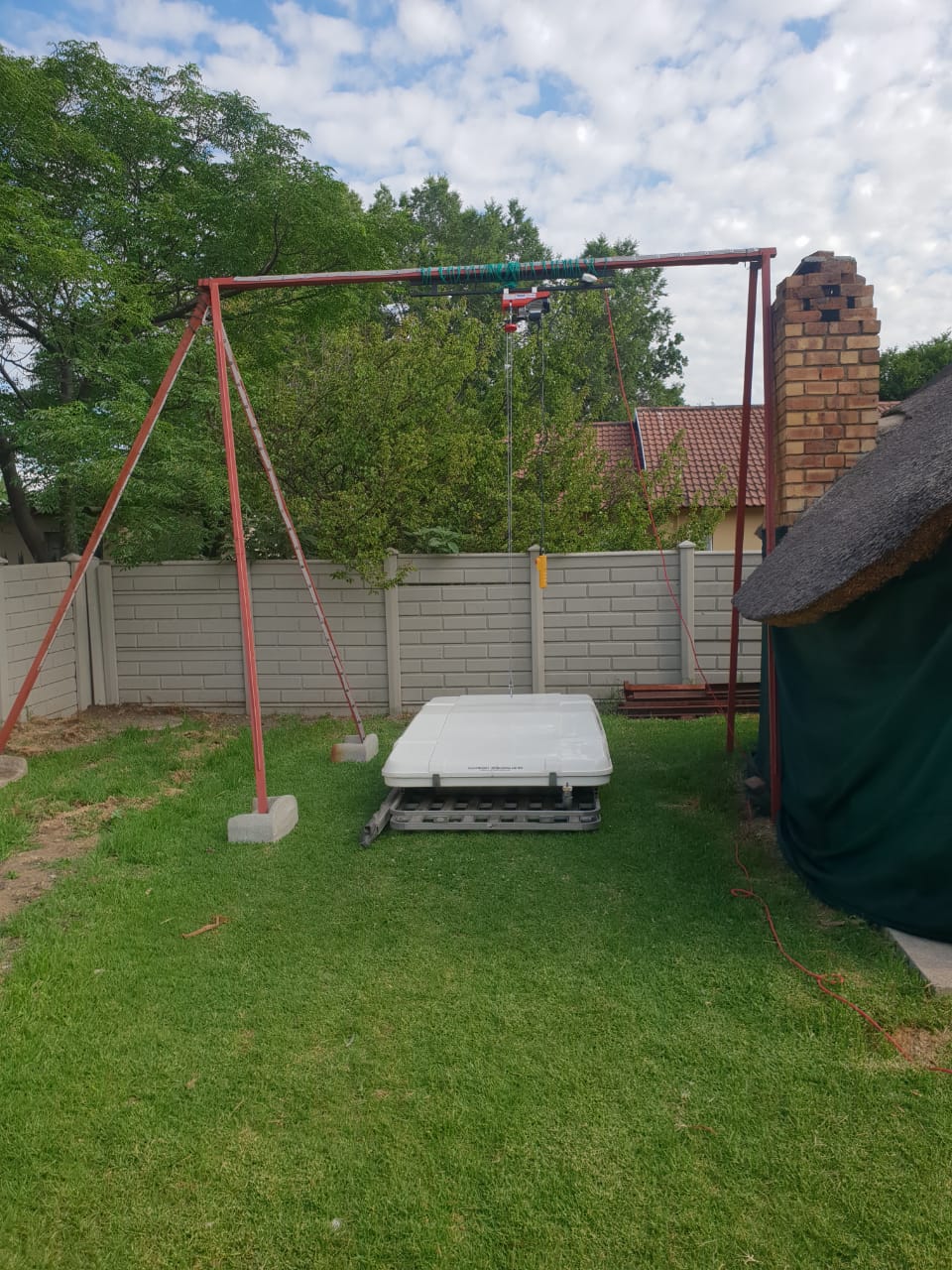

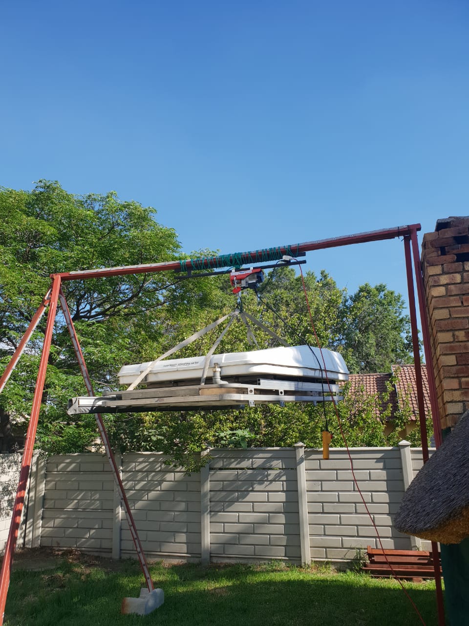

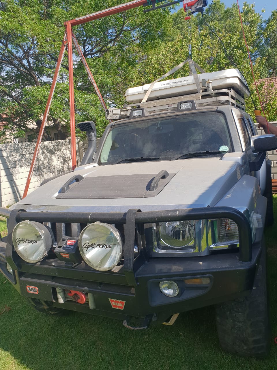

got myself a Maggiolina had shell rooftop tent, but the ladder that came with it was waaay too short, and I got myself a nice retractable one. and did the whole installation and fitment process, building myself a A=frame to be able to remove the roofrack and fit the rooftop tent, and then using the hoist with A-frame to get everything up and fitted again.
