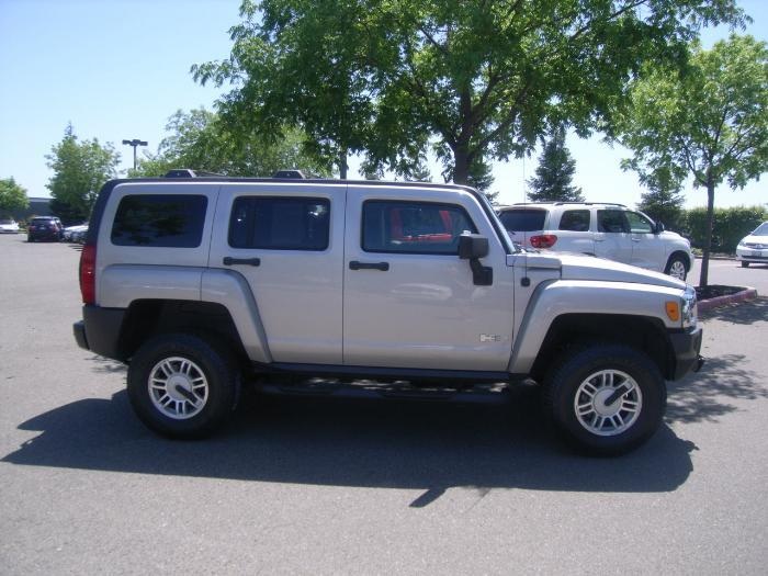

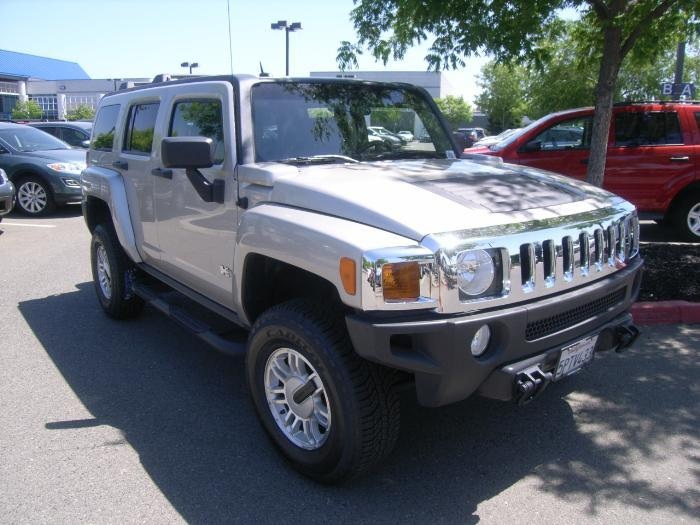

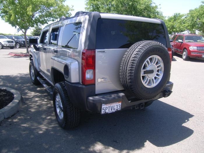

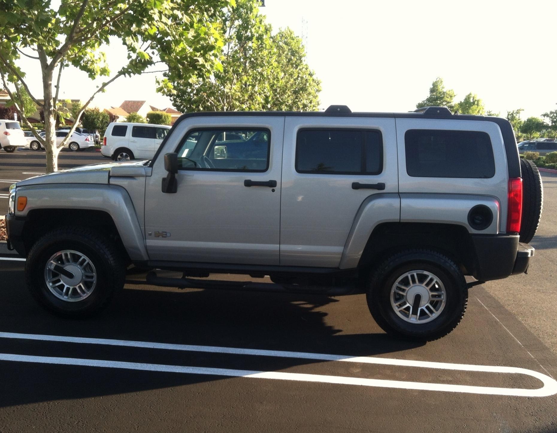

I know this has been beaten to death, however I want to upgrade my 2006 H3, Looking for tires and wheels. I want to run 35 in tires, don't know if I should stay with stock wheels and just get tires or upgrade tires and wheels. I like the H3 wheel however I want some black wheels which would look cool as hell on my H3. I can get tires now, however if I do I will have to stay with 16 in wheel when I do upgrade. The cheapest thing would be is to just get tires. I know there are endless post on pros and cons of stock wheel or 16 versus going 17 or 18. Any input would help.

Welcome! 35s look great on 16" rims. If you need to watch your budget, just spend your money on good quality tires. For blacked out rims, some owners use Plastidip.

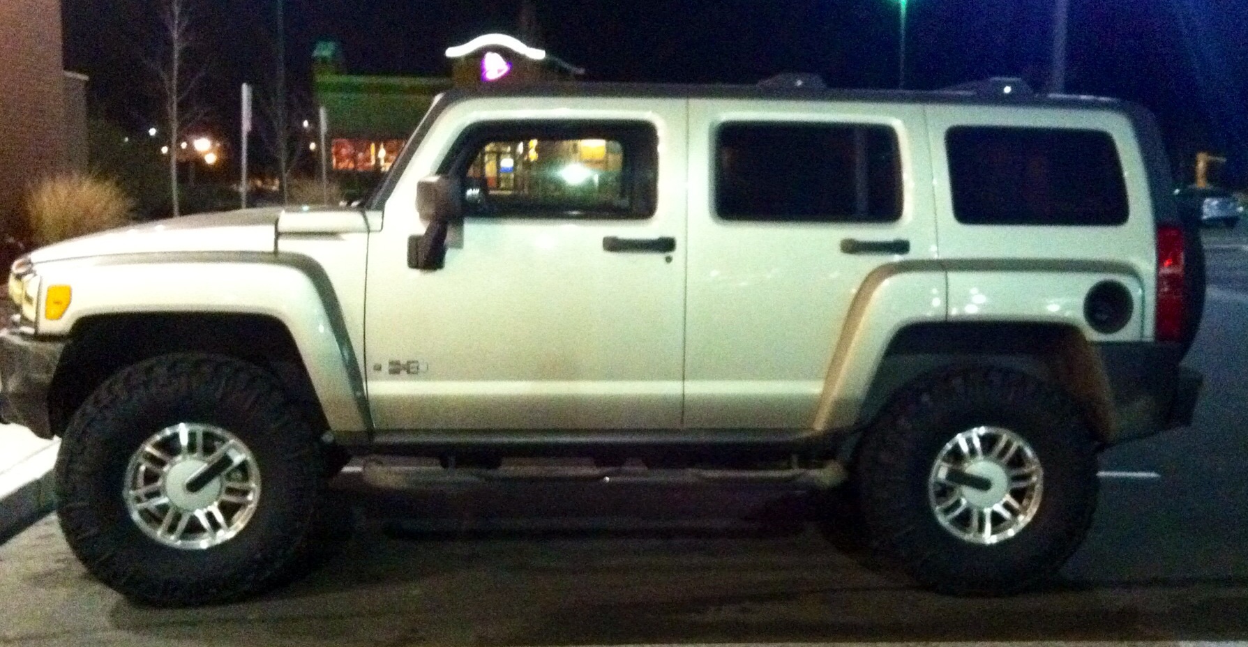

Just upgraded the H3 315/75/16 Nitto Trail Grapplers, leveled and aligned. First pic.

Welcome to the forum. Nice cherry 3!
It is good you decided to stay with the stock wheels. What nobody else mentioned yet is the H3 has a 5.84" backspace, which helps keep the wheels inside the fenders. Most (all?) aftermarket wheels have less backspace so the wheels will stick out more and rub the fenders at full articulation. Stock backspace is much better for wheeling.
The new tires look great. Now to do something about the nerf bars!
