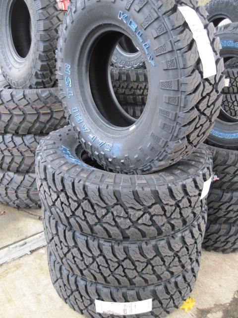

LT275/70R18
Check out the Kelly TSR. Good for road and better for mud than the BFG AT
