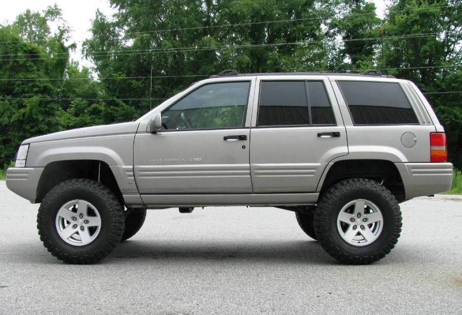

The three holes in the perches is a great idea, and they are there for you to make a wheel-base adjustment if needed. As you lift the frame up higher from the axle...the axle housing will shift forward from where it is now. You'll be adding around 5" of lift, and this can cause your rear axle to shift forward slightly (around 1" to 2"). When you drop it down off the jack, and put the weight of the vehicle on the suspension...you may notice that the gaps between the tire and the fender (when viewed from the side), will be larger on the rear of the tire, and smaller on the front of the tire. On the H3...its not very noticeable but, it is worth mentioning and you can correct this by un-bolting the U-bolts and re-positioning the leaf spring center pins into one of the other holes in the perches. Jeep ZJs, WJs, and XJs are all very prone to this problem when you add lift to them. Here's a photo that shows what I'm talking about...
As you can see...its real obvious on the Jeeps because they have itty-bitty wheel openings (and ZJs & WJs have 4-link rears). With 35"s you might not have an issue but, if you ever want to install bigger tires...they could possibly rub the front of the H3's wheel-well. So...check the gaps when you're done, and adjust the axle position accordingly. (that way people won't think you're a hack!). -LOL
In the end, I had to shift my axle rearward (to the front hole on the perch). This minor change was all it took to re-center tire in the wheel-well. Make sure to check your driveshaft yoke before and after your SOA, as moving the axle rearward will pull the yoke out another inch from where it normally sits. The H3 has a HUGE slip yoke on the rear driveshaft...probably 10" long or so, and I think most H3s are fine. But, I actually got a new driveshaft built that is 1.5" longer than stock, just for this reason. I was worried that driving around with the yoke pulled out 2" or 3" from stock, might tend to woller-out the tailshaft bushing and seal. Not sure if that could happen but, I didn't want to take any chances.
