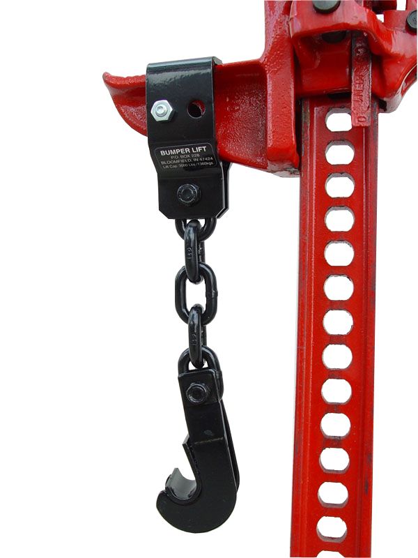

For the hi-lift I'd recommend getting a bumper mate or whatever they call it. Not many flat places on the H3 to use the hi-lift.

Chain can be used with the hi-lift for a winch setup, but I certainly would not use it like a snatch strap; maybe as a tow chain.
This works on the D-rings....
