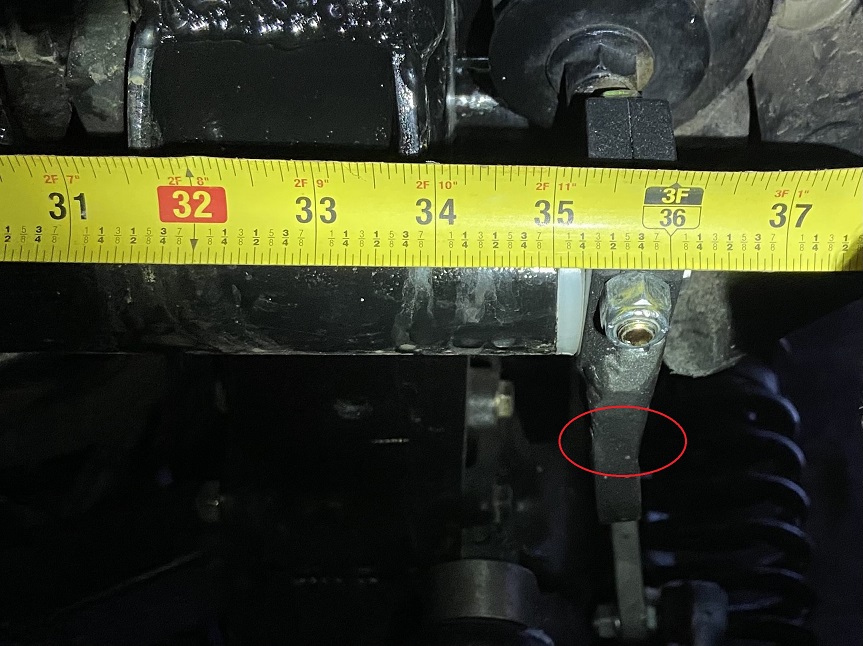

I re-re-measured the sway bar and then did some digging in the files and found the packing slip. Its a CE-9901-18 Universal Anti-Rock Kit - 36" X .750 Diameter Bar - W/ 18" Steel Arms.
Its mounted just below the bottom of the frame and 1" behind the center of the front body mount. I put a slight outward bend just before the dogleg on the 1/2" arms that just clears the steering box.

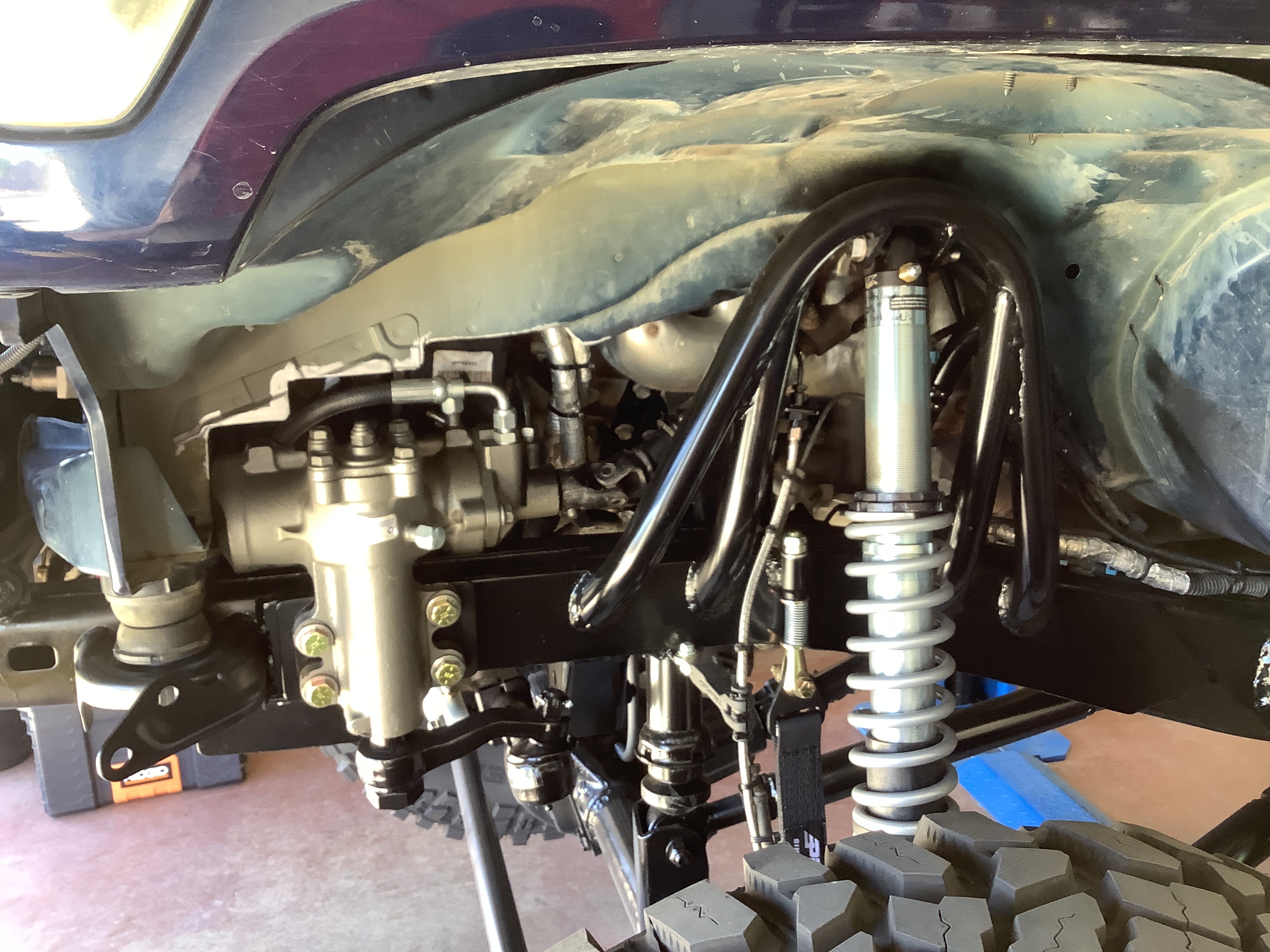

I've got the FJ60 steering box set as far back and as close as possible to the Ballistic Fab adjustable coil / shock mounts that 4Speed recommended.
You can see how far back the steering box is mounted on the last post of the previous page. I don't know that I'd be able to clear if I'd used a Delphi box.
If I could go back, I'd look into shoehorning an inboard beefed up and ported JK box on the inside of the frame with a PSC ram. Stupidly, I rushed a lot of things
to get it back on its wheels since it was 60 miles from my house and driving 120 miles every day I worked on it was killin' me.
I think you went the right route without using a JK box. I have never been impressed with them, they barely could turn 35s without ram assist on my brothers JK. My xterra box turns 43s easier with ram assist then his JK box on 40s with ram assist.
I don’t think the box turns as tight either

No room on an Alpha rig for inboard box. Power steering pump is right there. I shimmed my Nissan box out with a 3/8” spacer shim to give it more clearance between pump reservoir and steering gear. I now have about 3/4” between gear and return hose nipple before return hose is attached. I also replaced both motor mounts while I was doing conversion. Try finding a set of those . Dealer item only. No after market units out there like for 5 cylinders. Rock auto lists them but the are genuine GM. My dealer had to get one of each from different dealers back east. My mounts weren’t broken but had 165K on them. Much easier to change after you cut off all the IFS crap from frame.

I guess I’m glad I have the 60 series box especially since I have a sway bar set up now. It turns 37s fine and I imagine will be that much better off-road when I get around to installing the ram and replacing the tired pump.
