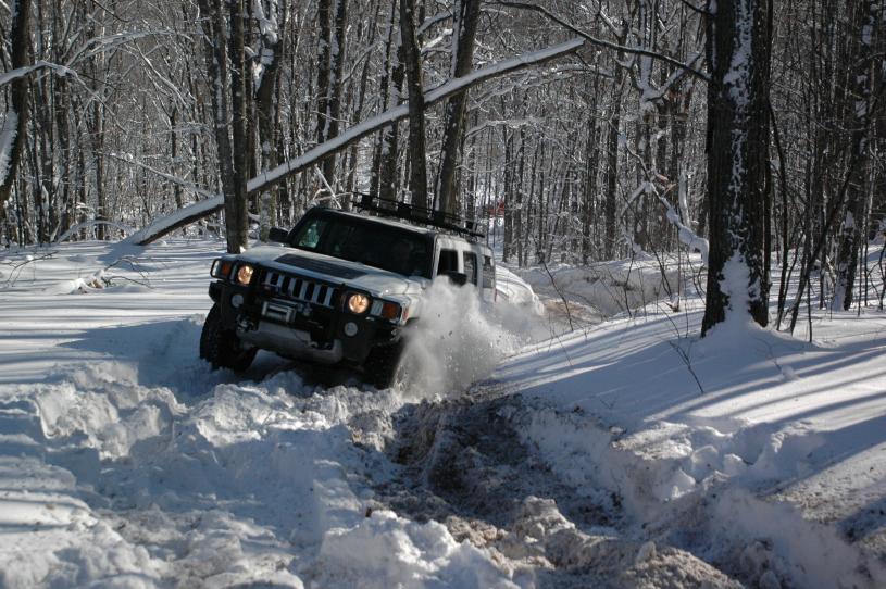

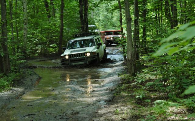

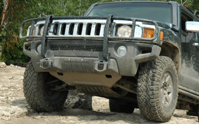

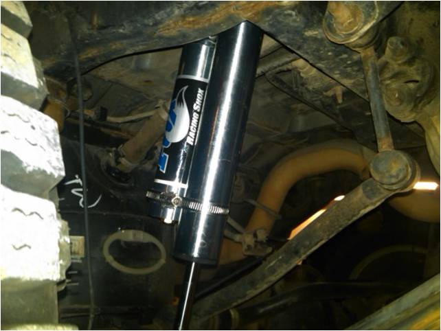

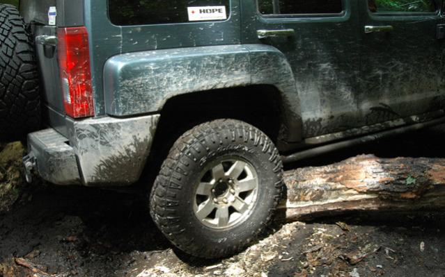

My '06 daily driver has the following off road upgrades and has served me very well.
285x75x16 tires
OEM UCP
OEM rocker rails (aka sliders, aka rock rails, aka rock sliders)
Hunner skids
Fox reserve resevoir shocks
GM performance air intake
Budget for a CB (even a "cheap one") and antenna
Strap (at least 20')
Jack (I carry both a Hi Lift and a hydraulic bottle)
Good accurate dependable air gage (Sears - $10-14)
air down (Staun, ARB, etc)
Co2 tank (for airing back up)
spare parts (tie rods and half shafts)
tools for trail use if needed
Tires and bottom protection are the most important with a CB mandatory on the runs I go on. Most of the other stuff, typically someone in the group has, but you'll want to carry your own eventually.
