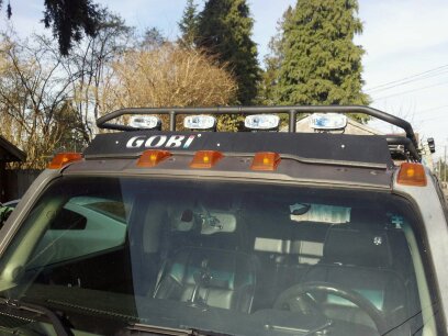

I got some PIAA 2100 series lights for Christmas. I was looking at mounting them on my Stealth, but I'm not sure the best way to do that. There are what appear to be mounting brackets there, but nothing lines up.
The mounts that came with the lights . .
The mounting plates on the rack . .
They definitely aren't even close to lining up . .
Should I be drilling holes in the rack?
I believe this is a really common combination, what have others done?
Thanks!

I wouldnt be drilling holes in the rack, I would drill holes in the brackets if it was me in your situation. If you mess up on a bracket you can get a new one...if you mess up on the rack your **** out of luck haha

I have the 2100's up on the stealth. I remember they don't match up. Drill the brackets. I think I just positioned them and drilled one hole in each, it was a couple years ago.

Does the black bracket bolt down to the aluminum piece? If so, is the problem the bracket hitting that bolt for the wind deflector? You could put a spacer under the aluminum.
I'm just guessing from the pics. Maybe I'm way off. Come on up to the place and we can it done! We could even make custom brackets if needed.

I think the aluminum pieces are meant to be mounts for some other brand of light. I think I'm gonna drill the brackets. I'm down in Tacoma this weekend but I may take you up on the offer of help later if it doesn't work well.

Gee, that made mounting them a bit easier. Still gotta wire them up.
