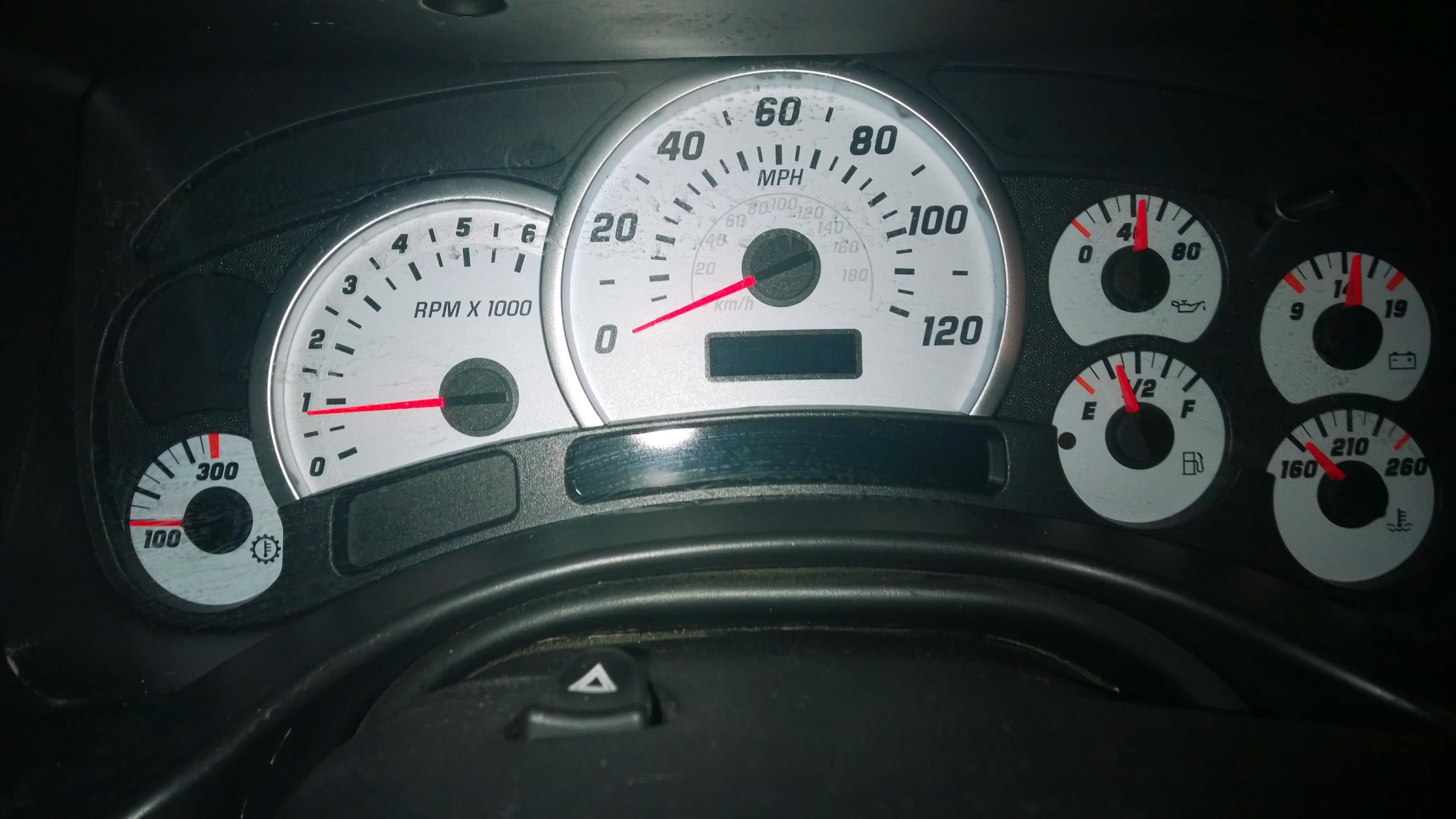

Dont think its an LCD blow out as if you look close you can see the outline of the icons. I'm I right? Sorry late reply was on vacation no reception.

Definitely a loose plug, when I drive for awhile all the lights come on 100% bright after driving for awhile going to use a scanner and see if it's possibly a spark plug or something
