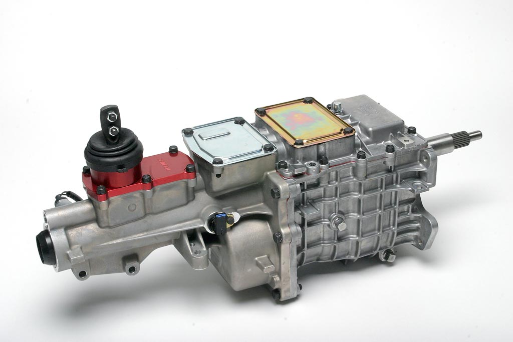

You should try a Tremec TKO-600. I run one of these in my Impala, and it is a slick piece. After blowing the hell out of several Muncies and Super T-10s, I finally bit the bullet and forked over the $2600 for one. Best money I ever spent. I abuse it like I stole it...full-thottle (no lift) shifts at 5500 with a 502. It never misses a beat. The trans is available with several flanges and input shafts for whatever bell housing & clutch combo you are running. Best of all the shifter handle is flip-able and adjustable...so you can get it to come up thru the stock hole (or close to it). It uses an internal, top-loader style shifter so there is nothing exterior to jamb up like an old-school gearbox...
I think they now offer a 4WD version that accepts a standard t-case adapter...but I could not find any info on it. I know they make em because several full-size guys are running them in their 4x4s.
Another option is the Tranzilla...a beefed up T56...
https://www.motorator.com/blog/gene...zilla-tremec-6-speed-conversion/#.WJt-gvkrKUk
P.s. The Tremec can be had with either a VSS or a cable drive speedo. Comes with an internal reverse light switch and a pig tail ready to connect to your back-ups. It is quite large (much larger than a Muncie) and I had to raise the "hump" in my Impala to get it installed. After the carpet and factory console was re-installed...you can't tell. I even run the original Hurst dog-leg handle and chrome shift knob.
Lol that's the transmission I posted in the link above...

I studied this transmission pretty well. You can mix and match different 1-4 and 5-6 ratios. You could probably also build one up from a corvette box by cutting the output shaft and make a custom adapter. If I would go manual, that's what I would go with. The shifter will still be about 4-5" too far forward so it would still take a custom shifter or console work.

Yes, I read that thread a couple of years ago and looked into it. The zf 6 is huge in comparison to the nv4500 and would be difficult to fit without a 2" bodylift. Also, the shifter is still in the wrong location.
That's a bummer. I always liked that tranny. Maybe in an H1....
