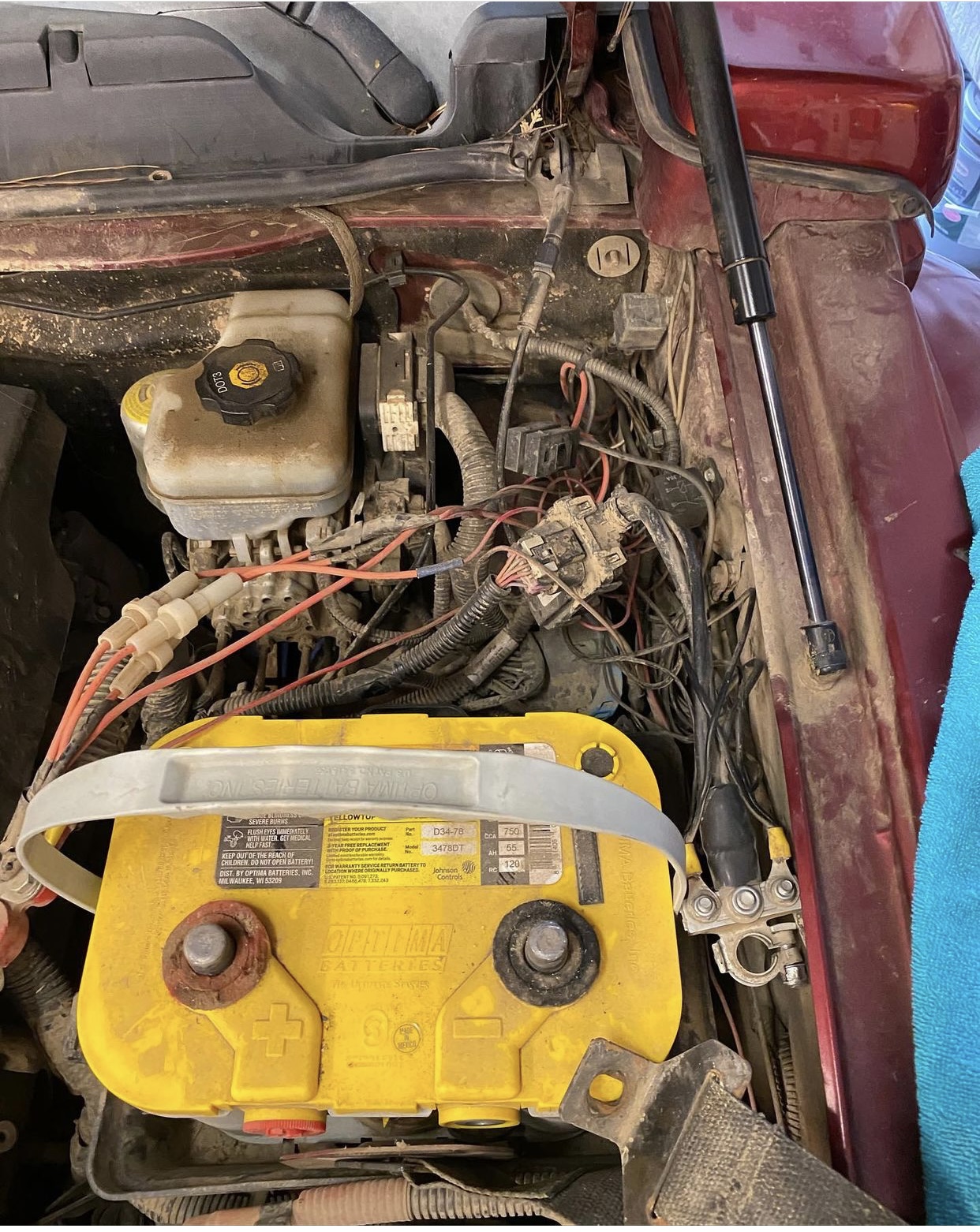

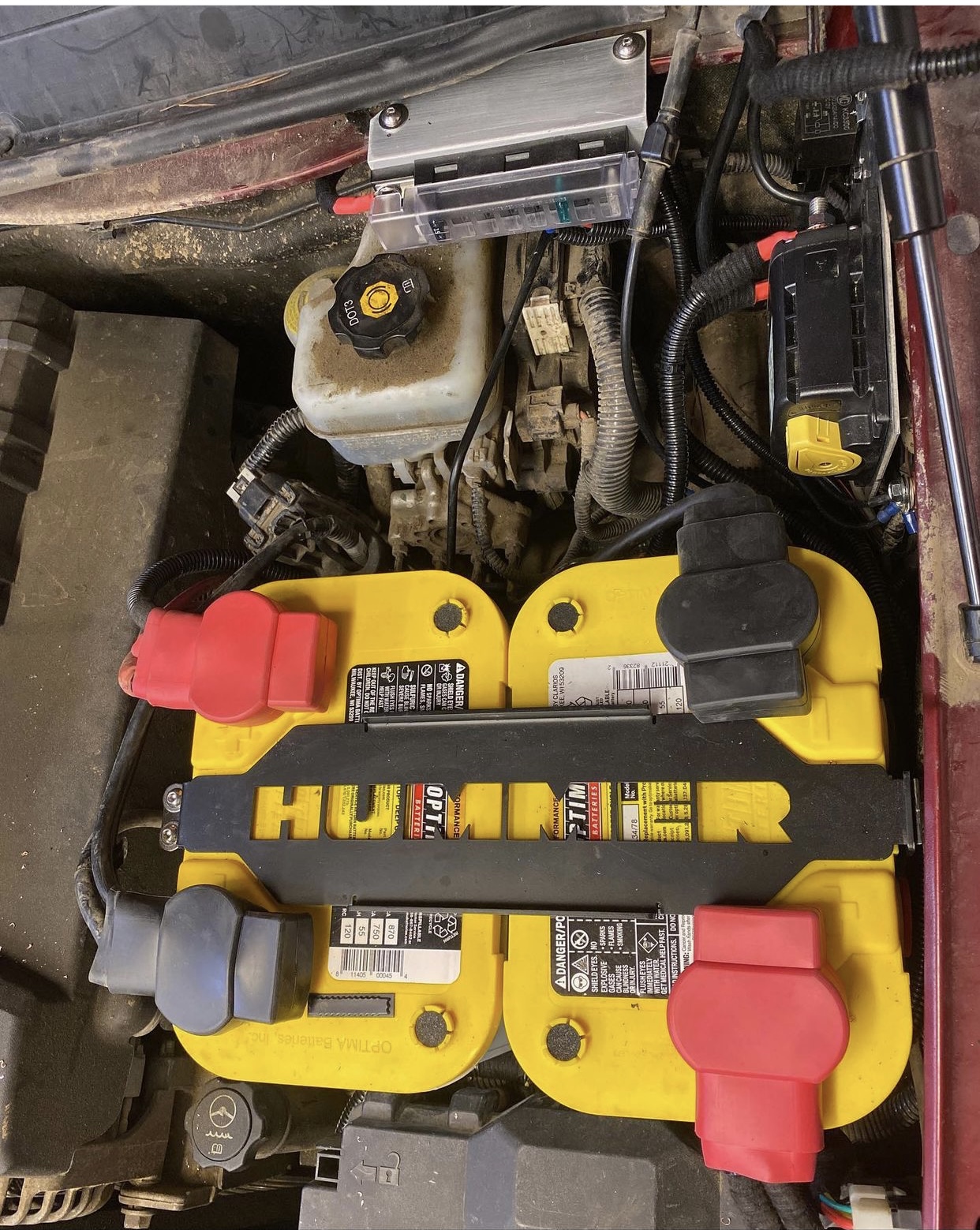

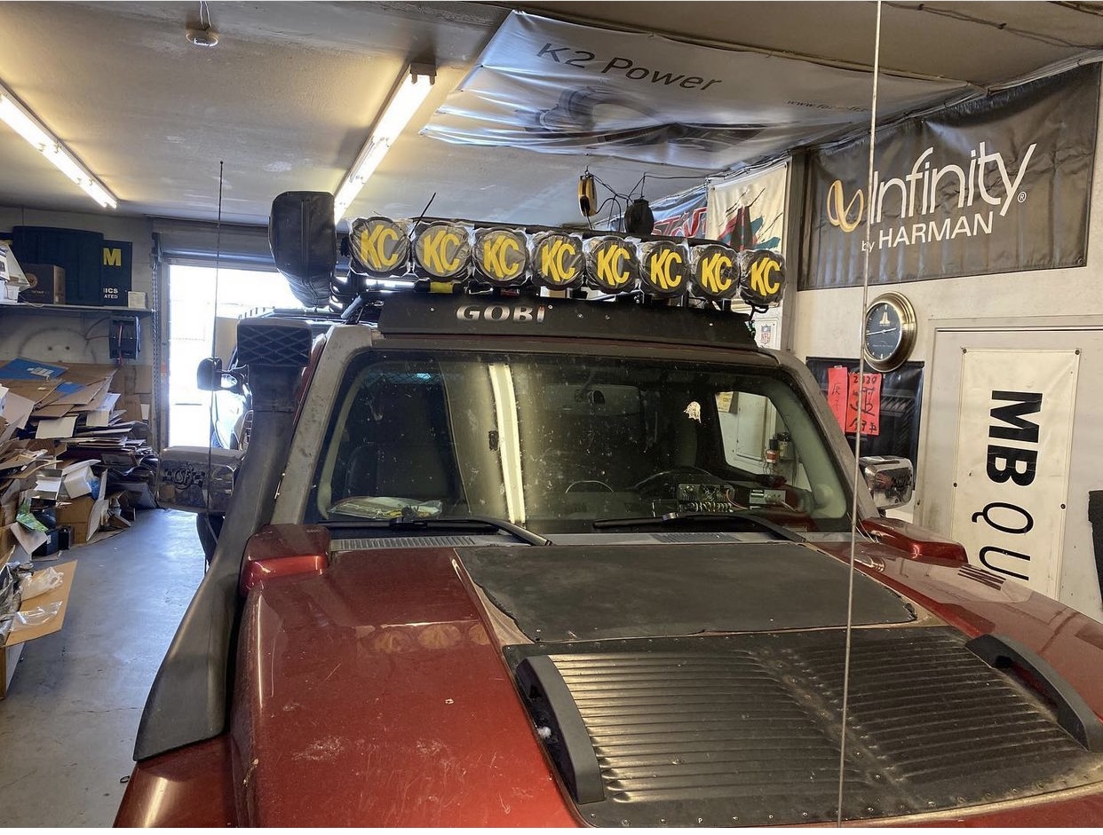

Next up I got a KC Gravity Pro6 light bar from a friend at a price I couldn’t say no to. At the same
time I get that installed I got a LED headlight adapter and dual battery tray from LasedDesigns. I opted for a basic $80 7” led from Amazon. For the dual battery tray I also added a blue sea switch that switches between batteries as necessary based on charge. 2C7248BC-2E17-4226-924A-DF92210C0FAC.jpeg814C825E-0B08-47F0-B2A8-A5CE7A545349.jpegA4C98FD6-B0EA-491B-9ED2-AA9BD4CE9EFD.jpeg50360F7C-FBBC-4F53-8EC4-318D89907C76.jpeg8E127983-D86D-4DC7-BE88-49A968166118.jpeg4EDDC1E5-F4D8-4DAC-9CC6-AC402885BC26.jpegAB3A8764-24FA-42F2-A16D-664C7EAE44AD.jpeg

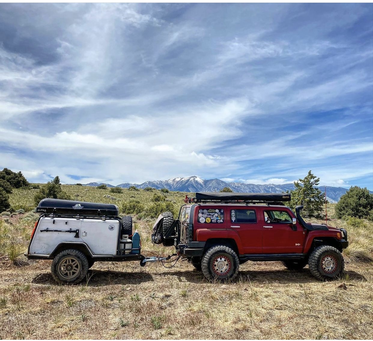

At this point I got an offroad trailer and a new rooftoptent. Quicker setup and takedown on this tent. Having the trailer allowed us to bring our Great Pyrenees with us on trips again. Ever since we had a baby the backseat has been taken up by the car seat and gear. FA927E6B-23C1-48C4-AE04-5E678EA7AE53.jpeg6A36E740-6EB4-4461-9D19-27F5B248F4F3.jpeg3BBC3F06-2392-4D2A-AC3C-586C6675724E.jpegDEE80948-10AB-4758-B0D6-2A990E168081.jpegB2351F3F-916E-47D7-A528-9D5F5ACD11BF.jpeg

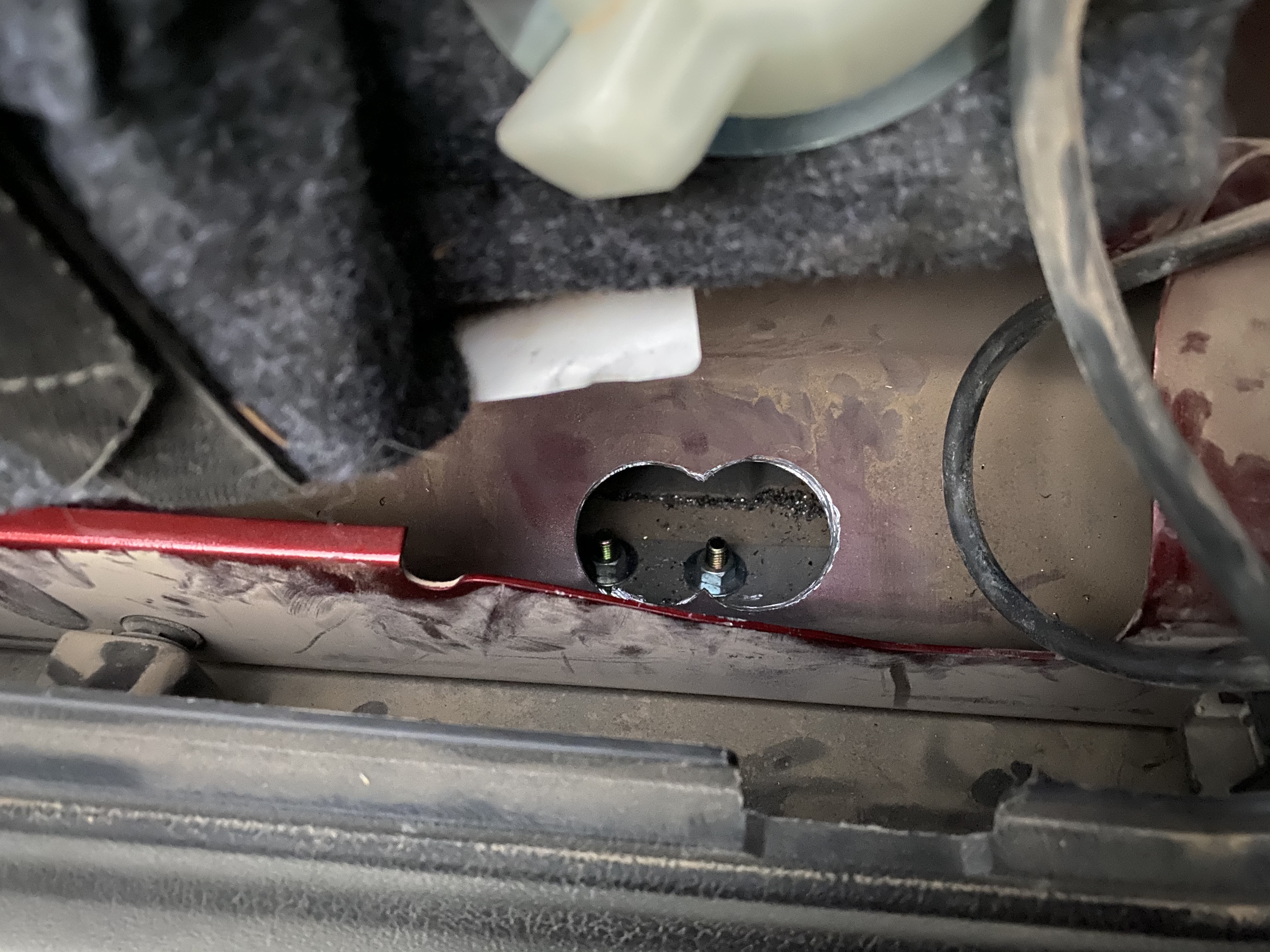

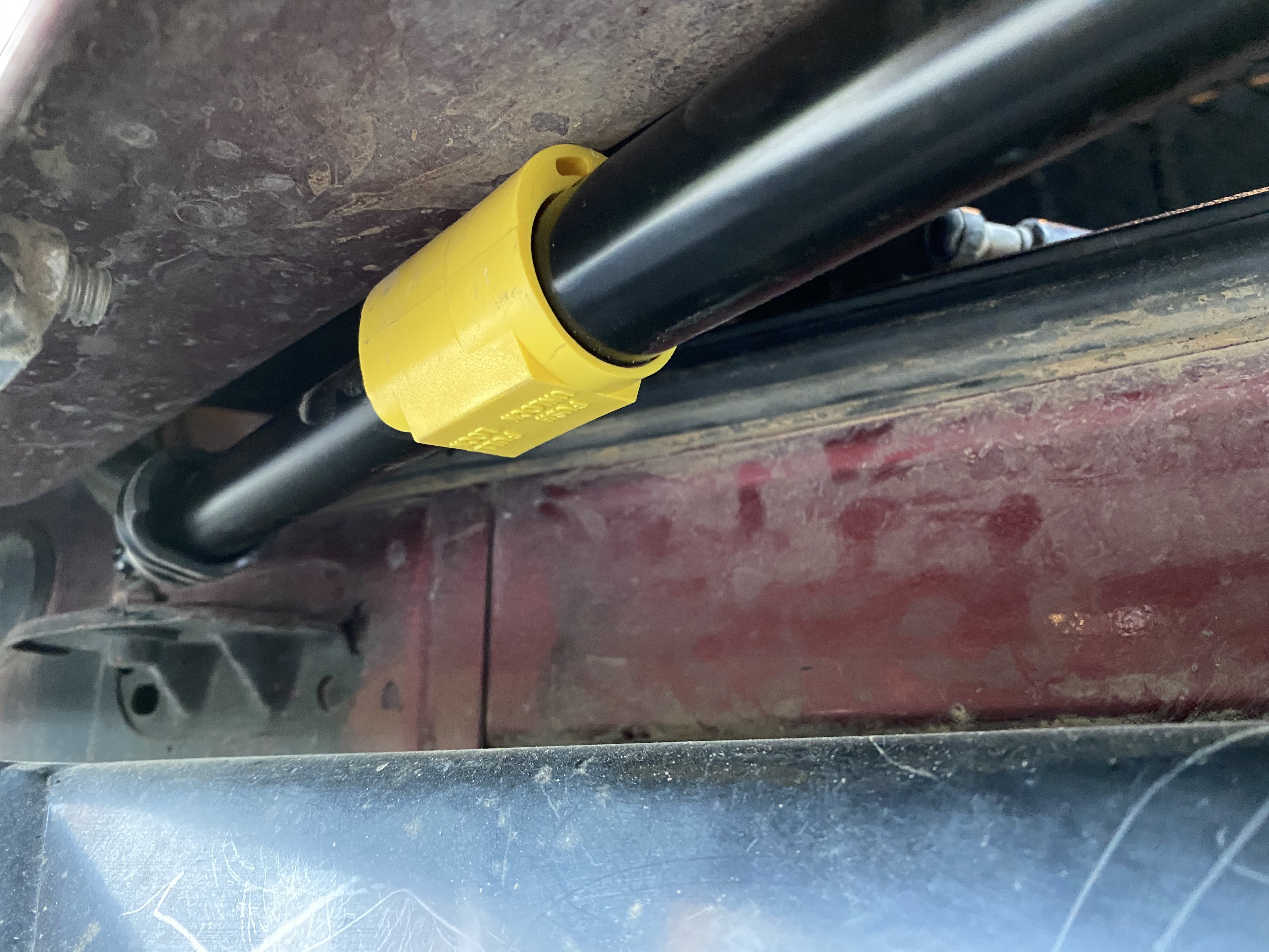

Next thing was modify the rear door strut with a locking strut from a FJCruiser. You need the strut and bracket from a FJCruiser. You will also need attach two bolts rivnuts would be best, but I cut two holes inside the door and attached nuts to tighten7BCB3A45-DCDA-452D-8147-E62CE35E0DD8.jpegD55FF232-87BD-4487-A187-350DE57A3180.jpegCD88C542-2E0D-4735-A821-FB78277D0534.jpeg04DE055C-8293-4A3E-866A-D33A96D23D85.jpeg

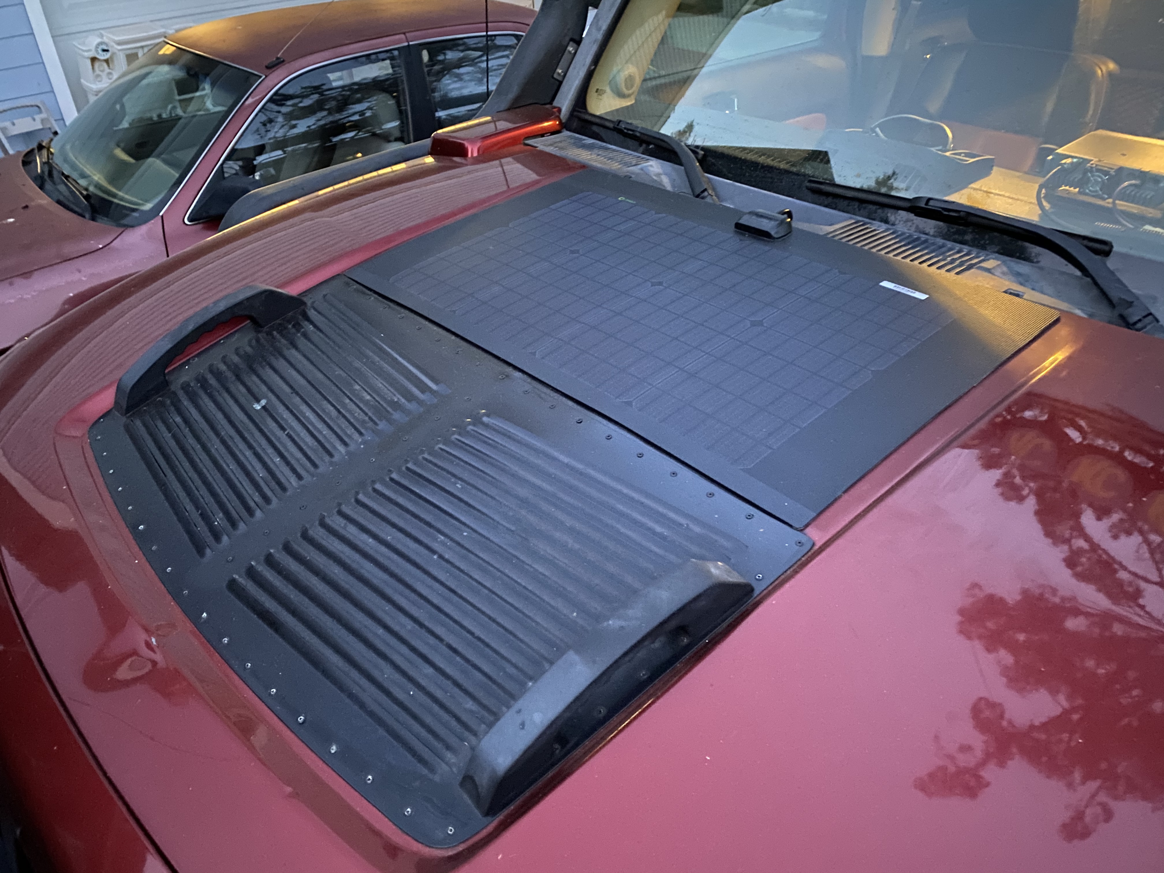

I decided to get a solar panel made for the area of the hood above the runcool hood louvre to keep the batteries topped off since I don’t drive the H3 often other than for camping or wheeling. Lensun Solar made a 45w to fit directly onto the area and included a solar controller also6D3C4206-0423-44C1-8217-E06BD6DC66A4.jpeg7FD175E6-1D91-46E1-BB6A-D7FEBB092E62.jpeg

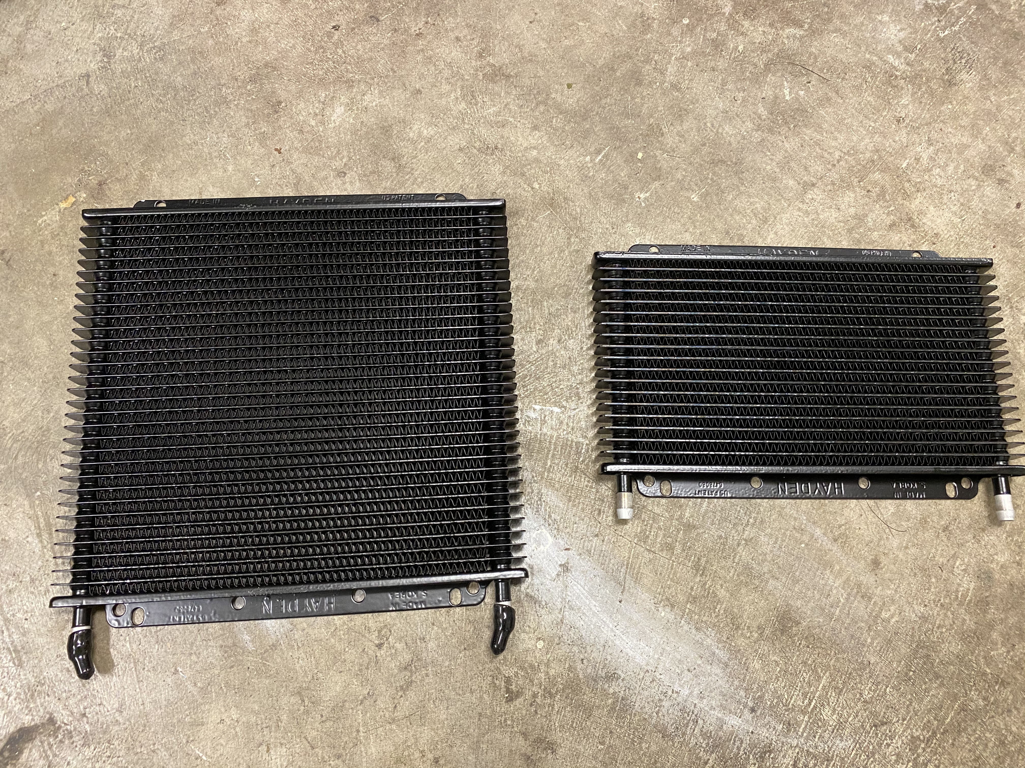

Towing the trailer is hard on the H3 in traffic and up steep grades. To help the transmission I get a Ron Davis Radiator, two external transmission coolers from Amazon and two 10” electric fans. Current average trans temp is 140-160. Highest I’ve seen it get was 188. All according to the scan gauge which I also installed 26D75A97-9572-4895-A564-74E80C1FE0FA.jpeg

There are a few things here and there that I can’t seem to find pics of. Such as the Molle panels on the rear windows and door from MollePlatformSolutions. I don’t have a good
picture of the transcoolers and electric fans. Only

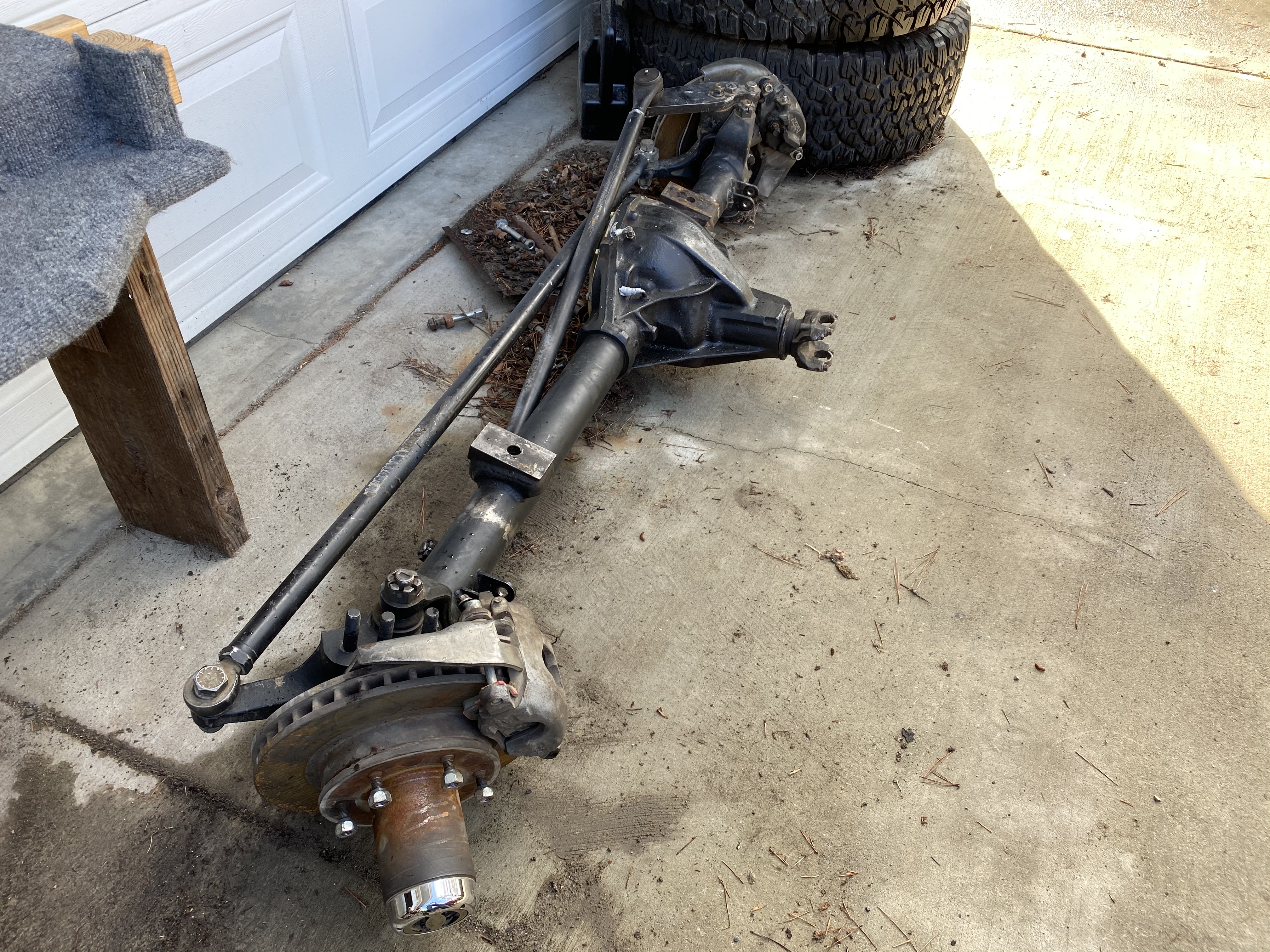

Now for the stuff yall been waiting for. The SAS stuff. It started out with me getting a set of 2007 F350 axles (Dana 60 and Sterling 10.5”). I was going to swap there onto my daily driver 2005 GMC Sierra 1500. But then I acquired the 2001 GMC Sierra 2500hd which was already solid axle swapped. 272C2EA3-10A1-41C1-8696-AAE9F7CAA52E.jpeg

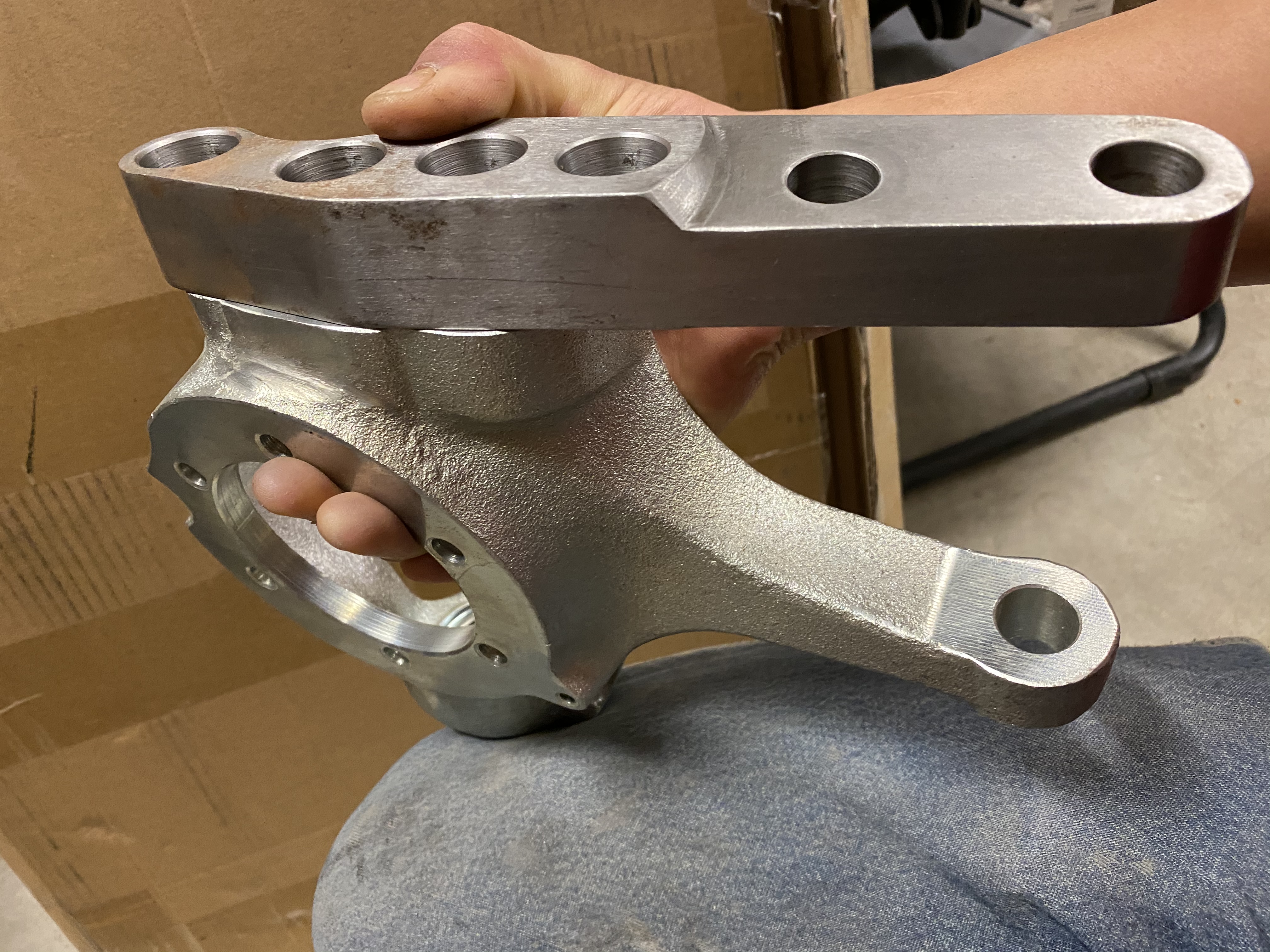

So since I wasn’t swapping the 1/2 ton anymore, I decide to sell the f350 axles. At this time I’ve already decided I was going to SAS the H3. So instead someone offered a trade for a GM 10bolt front axle with chromoly shafts, 4.88 gears and an ARB locker. So that’s what I did. I was already talking with CJ and acquiring parts. New knuckles,
steering arm, diff cover, steering stuff. 85A216F3-1B96-4BB7-B3BF-DAA2926CCA2B.jpegC17A5E18-A105-497E-B775-E3C2DAB3C9BD.jpeg7B021F79-04DD-4ACA-AFA2-CF1DA41345ED.jpeg

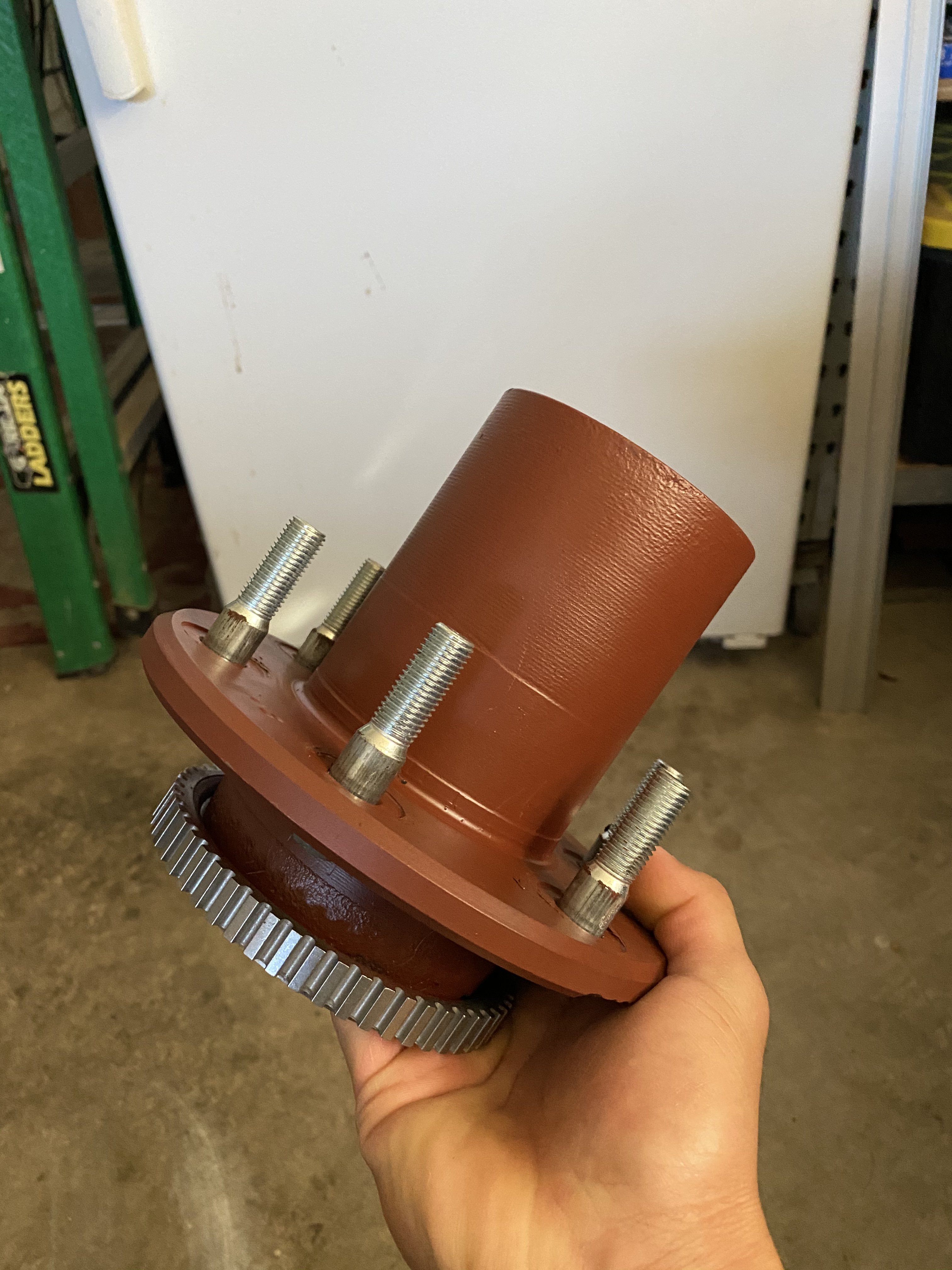

Next I get all different mounts and brackets from Ruffstuff and BallisticFab that CJ recommended. Also got the ABS hubs and other parts from CJ that are necessary for the SAS 8165BBCF-C2B5-4353-A2F9-4A910DCB633D.jpegCF77B4FD-059F-480F-9615-32168B9AE5EE.jpegC466F954-6F66-4B2D-AC1A-84F9D9ED4CDE.jpeg639B9DC7-B0AC-4B7D-9C25-68CB91C0EF6C.jpegDF561D21-AA0F-47D8-A21E-8B43B9F73617.jpeg7CC2FB44-3AD8-444B-943C-07E2F5EBBCC6.jpeg69415C09-BA80-45A8-9C06-B4573C473BC6.jpeg6E9B81A9-93BE-4DBD-85C8-2F99CEAEDCC2.jpeg229BF80F-E5FC-4022-938D-6B375D9DBE23.jpegDCA91093-79BA-4331-B8F2-51EF10E9F152.jpeg
