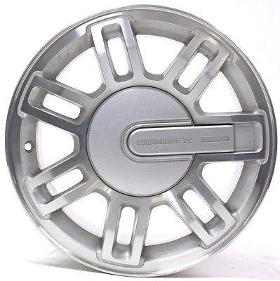

    • Now this is not concrete, but of a H3 has this black stripe on the hubcap it is a good indication that it is a adventure package. **However this does not apply if the factory 16 in wheel comes in chrome. This is not the best indication because it is easy to loose/have your hubcaps stolen
Factory 16" Wheel With Black Stripe. Good indication of adventure package.
Factory 16 Wheel" Most Likely Non ADV

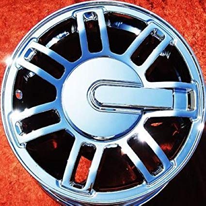

Chrome Factory 16" Wheel. Can either be a ADV or Non ADV

  • Black Stripe On Wheel
This isn't correct. All 2006 with standard "sparkle silver" wheels had the black stripe, it didn't matter if it was Base, Adventure, or Luxury. Chome wheels had solid chrome centers.
For 2007, the standard sparkle silver wheels came with solid centers (no black bars). Chrome wheels became standard on the Adventure package for 2007 (and I believe 2008 as well but not positive about that as that is the only year I never owned). Seems like a marketing screw-up to me, as I would think the Adventure package guys wouldn't necessarily want chrome, while the mall crawler base or Luxury guys would.
Obviously as you point out, this all is subject to change as it is easy to lose the center caps to a degenerate drug addict or a badly placed tree. It is also easy to paint the bars black on the solid silver caps (and makes for a better look in my opinion).
The chrome wheel pictured is interesting; it doesn't have the "HUMMER" on the cap. I have a 2008 Alpha with the Off-Road Package (ZM6) and the Chrome Wheel package (QB8), and the hubcaps still have the HUMMER logo. In fact, that pic above is the first time I've seen a 16" H3 hubcap without the logo.
I believe that chrome cap is an aftermarket version without the Hummer branding. You'll find those on ebay and cheaper. You'll usually see the genuine Hummer caps are more $.
I've got an 06 with chrome wheels and center cap was all solid/chrome, no black stripe. What's funny is i saw others with the black stripe and liked it but thought it was manually painted by everyone, didnt know they were factory lol. I ended up painting mine with a black stripe :).
I don’t think the black striped caps means anything. I remember looking at a row of new H3’s on the lot, and some had them...some didn’t. None where AP models (cause that was what I was looking for). Since then I have seen AP and base models with and without the black stripes. Must have been a trim option or something.

Black caps on hubs did not have a thing to do with the Adventure package or a luxury package with the off-road package. Sunroof was optional on all vehicles.
