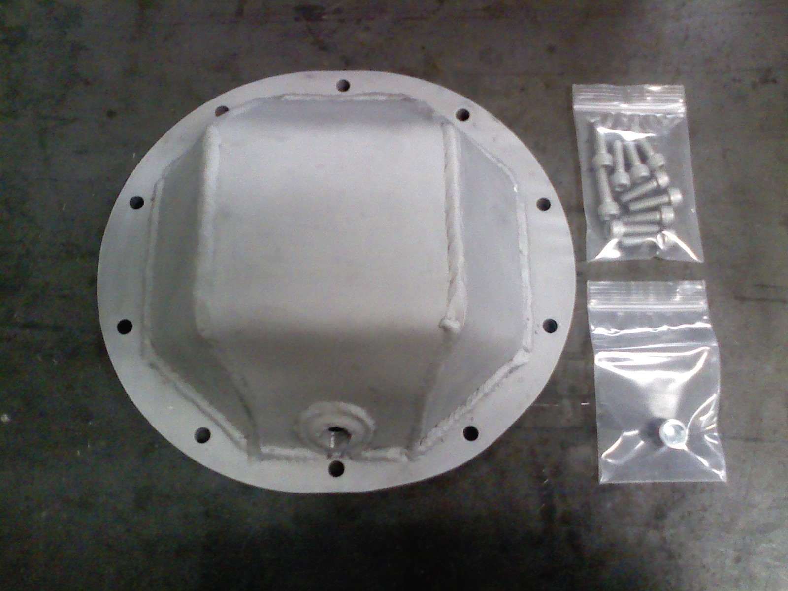

The differences are pretty self explanatory, you answered your own question posting the links in your first post. The diff cover you posted has cooling fins to help cool the gear oil, 0.5 quart over standard capacity for added cooling, etc. The Purple Cranium is a guard and that is all. The pro to the PC is its price. I have a PC and let me tell you they are works of art. Each one is hand fabricated, there are over 50 powdercoating options and different sticker options available. They are also extremely stout. It may look a little wimpy in the pics but to see it in person and how heavy it is definitely is impressive. Here's mine:
