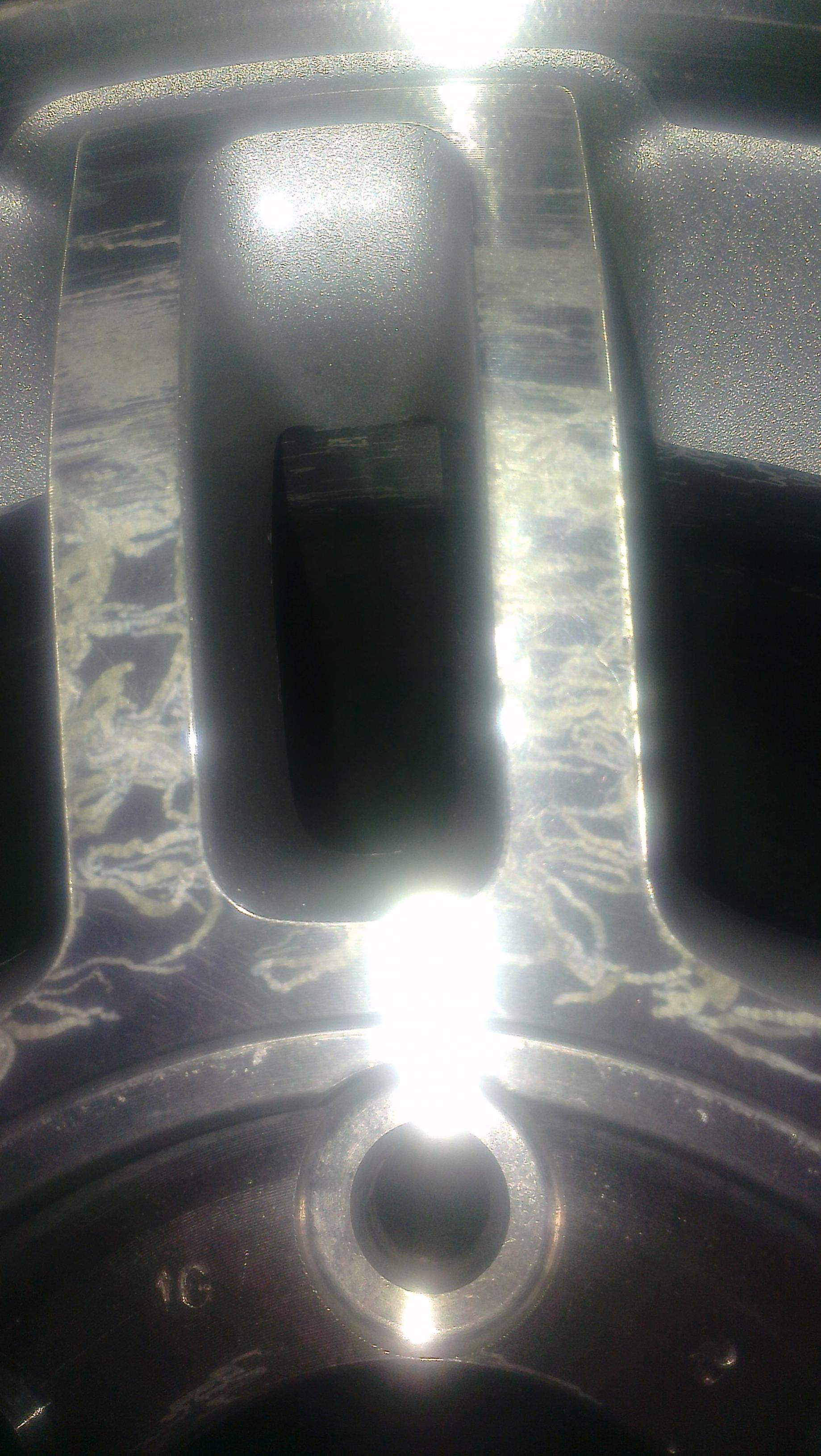

The rims all have these "veins" in em. You can't really feel them running your fingers over them. The duplicolor stuff says to scuff them up with their prep pad. I dunno if I should take some sand paper to the face of these before I do anything to em....
