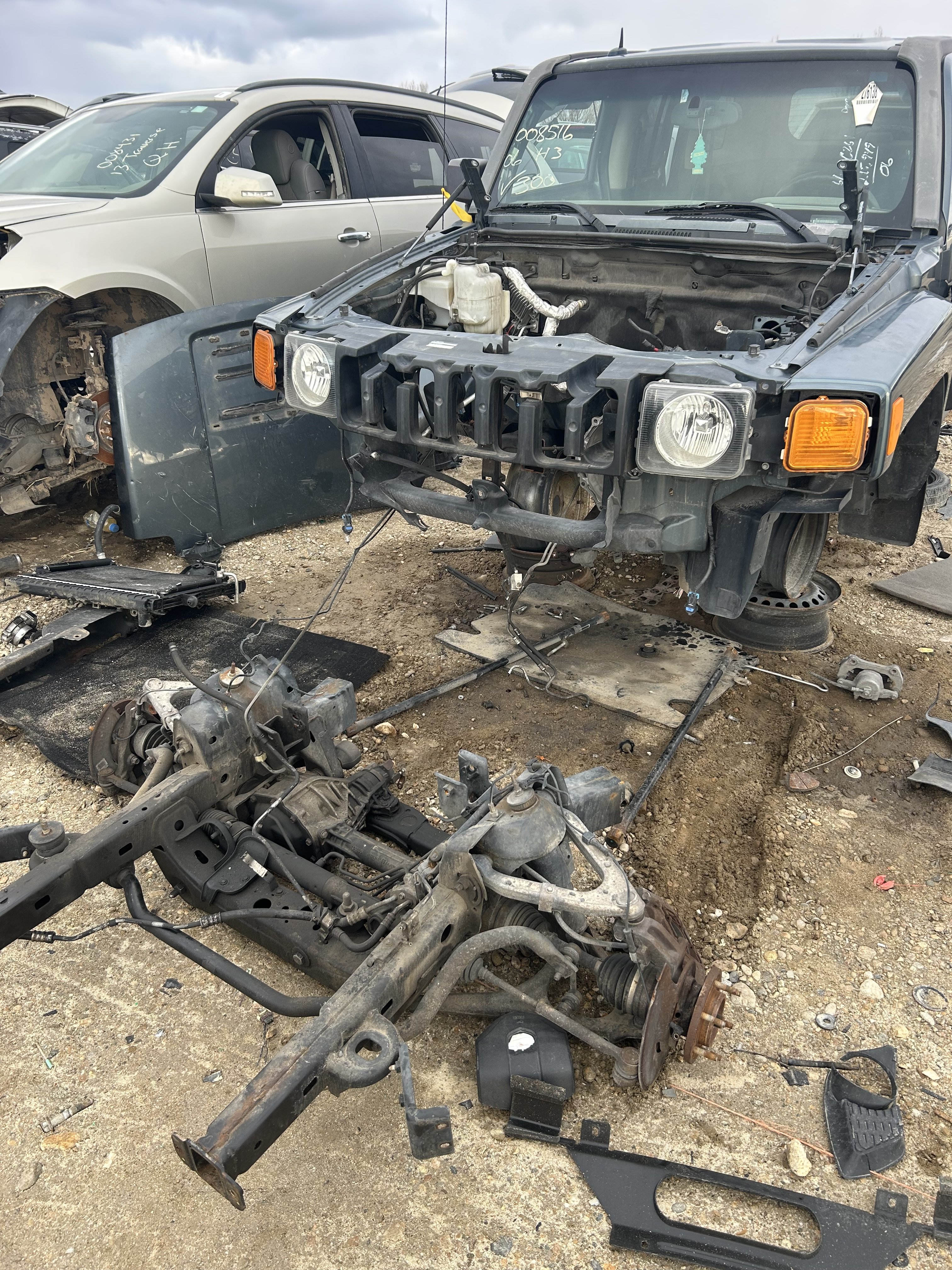

My buddy said the CV boots are torn. The local junkyard has 2 H3s in there now. I’ll go see if they have decent CVs. I don’t want to spend money on some aftermarket crappy ones, I’d rather use some oem ones from the junkyard.

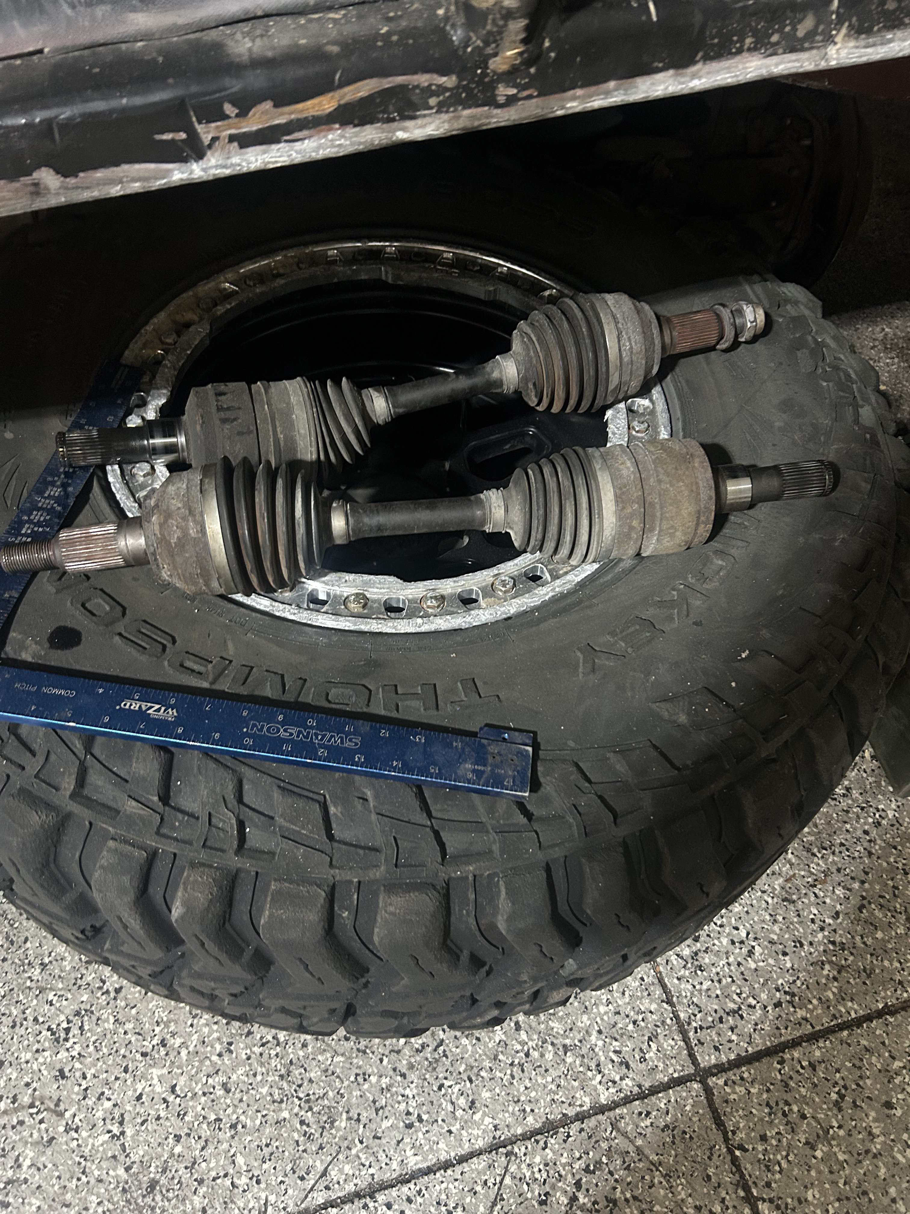

My wife and daughters were all tired last night and so I spent my new years pulling the CVs off the front frame half because the ones in the T have bad boots.
These aren’t oem from what I can tell. I forgot how to tell if they are oem. I think they lack the ridges on the inner part.

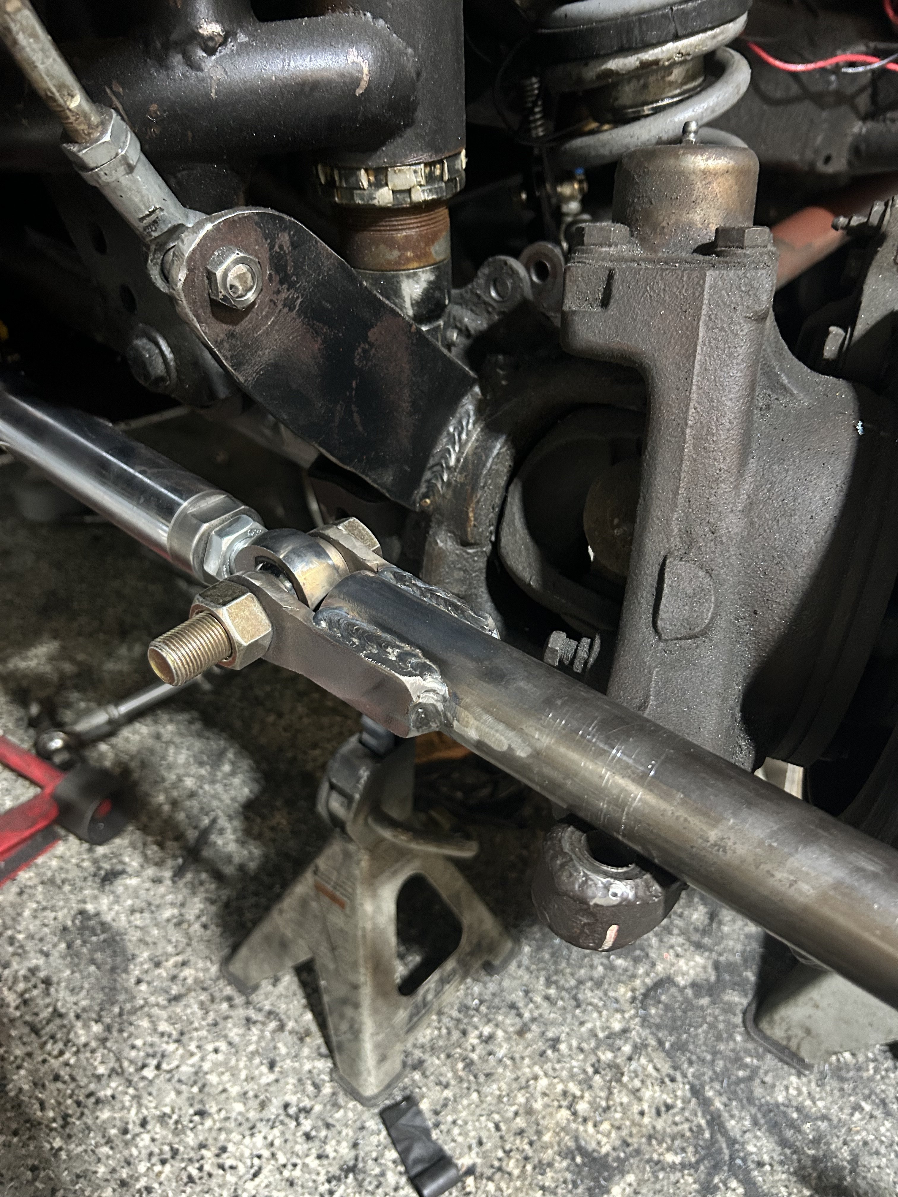

Then bounced back to the H3 for my steering project
I gotta bump the H3 thread on that project.

Yeah, that's not the shape of the axle shafts of OEM CVs.

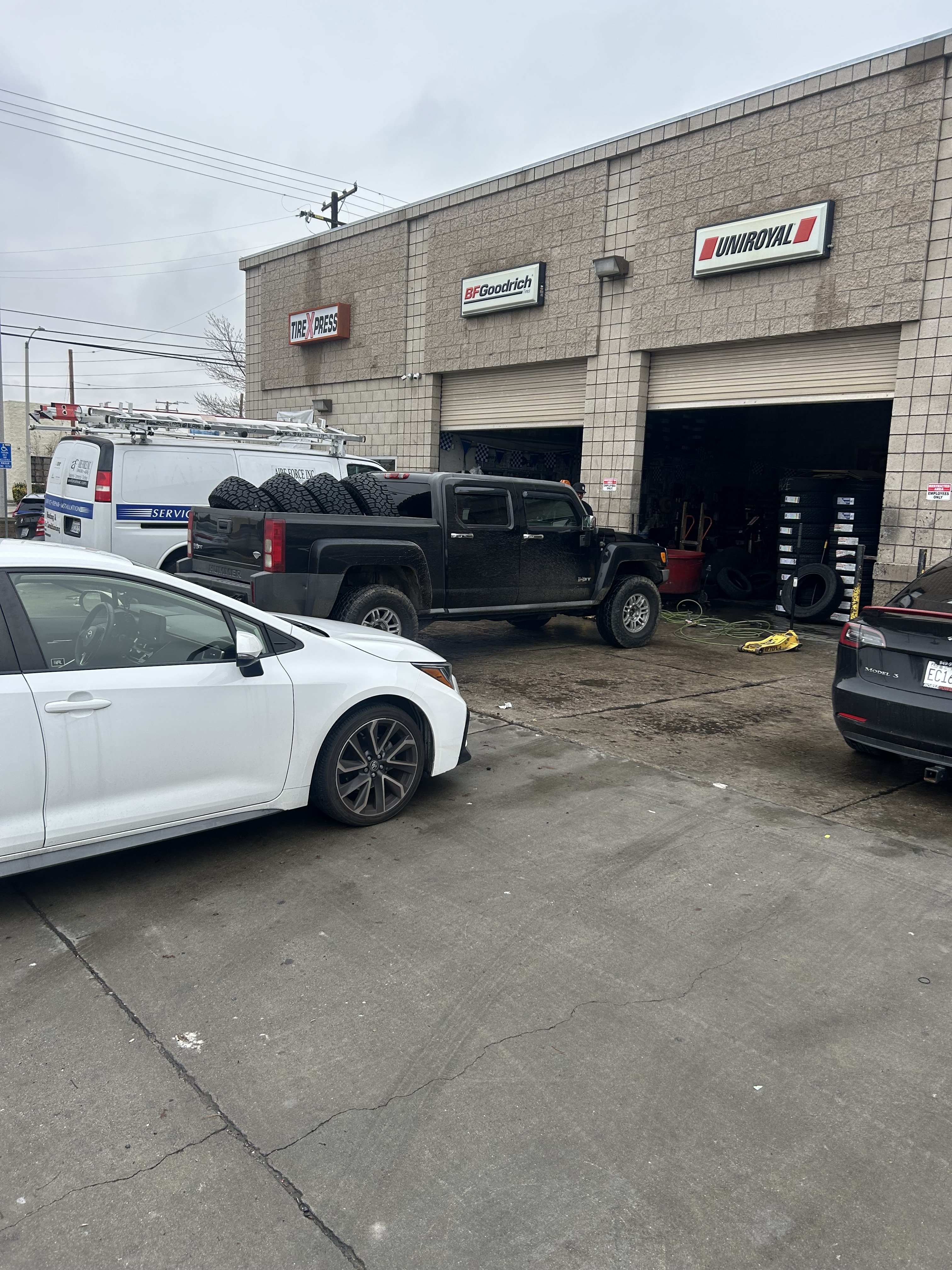

Upper control arms, lower ball joints, CVs, all fluids, t bar crank are done! Off at the tire shop for 35s and an alignment now. Didn’t get the steering rack clamp done yet. I needed to get to the shop. I don’t think I need an alignment after the clamp but who knows…I mean tie rod length isn’t changing and position of the rack shouldn’t be changing.
The CVs were HAMMERED. They literally didn’t have boots on them. :oops:

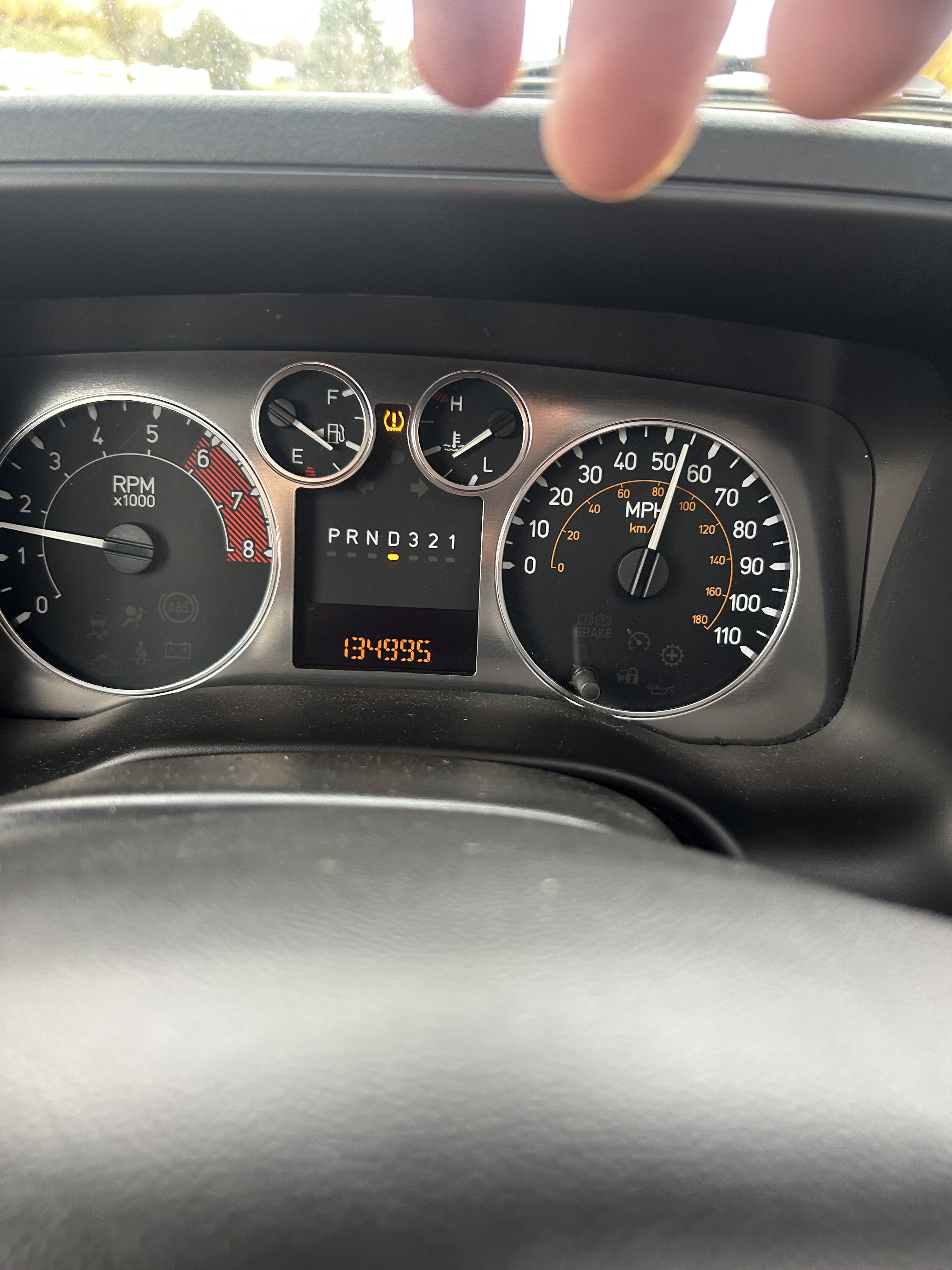

TMPS light was blinking so I’m thinking dead sensor

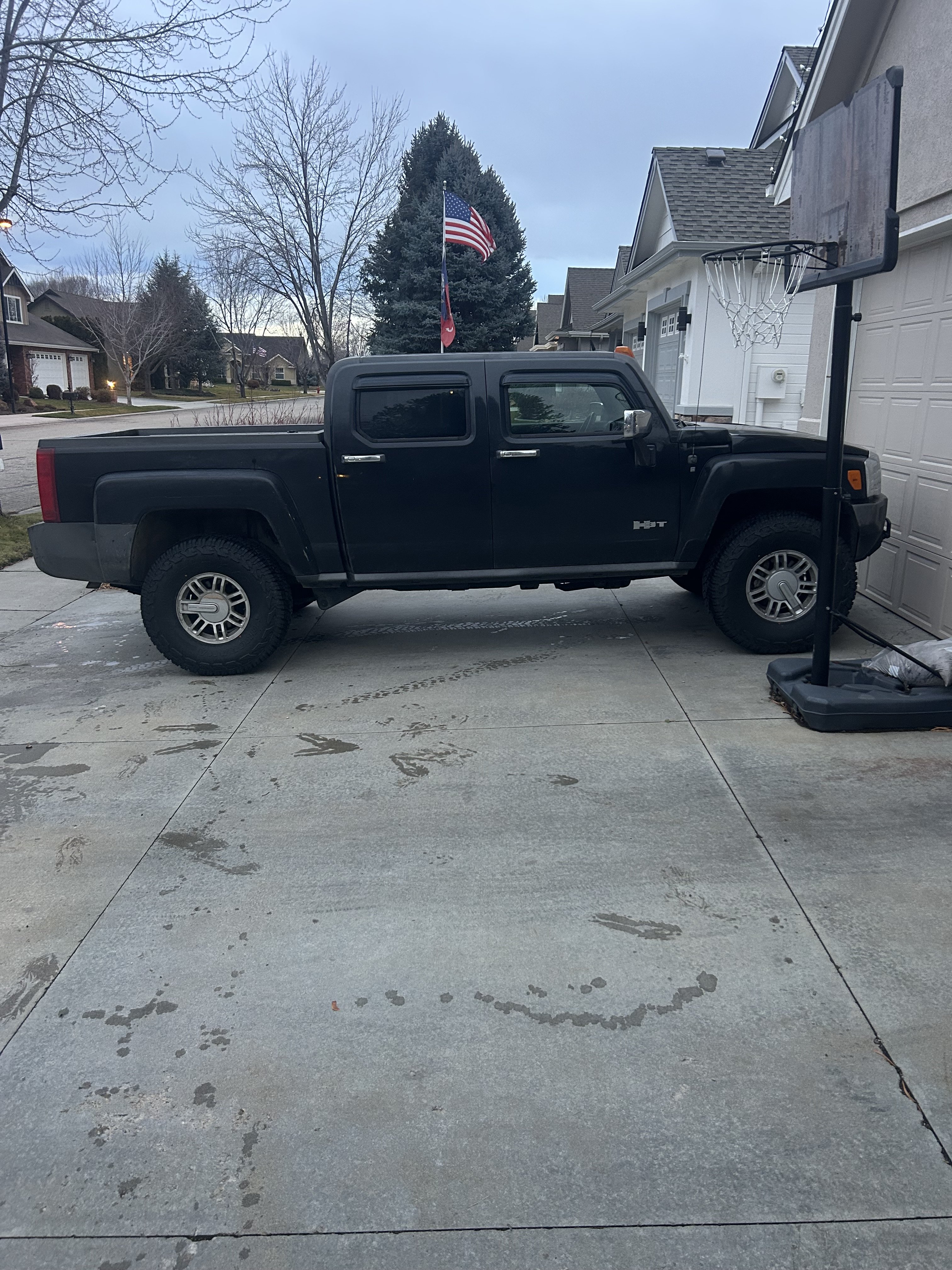

Lastly, driving home on the 395 I got pulled over….I was shocked because I wasn’t speeding. Sure enough the CA tags were expired since 2024. I explained to the cop I just bought it, and the state of Idaho won’t register it till I get it to the DMV in person. Sure enough, he let me go and said he’s going to cite the previous owner LOL!!!!
I hate to sound petty but that’s karma. The guy lied and had brand new tires in the sale ad, but it had 13 year old bald tires (he bought it in 2019) so he put older tires on it. The roof marker lights he claimed to know “nothing” about I found a partially cracked one under the back seat. The ad was a total lie so this guy is getting a citation and probably 2 years of registration costs for something that isn’t even his anymore. Sucks to suck and when he complains and wants me to pay for it I’ll tell him he can buy me OEM marker lights and we will call it good.
Lastly, I didn’t get pulled over for speeding or anything, the cop literally said he noticed I had old tags, so I have very little to do with why I was pulled over

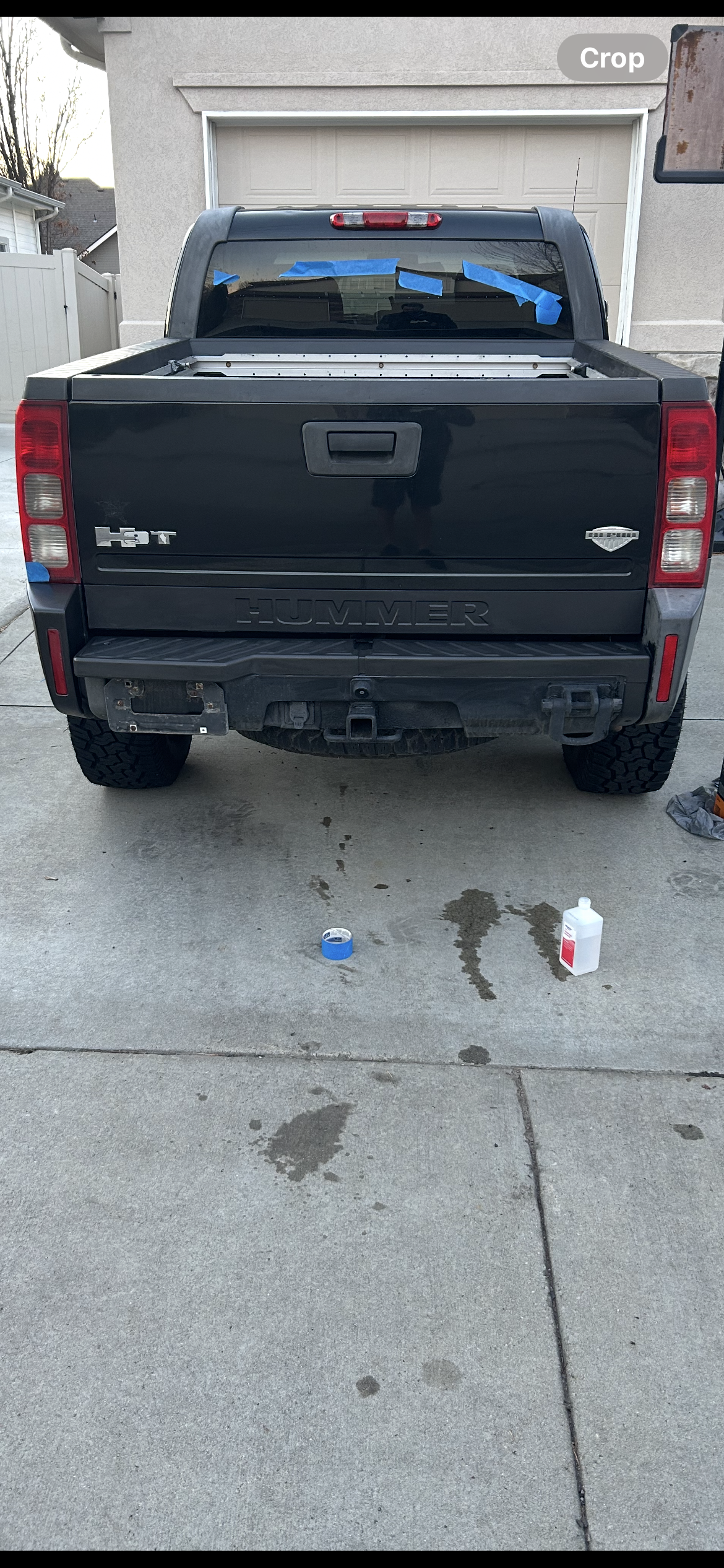

Small boring updates….I finally washed it and clay bar’d it. It looks much better! Still need to wax it but I will wait for some warmer weather before waxing it.
I tried this cerakote trim restorer.
Historically I used the thick black dye applicators but on project farm (the best, most thorough and fair tests on the internet in my opinion) had this product clean house compared to everything else. It’s weird because it’s just a wipe that has zero dye, so you question how it will do but you can see what it restored compared to the right side of the bumper. Project farm does long term testing and said it held up for well over a year and still didn’t need a reapplication.
The tape on the back window kept my daughter busy while I taped off the sections to wipe down.
The backup camera was garbage because the P.O. had overspray from painting the rear bumper all over the camera so some rubbing alcohol fixed that.

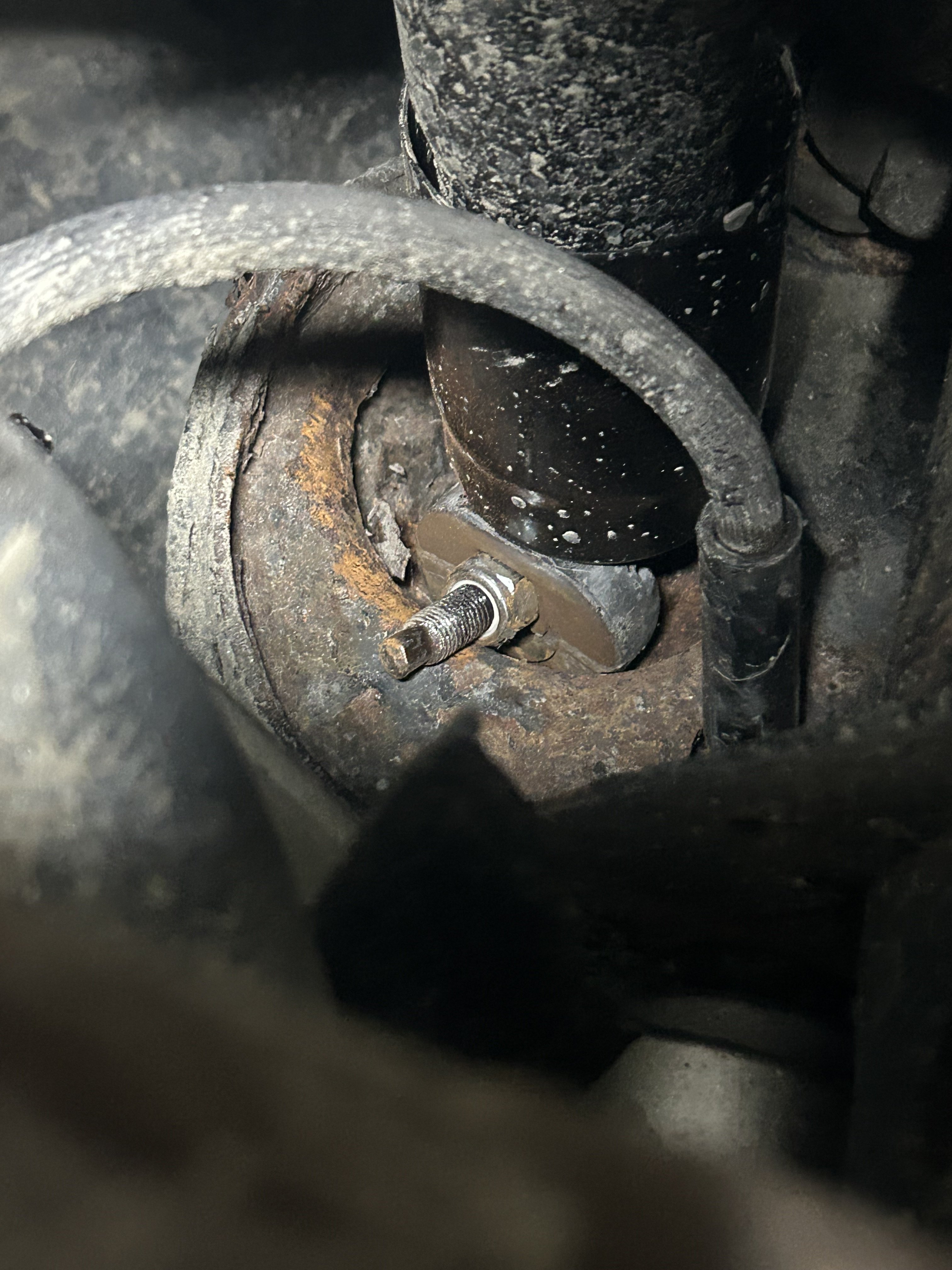

I also got my bilsteins installed. Here is a video on my findings.
@EndeavoredH3 said his bilsteins pre rancho lift would hit the metal droop stop. Looking back, there is give in the bushing and since it’s a little over 1/2in short, I could see the slop in the top shock stud bushings getting you to full droop, the weight of the front end can probably deform those bushings at full droop. I also feel there is not nearly enough rebound control. I have some ideas for better, revolvable shocks. That’s why I think these things hop on steep climbs.
Either way, this is an exercise I want to practice, maximizing every possible inch of travel is important. I did that on the rancho kit back in the day and I have part #s under the “rancho redux shock” thread.
I need to change a leaf spring bushing that’s literally 100% gone and then I’ll take it offroad for the first time.
