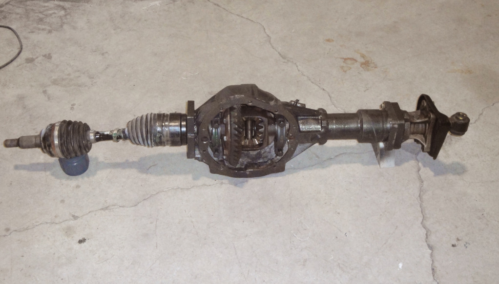

ARRRGGH!...Today was a one of those revelation days. The revelation was that Blackbear's axle might actually be a "jack-a-lope". I say this because I have found out that there is no flippin way a stock H3 half-shaft can even reach the carrier as shown in this photo...
True...this is an H3 half-shaft. True...this is a 10-bolt housing. That's where the truth ends. The end of the CV is plugged into the housing...but it ain't plugged into the carrier! The male shaft on the end of the CV is only 4" long. Its AT LEAST 5.5" from the seal to the carrier....so one of three things is going on here. (1) He has found an inboard CV joint with a longer shaft. (2) He has installed a coupler and an extension between the shaft and the carrier. (3) He is bull$hitting us.
All is not lost on this. I still got a couple tricks up my sleeve, and I might be able to pull a rabbit out...but, its going to take some more head-scratching. I have brought this project back to my home shop for a more detailed analysis. I have a couple ideas how to salvage this but none of them are very compact, and I'm getting concerned with oil-pan clearance. More on this later.
Do you think you can do it with a stub shaft and 1500 axle? (I think you can).
Edit: with a drivers side drop.

That sounds like a very good idea but may push the diff into the oil pan. Not including the H3 inboard stub shaft, the 1500 shaft is longer, right?
Bebe - the more I dig into the front end of my truck, the more I realize why you went as far as you did with yours. I first took it apart to fix the steering rack issue. Then I got a domino effect of crap that I want to completely re-engineer after I realized how it's made and attached to the truck. Assuming you want to actually go off-road, there's some real mickey mouse stuff going on in the front of an H3. Small front diff, UCA's, diff bushings, rack bushings, ugh... The CV shafts and wheel bearings might be the best thing on the front of the truck. I killed the pass. rack bushing in 11K miles on my T (amongst other things). My never-off-road H3 Alpha still had the factory alignment at 85K miles when I traded it in.
Edit - How would you retain the stub shaft? With a regular c-clip like a factory axle?

Well - thanks, but we had to for how I used the truck. Trust me - there were three sets of eyes/brains staring at that thing and discussing every possibility imaginable.
If you are going to use the stub shaft method - I would use a set 20 bearing and retainer, which I did. (Made by Dutchman)
If you are keeping the H3 shaft, you have to keep the c-clip. There is an option we abandoned, and I think Rick is going to post it up here shortly.
Regarding the oil pan - the diff has to be mounted lower to accommodate it like I mentioned a ways back in this thread. I had to do it and 4digger had to do it.
I'm not overly concerned with the diff height, (ie: Rancho). Flanges and aftermarket/custom half-shafts are out...that's the whole point of using the 10-bolt. From the start...the idea was to locate the passenger-side CV-seal, exactly in the same spot as it is on the AAM-7 and it must receive the stock half-shaft. Every project has a set of criteria that must be met, and this is an absolute requirement. Anything other than this solution is not acceptable. Its either this or the dumpster. I simply won't waste any more time, money, or effort to build an IFS outside of this box...especially with the 10-bolt. The idea is to make a bolt-in, Saturday afternoon housing and nothing more. Bebe...your IFS is awesome. I'm tickled with my SA rig. But, this build is for the guy that has a $1000 budget, and no resources for custom work.
The main issue now is: how to put a coupling on the passenger side. It needs to be a real short coupling...shorter than the one on the drivers-side of the AAM-7 but similar in design...28 to 28. This will definitely shift the pumpkin further inboard but, I'm not sure how far. Any splined coupling, needs 1.5" of contact area at the splines. So, to mate two shafts end-to-end...the minimum length of a coupling is 3". That's the MINIMUM, and it doesn't take into account any clips, retaining rings, bearings, seals, blah blah. So it becomes real obvious that the housing has to grow outward to the passenger side. As stated above...the seal must stay in the same relative spot on the vehicle. So the pumpkin needs to shift further inboard. There's no way around it. That's not the end of the world...especially with the Rancho. The question is (for all you Rancho guys), how much room do we got? And (for me) how tight can I make the coupling?
I'm not gonna kill myself to make this work but, I find problems like this very challenging. I won't give up until I know for sure there's no way in hell it will work. I'm only half-way to hell right now...so, I'm gonna sleep on it. As usual, throw your ideas out there if you got any. There are great minds at work on this forum, and I welcome any input.

I'm puttin a fork in it. I'm convinced that you could throw stupid amounts of resources at this and get it done. But, the 8.5" 10-bolt axle has a very low-value as a candidate, so the point at which you give-up...happens much earlier in the build. It's one and only advantage is that it shares the same splines, and in theory...it could accept stock half-shafts. So in order to justify using it...you must seize that single advantage. However, I have found that dimensionally...it just won't work. The nose on the stock H3 half-shaft is a full 1-1/2" too short. To add a coupler would take additional room that just isn't available. Not to mention...you would then have couplers on each end of the thing, plus two custom stub shafts. That whole plan is moving in the wrong direction. So...its dumpster time.
So where does that leave this? Well, Bebe has some great ideas (with good reason). She's been down this road and found many of the same issues. Its very hard to come up with a cheap, simple version of her build...a "Bebe Light" if you will. Like she said in a previous post..."we had to build it like this for how I used the truck". This is very well put, and it explains the snowballing that she got into with her build. To do it right and achieve all of the lofty goals she set on the onset...she had to solve all of the problems along the way, with very little compromise. The result is awesome... a long-travel, custom A-arm, Coil-over, custom rack, hell-rig! Its the rig everyone wants...but few can acquire.
But, what if you compromised a tad? Could you do something similar and keep the stock travel, A-arms, torsion-bars, and steering? Something more than Digger's but, less than Bebe's? THAT is the rig everyone is interested in. One thing for sure is the
goals must be defined ahead of time and adhered to. You're gonna have to be okay with non-greasable A-arms, a stock rack, and torsion-bar suspension. These are big-ticket items that will start the snow-balling, so you gotta catch the problems early in the build and be willing to compromise. Its no secret that all of these stock components, well...suck. But you have to draw the line somewhere if you're on a limited budget and have limited time. Compromise. Thats the real question you gotta ask.
