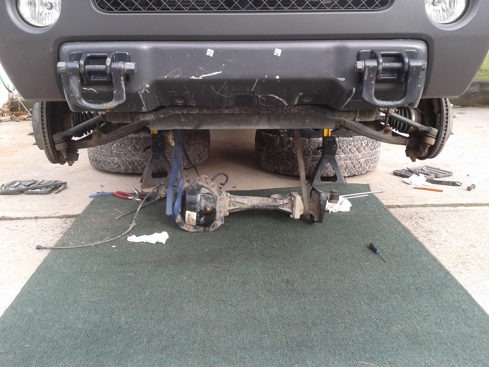

Schwarttzy
1,390
Rockford IL
@5gn-h3t
Is that photo telling me that I can drop the front axle without removing the front drive shafts... because that would be freaking sweat!
5gn-h3t
616
Northeast Pennsyltucky
Schwarttzy - Pop the cv's free of the diff, pop the upper ball joints loose (unbolt the ABS wire), cock the spindles out, drop the diff.
Edit - There's a driveshaft, cross-member, and UCP in there somewhere too. Lol.
