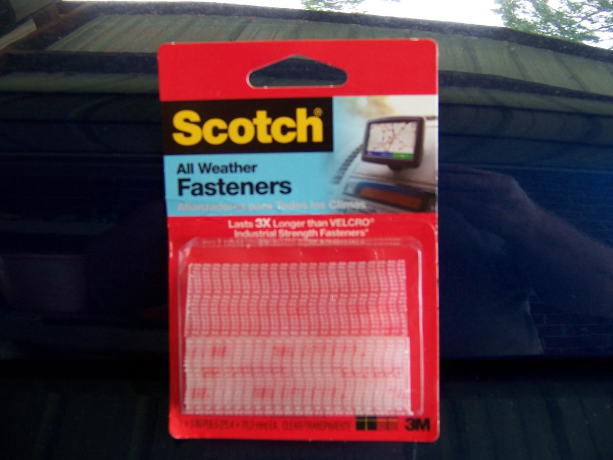

Check your exterior "A" pillar trims, the clips were broken on mine and did the same. I'll get back with the brand of fastener I used to repair
MSC
75
Montgomery, TX
This what I used to attach my trim, remove broken tabs, clean trim and "A" pillars, cut small pieces and stick where tabs were on the trim and tab clips are on "A" pillars, that will hold them better than factory. I purchased from Walmart near home paint dept., pick up extra you will use it for other things.
