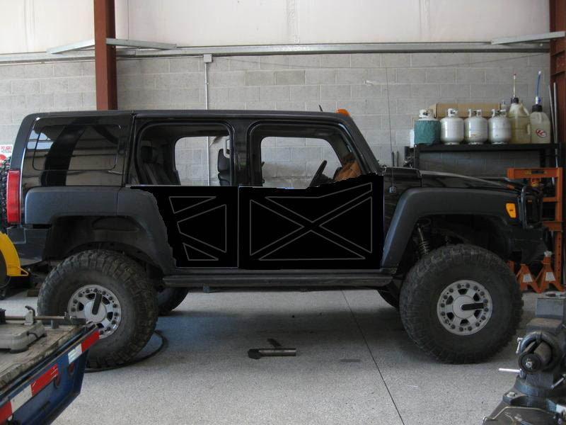

Here's a very quick mod of your pic so you get an idea. Even though I think you already have pretty good idea. :)

I really like it! Got my gears turning !
I like bigger pics :)
