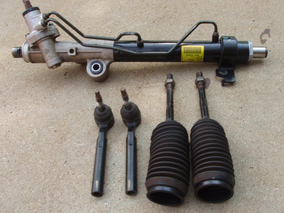

FYI:
Mark looked at the pic, said he'd help me out.
He asked me to send him $100 & he's sending me a new rack. So basically 75% off the new rack after shipping, and now I've got brand new spare boots, tie rods, etc.
So nice dealing with honorable people.
SO, what else would make sense to pull off of this thing? I was thinking tie rods & boots... anything else that is likely to fail?

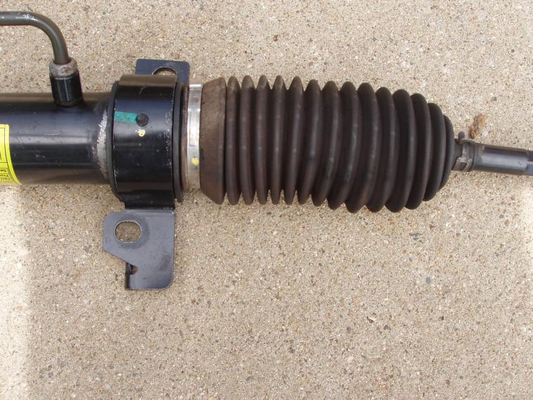

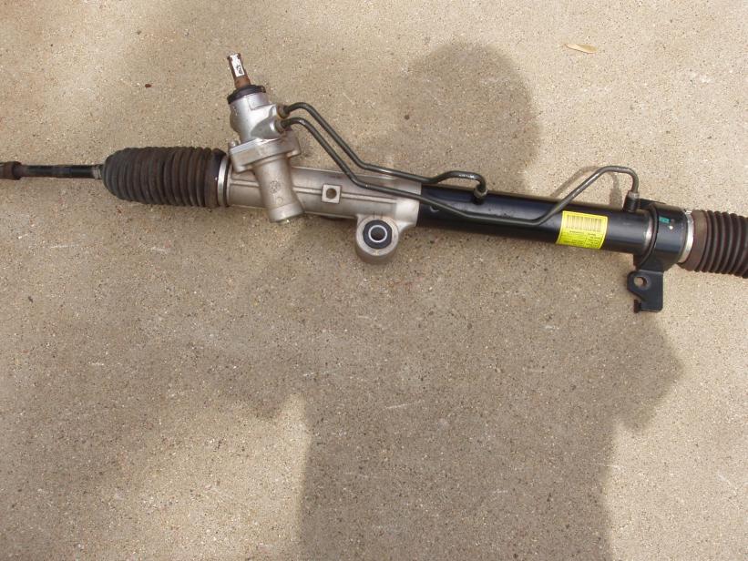

Ok I broke it down. The first three pictures are the way i got it back from the dealer after they installed the new one. The rest are after I broke it down. There are no cracks or fractures on any of the case or on the tubing that I can see. there is no evidence of any leaking. There was steering fluid in the passenger side boot when I removed it. Is the silver end removeable ? It looks like it may be, but I don't have a big enough wrench (yet). There has to be a seal or o-ring that keeps the fluid from coming out.
Well maybe being not broken there is a chance if you remove the end we can see what the seal looks like. Maybe a replacement can be found.
I can see evidence of the rack wallowing around in the rubber bushing on the pass side. It has worn the paint off the rack with the movement. To me that means the seal has taken abuse from being moved around. Here is the part I cannot be certain of. If you make the rack more secure so it will hopefully not break will the seal then take more of the movement. Which is worse, a leak or broken rack?
I think either one is affected more when we turn up the torsions increasing the angle of the tie rods, like I often say that causes more up and and down forces rather than just lateral in and out forces and running larger tires. Those of us doing that have exceeded the expectations and original design parameters and pay accordingly.
If I had not just invested in several other projects I would buy a pallet of those racks from Canada.
I still continue to look at options or something more robust for the setup I have.
The end looks like about 2 inches, my digital mic is dead but it could be metric. Maybe Harbor Freight has a big ole "wranch"! cheap
I sort of hate to disturb the seal on my extra one. You have a good shot at informing us all.
