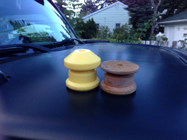

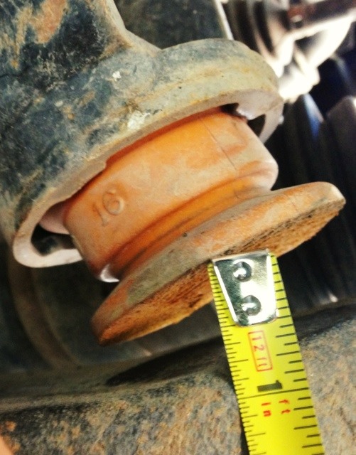

Got new OEM springs on order as the previous owner/dealer thought they would cut the bumpstop for some reason... (More "up Travel"???)
Anyway the part # is 15783030 if anyone is looking for it and GM calls it a "spring"... and if you are trying o find it on the parts diagram it is in the Frame/chassis section! not suspention like I first thought!
Here is what my current "spring" looks like:
Can't wait to stop the front end dive when braking! (plus this will really help once the winch get put up front!)
The "springs" are in now and feel WAY better then before! Two main areas I feel the difference:
1- while braking, no more nose dive, much more energy going to slowing the T down

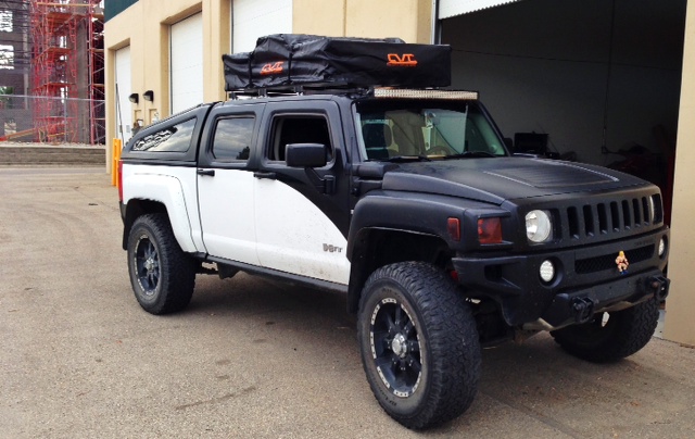

purchased a RTT this morning! I can't wait to pick it up and install it!
Here is the unit I went with:
Tonight I am going to fabricate some roof rails for the tent to attach to above the cab... thought about mounting it on the SnugTop but thought it would be awkward to get things stored under the top if the tent is set up and in use (no to mention the added weight in the rear plus the 140lbs on the hatch which I am sure the gas struts can't hold)
I'll post pictures of what I come up with later. Any hints from anyone on how you would build it?
I was told to have a minimum of 2 cross bars, but more realistically I should have four.

Nice! Can't wait to hear how you like the RTT. I've been looking at them for a bit but can't throw the money at one right now. You've got the extra power but I think it would add a lot of drag for my 5 cylinder.
I'm thinking of just building a platform for my 2 person tent until I spring for a real RTT.
One of my concerns would be the stock roof rails. They just look to be very flimsy to me. There's not much you can do about them unless you replace them and bolt something stronger to the roof. I would just keep an eye on them every so often to make sure them can take the lateral motion of moving around the tent.

I just about bought a ARB RTT w/extra room last month but then backed out because Im not sure how well it will fit on my rig , due to its gonna be pretty high up . When you have yours all installed if its not to much trouble i wouldnt mind taken a look at it all set up . Those things arent cheap lol , so just want to make sure one will work on my truck before i spend the money .
For sure! I won't mind showing it off if it works well haha!
I plan to put it onto a trailer one day but for now I just finished welding up some cross bars to put it above the cab and se how she is!
I'll post up a full review once I have tried it out on our 7 day road trip down to the US next week!!

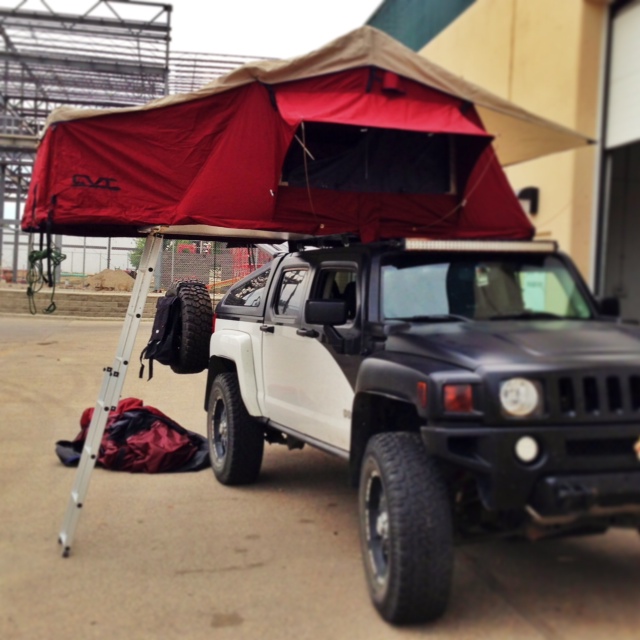

So I decided to finally bite the bullet and buy a RTT!
Pick it up on Aug 25th and slept in it until September 2nd on it inaugural road trip through Alberta, Montana, NW Wyoming & British Columbia.
Here are some pic's
All packed up:
Setup after approx 2 min:

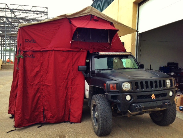

After 40 seconds of zipping the change room in (allow for another 30 seconds to zip the floor in if needed and 30 more seconds if pegging is required)

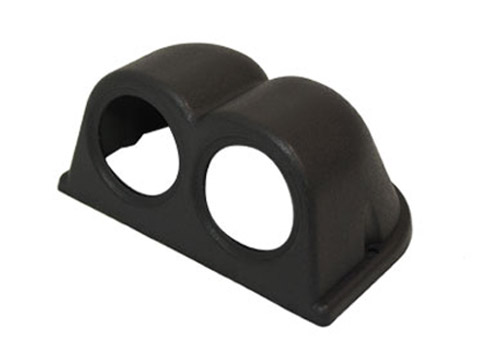

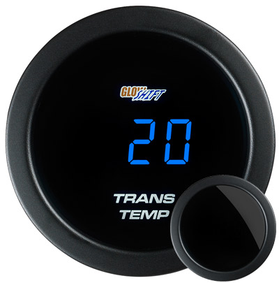

I did however order a universal dual gauge pod, trans temp gauge and a boost gauge.
I want to make sure that my trans temps are staying within reason and I also want to be able to keep and eye on boost pressure (mainly for when I am towing)
They all look like this:
Once I get it all back I think I am going to try and squeeze it into the small open space above the review mirror on the roof (glue a block of wood to the roof under the headliner and then screw the gauge pod into that)
