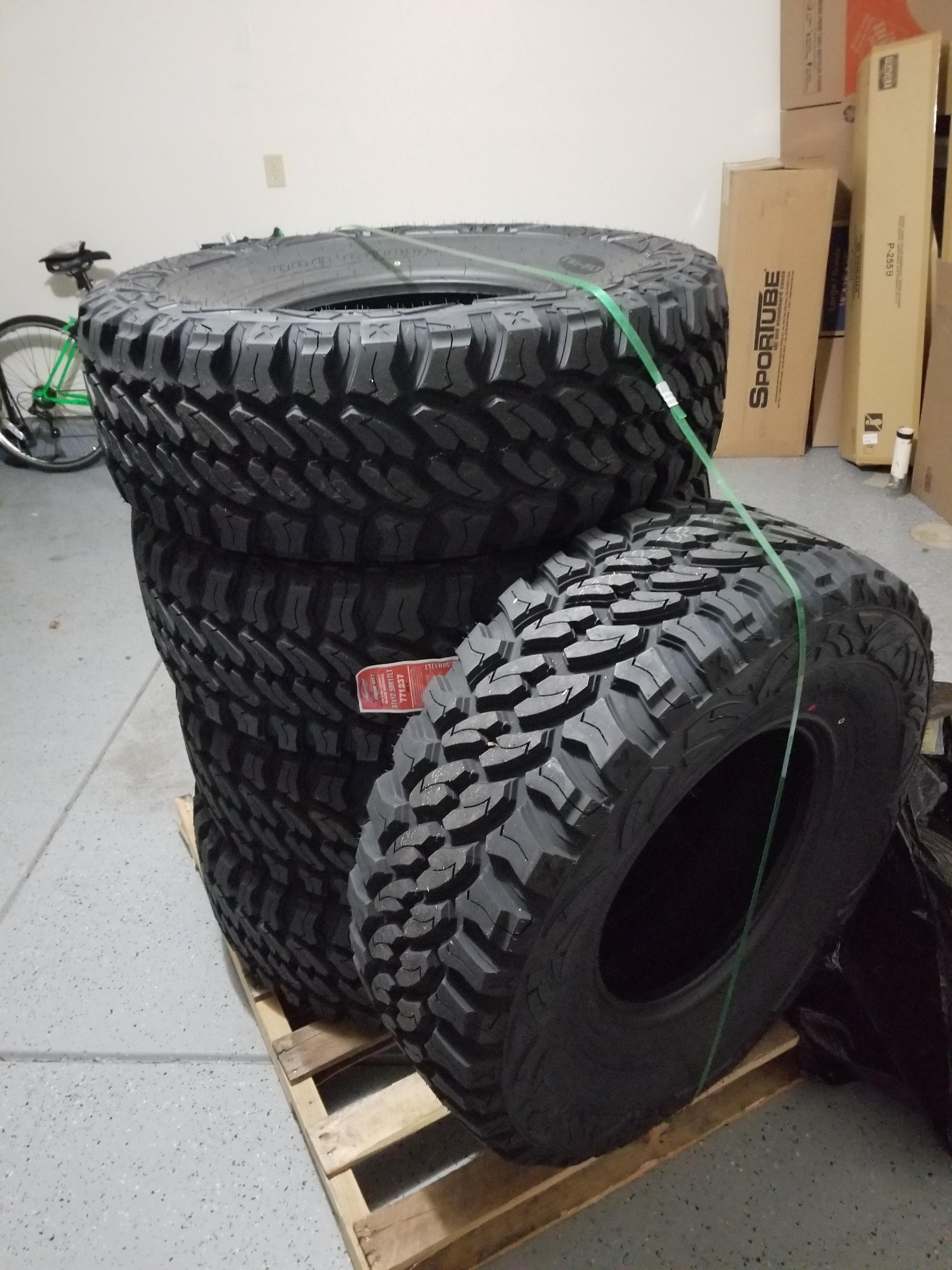

New tires have arrived (thanks for the hook up Mutaint) Pro-comp extreme MT2 in 37x12.5x17
Currently waiting on wheels, which are back ordered 60-70 days. I had received shipment of 4 of them, however 3 of the 4 were damaged so I am sending them back and waiting for them to come back in stock.
I am going with these, Mamba M14.
