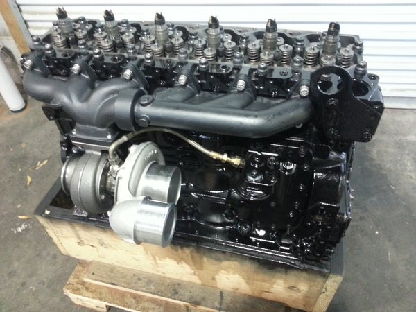

After running into too many issues to count with the 6.5l trying to meet 2027 emissions standards I have decided to move to a Cummins power plant. I did not want to have to do this because there is a lot of re engineering of the motor mounts, exhaust location, cross members and placement of accessories. I am also finding that to create an exhaust system capable of meeting the 2027 emissions standards it will cost the same as the motor. For example: Custom Selective Catalytic Reduction for my 5.9l Cummins is $2768.40 on its own... I really hate the idea of always having to use an additive just to drive your vehicle but then again you do always put gas in.
Here is another thing to keep in mind: The first version of this engine put out 509hp and would have given an estimated average fuel economy of 24 mpg mainly due to the light weight but then after adding the emission reduction equipment the power output went down to 437hp and now with an estimated average fuel economy of 19 mpg. So what is worse? Less pollution but burn more fuel? Now to get back up to the performance figures I originally spec'd for this build the engine builder had to go up to a larger dual stage turbo 611hp setup. The nice part is this engine comes with a 10 year 100k warranty! Hows that for a high performance vehicle warranty.
