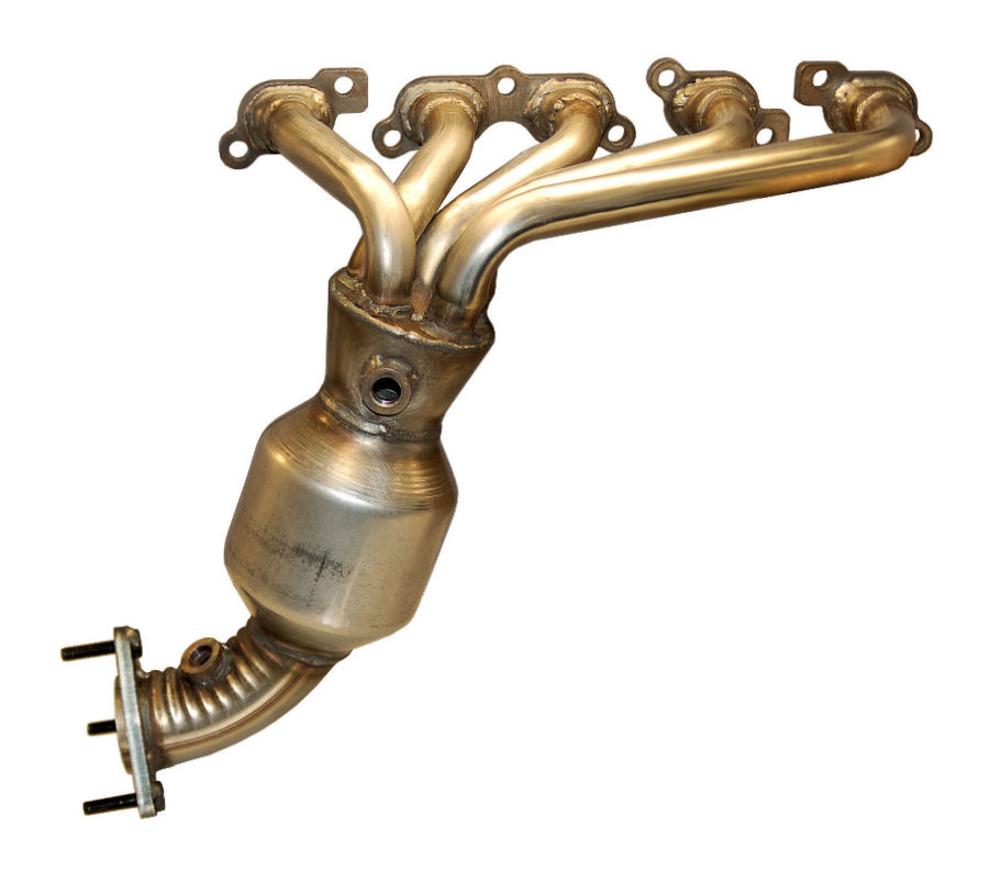

Pulled off the heat shield today. Manifold is worse that I thought.

and once you take it off i promise you find more cracks on the inside!! I had one in the same spot as yours, but once i took it off there was two more internally!!

So I got a couple questions....
1. Did you guys with the cracked stocker notice anything while driving?...or did you just visually see the crack?
2. Does a header like this actually "flunk" an emissions test? Seems like it would perform better.
10,668
Mine's cracked above the cat, maybe 1/3 to 1/2 way around. Physically torn, so it's a bit different than many of the other cracked headers. When I start the truck up I get the smell of unburned fuel that would normally go down the exhaust and out the back, at least until the cats heat up. Ironically, my exhaust seems a bit quieter now, perhaps as less air is getting pushed through it.
Last emissions test was 20 months ago before the header failed so I can't speak to passing the test but I don't think it would be an issue.
1) Yes. I had an audible exhaust leak along with a squeeky-rattling sound. I have had issue with the flange below the cat leaking from hitting rocks over the years so I assumed it was that until I pulled the heat shield off. Also had a visually apparent black mark on the back side of the shield from the leak.
2) Not known yet. I have flunk smog tests in the past from exhaust leaks.

Hey guys I am about to undertake this project this week with an after market ottp header. My purpose was primarily for performance upgrade. I removed the heat sheild the other day to soak the bolts for the next week with pb blaster to ease them getting out. Anyway I noticed that the head on bolt no 1 (closest to the grill) was snapped off. There is about 3/4" of thread still sticking out of the head hopefully it will still come out with an extractor set. The second thing I noticed was I had a crack in the exact same spot as cbetts, in fact I would swear he took a pic of my manifold. So it looks like the header replacement is a necesity at this point. I have looked for 3 weeks now to get the exhaust bolts, no one has them. Everyone has a stud set. Is there any difference with the two or did GM do away with the bolts in place of studs? Also any suggestions on removing that no 1 bolt shaft??
