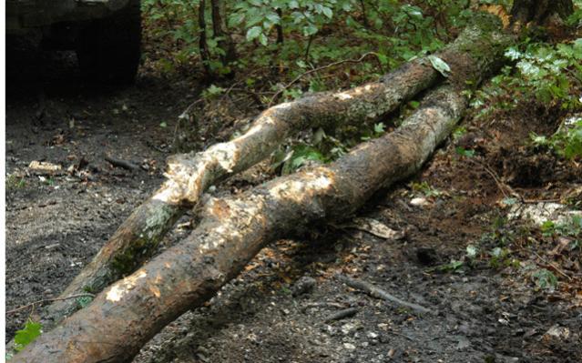

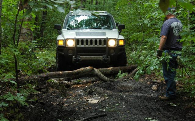

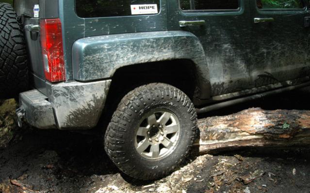

If a person was to only install one locker initially - is there any advantage to having it be the front locker? Is it better to pull or push? http://www.ebay.com/itm/HUmmer-H3-f...=250767645809&ps=63&clkid=5002288854798214694 This link has a complete front diff with locker. 2 grand with shipping. Any problem leaving the rear open untill more funds came avalable? In other words - by installing the front first, one gets both the 4.1 cast iron case and the locker?
My only need for a locker has been over downed trees - twice. Each time required a strap. The H3's with lockers made it over without being strapped (the 1's didn't seem to even notice). In this situation, if one were to have only one locker, would there be any advantage to it being in the front?
