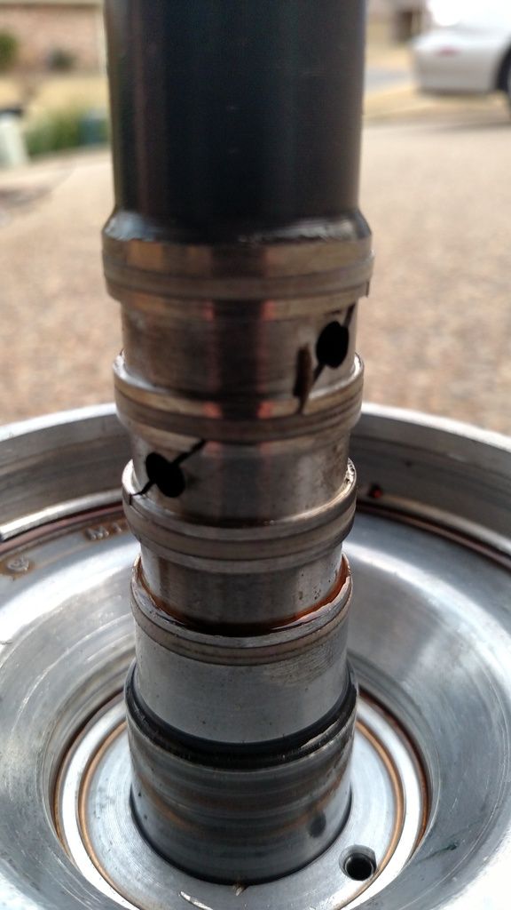

No, I picked up a standard replacement shaft, replaced the drum while I was at it and replaced all the frictions and steels while I had it open. This version has 35k miles since it was last opened up. The input shaft failure caused the overrun frictions to weld themselves to the steels. I had no reverse when I limped it home. Luckily a) I was only 2 miles from home when it happened and b) I didn't pull forward into any spot I wouldn't have been able to back out of.
