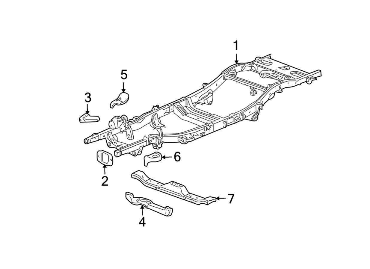

It has been determined that my '08 H3 Alpha adventure is in need of a new frame (rusted out). There are not many alpha frames on the market. I see there are far more i5 frames on the market, can I just use one of those?

My guess is that the only changes would be in the front motor mount area, but not sure. I do know that the firewall in the Alphas was pushed back a bit for the V8 to fit, but not sure if that also translated into any changes on the frame.

Looking at the GM parts listings, there were 5 different frames for the Hummer H3,
#19256809 - 2006-2007 3.5 & 3.7
#19210038 - 2008 3.7 - all
#19210039 - 2008 - 2010 Alpha
#25841058 - 2009 - 2010 Alpha
#25841059 - 2009 - 2010 - 3.7 all
The replaceable frame components fit all the frames, so the differences must be in the motor mount support locations and possibly the transmission cross member mounting location. It is interesting that they list two updated frame part #'s for 2009 - 2010, 1 for Alpha, and 1 for the I-5, and yet Pt#19210039 is good for all Alpha's 2008 - 2010.
Most likely there is something unique about the 2009-2010 frames that support the H3T version.

Yea, there's a frame from an '06 that's nearby and priced well, so I'm hoping I can make it work without too much trouble. Thanks guys!!

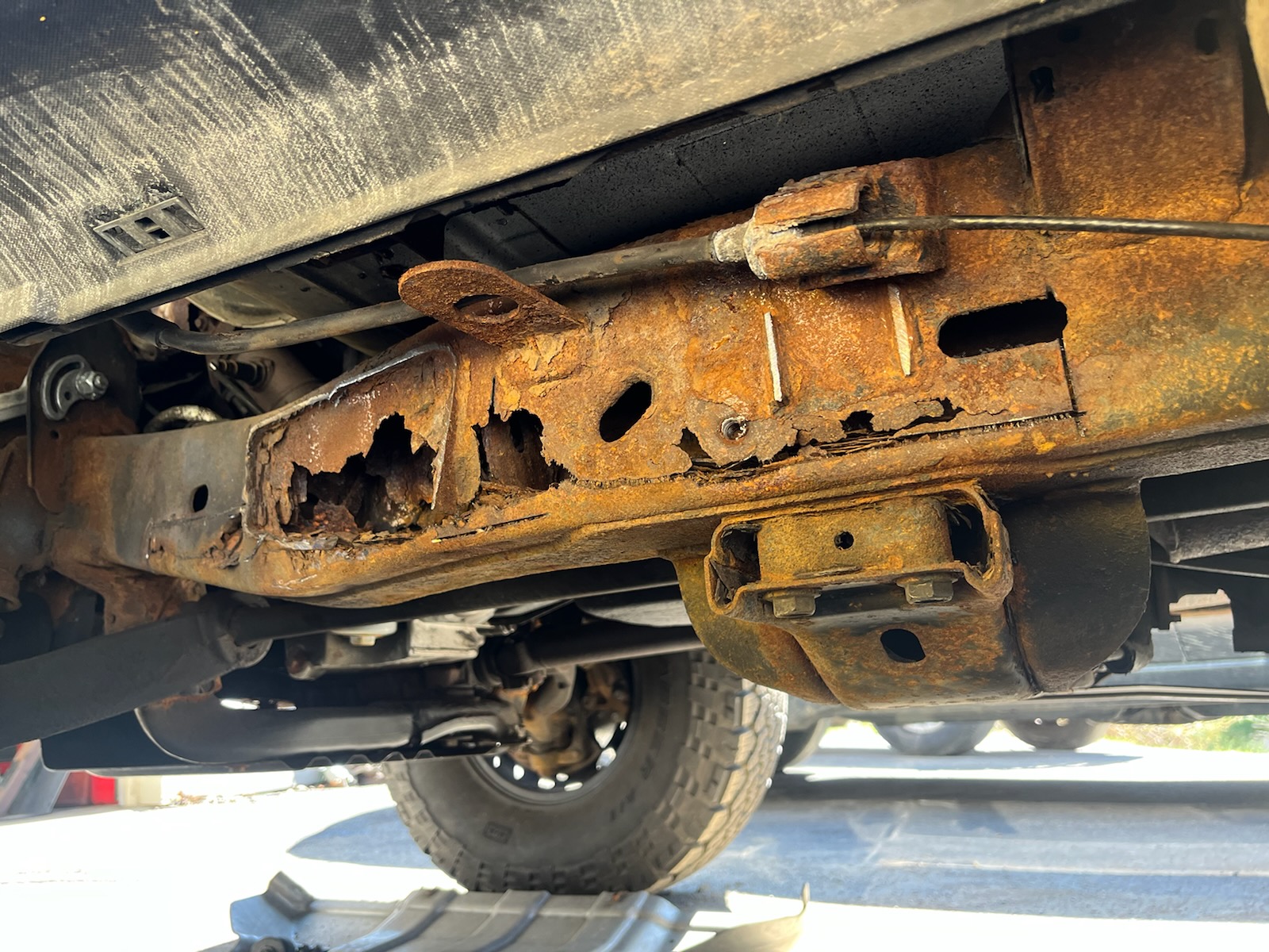

After reading these posts I see I'm not the only one with significant frame rust. I'm taking mine to a welder to have the repairs done but we're looking for the front left body mount bracket since that rusted out also. Does anyone know where I can get replacement body mount brackets?
Your welder should be able to fabricate a perch for the body mount. Pretty straight forward .
I purchased a body mount bracket from Summit Racing for $100. Here's a picture of the rot behind the old bracket.

Sbc350's comment "Your welder should be able to fabricate a perch for the body mount. Pretty straight forward." is a good assessment. However, you must have something to actually weld-to! My experience with patching H3 frames is that you just keep blowing holes thru rotten metal every time you try to weld-on a patch. You end up going further up the frame to find solid metal that can accept a weld, and sometimes you simply run out of real estate. All the rotten frames I have seen, seem to be consistently rotten. That is...they are rotten everywhere.
