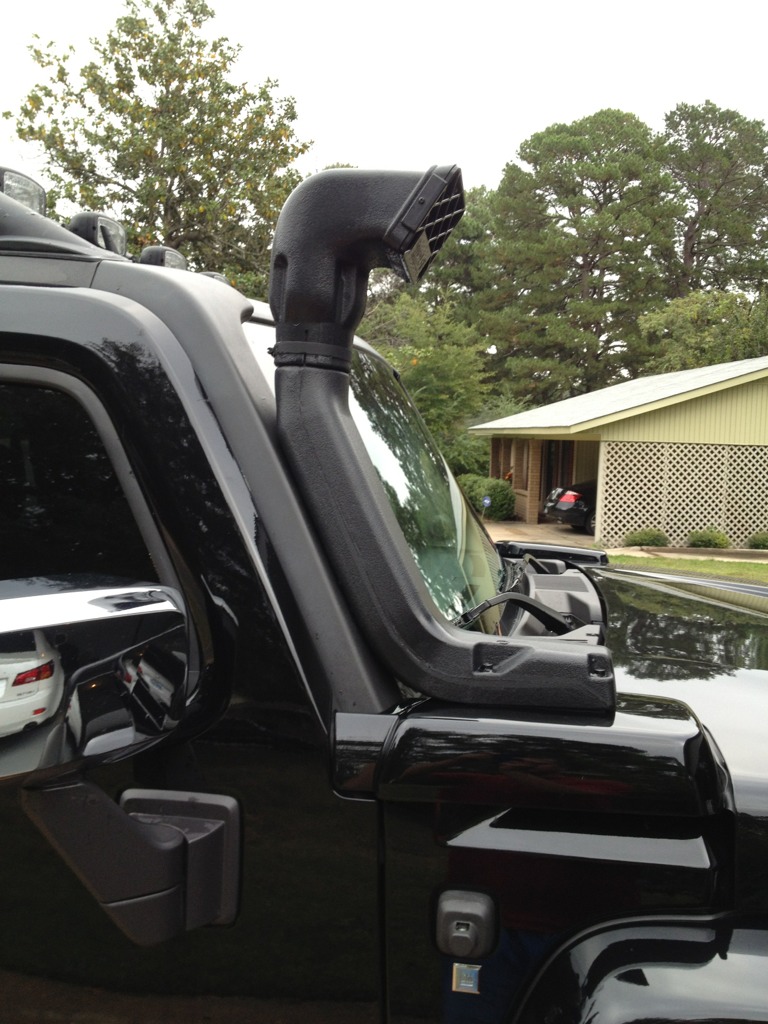

unlessed I missed it. how are you sealing up the stock "intake box thingy"? There are so many ways water can get into that area since its just held on bu push clips. I must be missing something. You gotta be sealing that thing up some how.
It's a secret!!! Lol
TAPDH3T
1,510
Texarkana, Texas
The top section comes with a rubber seal but I used silicon to assist!! The actual cover I cut just big enough to slide my 3" pipe in and used the silicone to seal!!! Worked really well!!
Once u have it in place u tighten the clamp to your rubber 45 underneath the fender.. (that's the hardest part)
I never considered the snorkel a solution for underwater operation just for accidental temporary submersion while moving thru some water. Stopping would be a bad thing but could happen. Fuse box is my first concern.
The OEM filter box is fairly good. It's not sealed and could use a gasket.
Another old school prevention is to place a tarp across the grill so water coming in is not sprayed around by the fan as easily.
Some people seem to have luck with just the stock setup! Not me, no way on purpose. Notice that I am the one behind the camera.
These are fun to bring up when the discussion renews.
TAPDH3T
1,510
Texarkana, Texas
Silicone can be used on the box because if u ever have to break the seal u just scrap it off and redu it.. Some people use water resistant greece like vasoline to repel water!!
