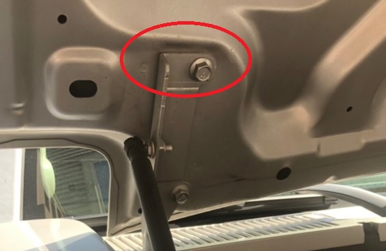

Hinge / under the hood pictures
Passenger:
Driver side:
Full front:
Sent from my iPhone using Tapatalk Pro

That strut is tweaked on the pass side. Probably from someone shutting the hood with something left under it, happens alot, the pass hinge looks a bit off.

Bent.jpgYou can tell from this area on the passenger side that it was shut with something under the hood. You can try to carefully push past the stop when opening to get rid of some of the damage. You may have to remove the strut on the passenger side to do so and you'll want to make sure not to push into the cowl trim at the hinge when you do this. If you're not comfortable doing this, a good body shop shouldn't charge much to do it for you.

You've got some bent parts and tweaked sheet metal. I don't think that can be adjusted without doing some sheet metal repair. I'm wondering if that right rear corner of the hood is kind of curled up since there's some obvious bending at the hood hinge underneath. That looks like some shoddy body shop work. Looks to me like some pulling and straightening and possible hammer and dolly work especially where the strut attaches at the fender lip.
You know what I think happened is the passenger hood strut locked up and someone tried forcibly closing the hood to unstick it and it didn't work.
I had replaced my struts with some cheapo's once and had one of them totally locked up on me after a short while. Nothing I could do to it would get it to even remotely compress.
If the strut had locked up and someone tried to force the hood closed it easily would have caused the damage seen here. The hinge is stronger than the sheetmetal so the sheetmetal would have bent first, and the ball joint down at the fender would have also been pushed forward.
Fixing the fender is easy, the hood is another matter. You could try doing the opposite of what caused the damage by opening the hood farther than it want to like Korby mentioned, but that might not end well. You may just want to take it to a body shop to see if the can pop it back into place. Probably wouldn't cost very much and it'd be quick work. Maybe just glue some pull tabs on and pull it back out, or they might have this one tool I saw once that they'd stick in through an existing hole and massage out dimples from behind. It was a long rod with a bend on the end that they'd rotate back and forth to push the metal back out.
Either way it doesn't need to be pretty since it's all hidden anyway.

Before you do any sheet metal work, I'd try removing the front hinge bolt, and install a couple washers under it, where it's pushed in. Try to raise it up to stock height. By doing that, it should lower the rear of the hinge ...where the pivot is (it's like a lever). I don't know if it'll give you enough 'lowering' effect to make up for your gap, but it might. The rear of the hinge where it bolts to the body may have an up/down adjustment too. Or, the holes could be elongated to increase travel if necessary.
If not, you can 'try' to pull out the hood area where the hinge mounts (as suggested by others). The bent in region. That's beyond the capabilities of most people. It wouldn't hurt to get a paintless dent guy to put his eyes on it and see what he thinks. Generally they 'pry' and there's not much to pry onto. But worth a call though just to see.But
At a body shop, if I were working on it, and had the hood off, laying upside down on padded saw horses, I'd grind the paint away (around the bent hinge mount area), tack weld on a couple metal plates and using pry bars gently lift the area back up to stock height (to match the other side). Then remove the plates, prime and re-paint. Should be able to make a nearly invisible repair. I worked at a body shop for years. That's how I'd deal with it. But try to adjust it out ..or a paintless dent guy first.
