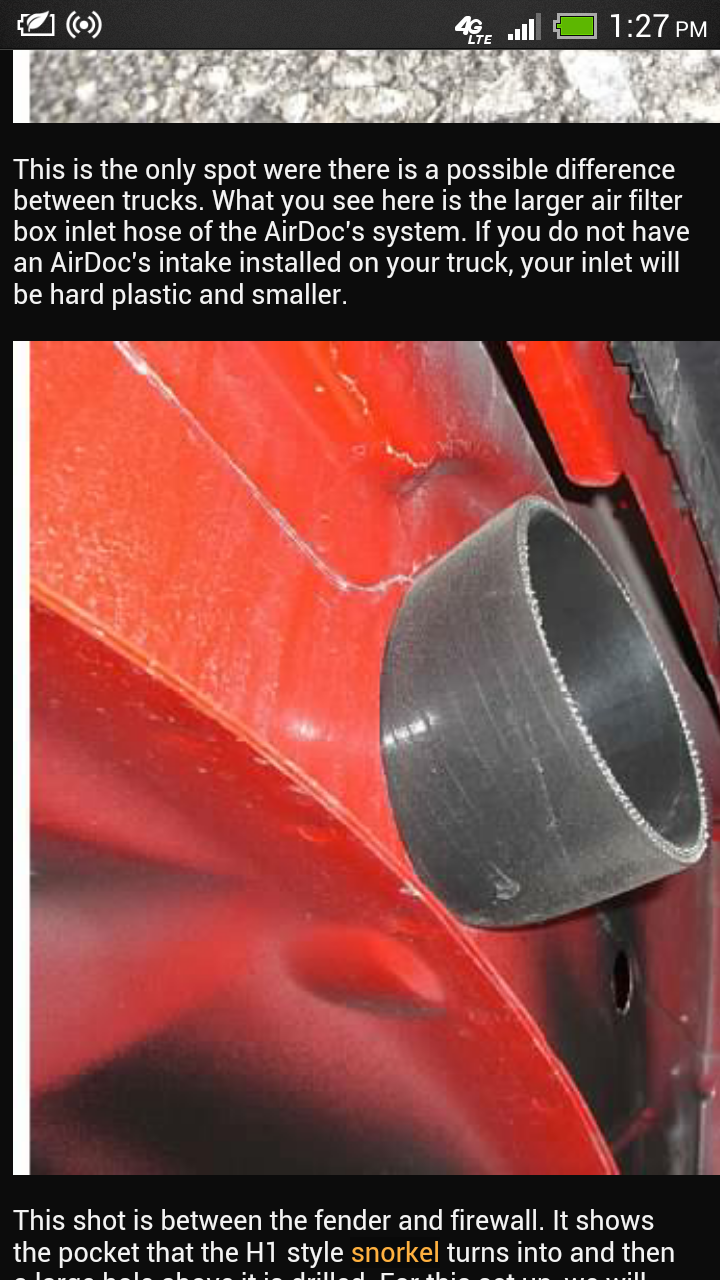

So I think I'm gonna put a Sherpa on my truck. Along with rerouting breathers. I know some of you are skeptics about the snorkels but with my thorparts front bumper and trimmed back fender liners, it just seems like an easy way to splash water up into the inner fender. And I just think they look sweet. I'm hoping to hit an overland route called the Ozark overland trail aka "high water mark" trail. Water crossings are abundant, although not "derian-deep". … (sorry buddy :wink:). I fully understand there is such thing as too deep. But I have some questions about fitting one on my 06.
- I've heard the adapter/tube thingy doesn't fit on an 06 airbox. Only 08-up...
- once the snorkel is attached to the box, how do you go about sealing up the lid tighter? I dunno if my airbox is warped or what but my lid is a PITA and fits kinda like poop on the box.
- I have an airdoc so I have the big rubber hose going through the fender. Does that add any benefit to help with installing the snorkel?
- what kind/size of hose do I use for all the breathers?
- could I put some sort of " nipples" in the airbox and plumb the vents into the airbox or is there any sort of pressure or airflow issue where that would be a bad idea?

It does not fit an 06 box. Idk what you would have to do to make it fix with the airdoc but with my stock box intake the sherpa piece isn't even close to fitting

The 06 box has a round flange where the stock inlet fits on. You toss that out and put on a 3"-3.5" piece of silicone tubing so you then have a piece of silicone tubing sticking through the fender with an open ing of 3.5".... I'll see if I can find a pic.

like this

im wondering if the elbow that connects to the snorkel inside the fender will fit in this piece of tubing and just put a hose clamp on it...
