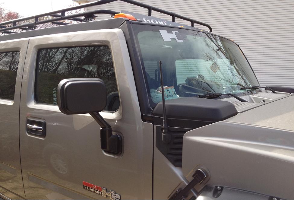

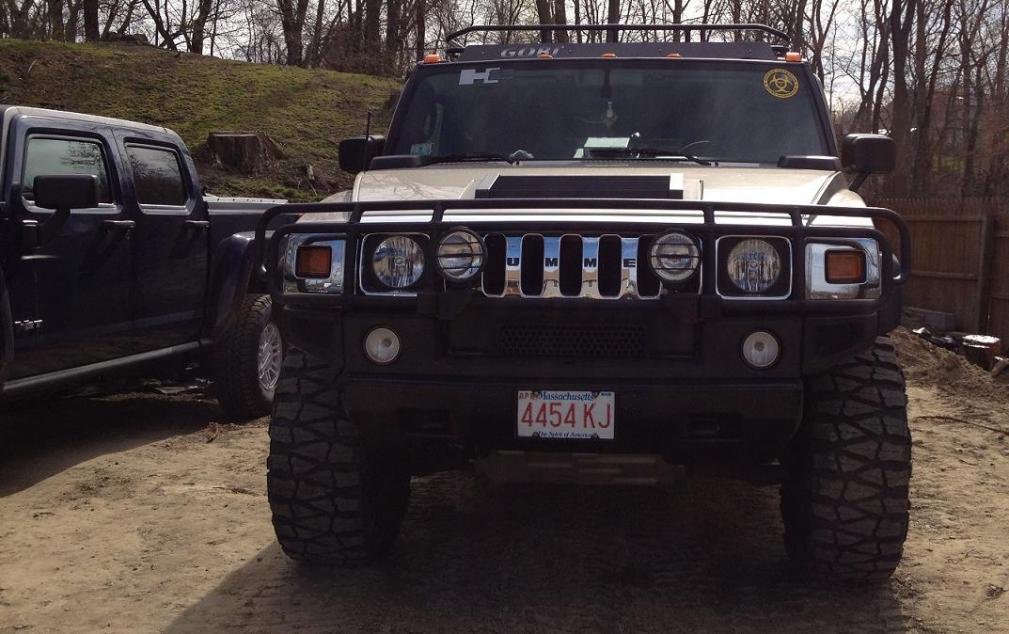

All this recent Plastidip talk sort of rubbed off me yesterday so I stopped in at Home Depot and picked up a few cans and decided to try it out on the 05 H2. I always wanted to cover over the shiny mirror chrome and always wondered what the truck would look like with the the front cowl covers in black as well. Now I know. Now I need to figure out what else I can dip. I have 3 trucks to experiment with :thumbs:

ooo I really like the cowls - don't think it'd have the same effect on a black truck though. Are you spraying it on? Did you paint right over the chrome? Any prep required? I'll probably do my brush guard.

One thing I learned quickly about plastidip is that I didn't need to mask off painted areas like a rocket scientist. If I oversprayed a little then careful cutting with a knife and the over spray peeled right off. As far as the cowls, I removed them from the truck. They are only held in place with 4 metal snaps and a plastic guide pin to line it up. It just took a little bit of gentle prying with a screw driver and they popped right off. After that it was just clean everything up and I ended up applying 4 coats of plastidip. In fact, once I was done, I started to get plastidip fever and started to think about what else needs to be done ;)
