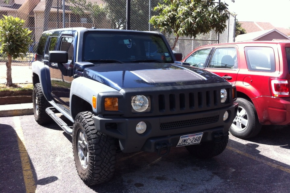

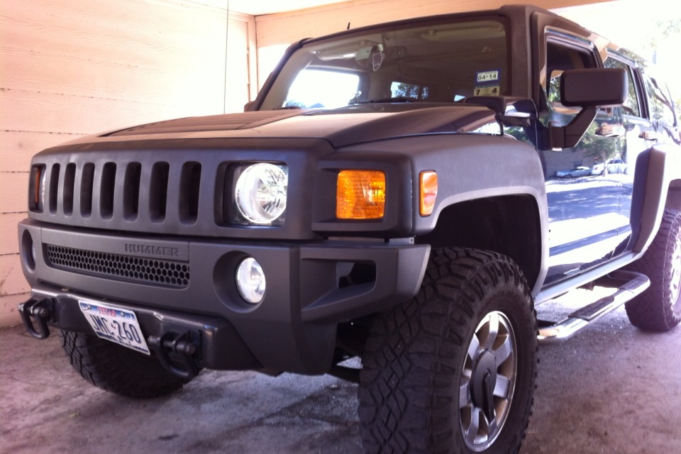

Hello everyone I have 07 H3
But I have issues right now
I've been through a few rebuilt transmissions already but now I have all 3 of these. Please help anyone
C0306
P0741
P0496
"Serv 4WD" message on my info screen
Some other pics of it ImageUploadedByTapatalk1376162429.604255.jpgImageUploadedByTapatalk1376162451.856478.jpg
