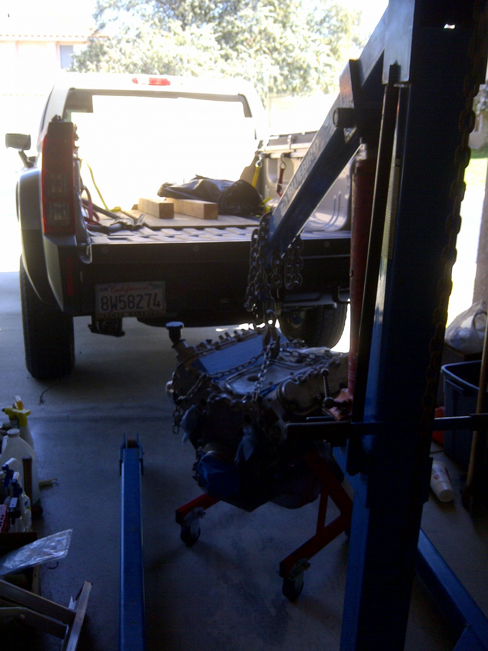

Rental engine hoists are cheap and well worth the money.
