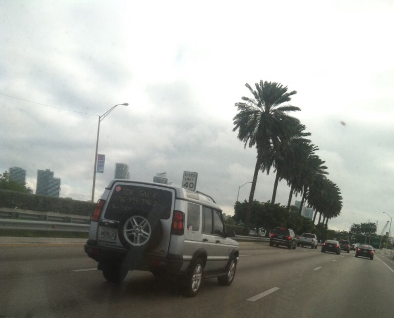

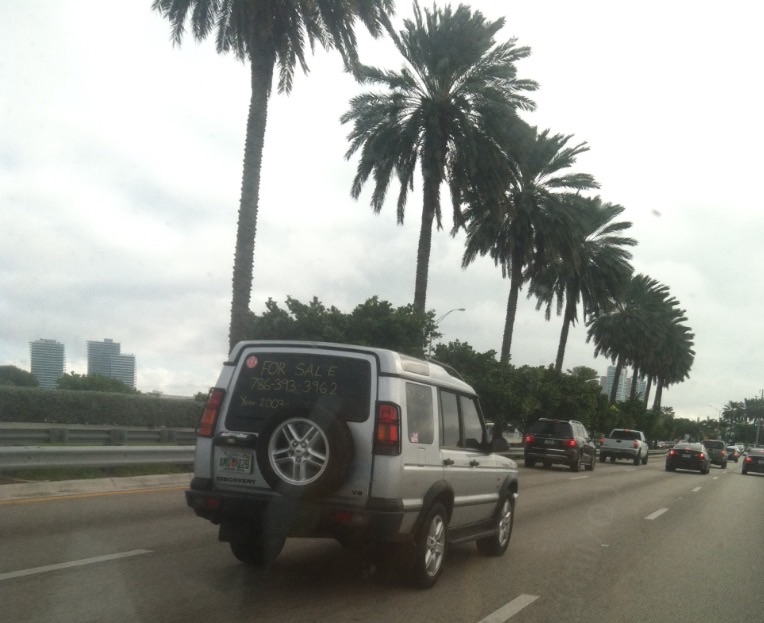

Saw a 2003 v8 for sale today and remembered your build so I said let me snap a pic to show ya. I've got another one i see daily that I'm not sure what year or model but it's definitely sweet. I'll see if I get some good shots to post here. You probably know all about it. Hope alls well, sweet build, take care.

cool - I'd avoid 2002 up because they have the transfer case that doesn't have 4 lock, especially since I'm not sure you can make SLABS happy with the diesel... you can swap cases, but it's an added expense.

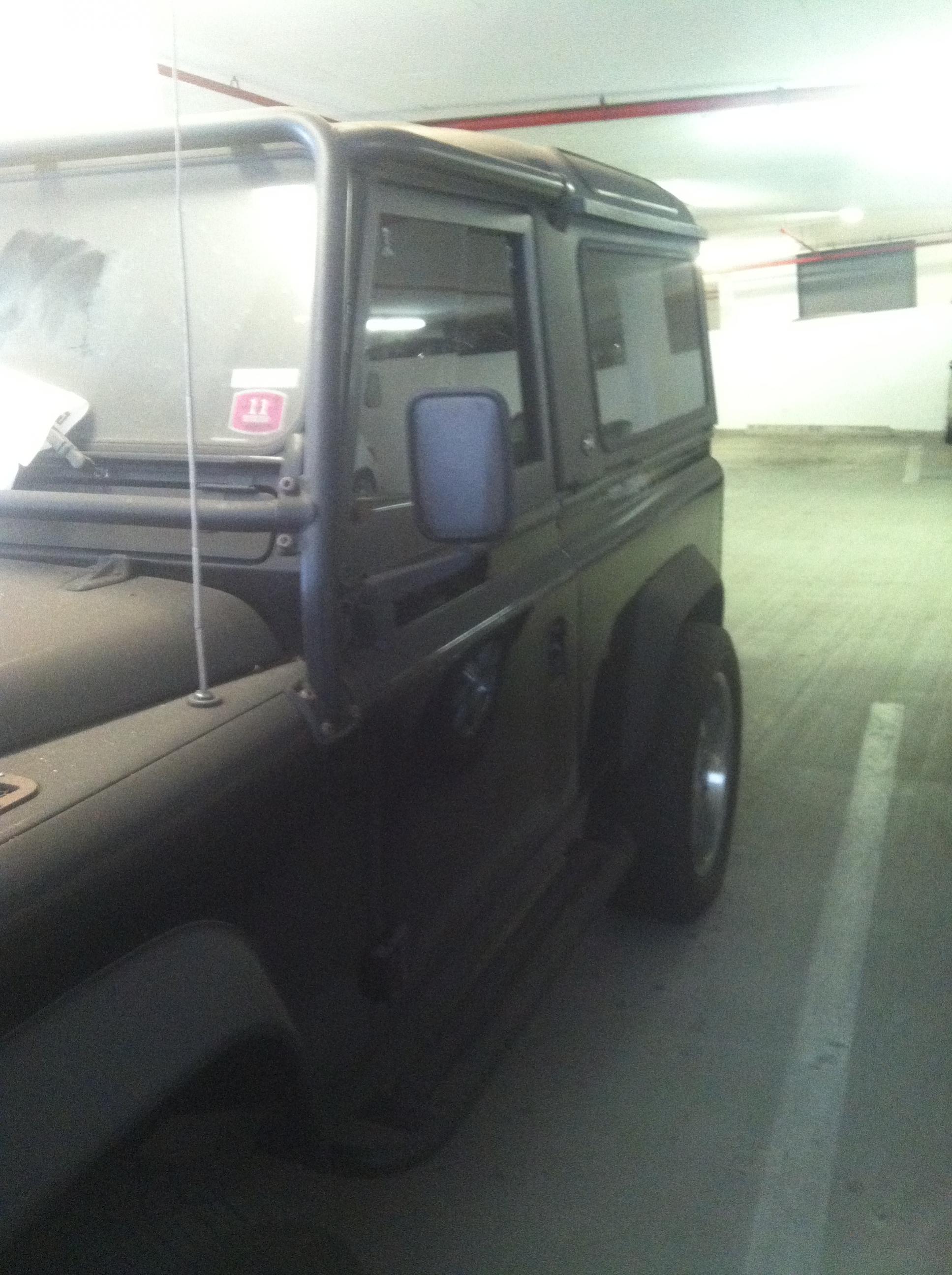

Agreed, i'm sure folks with opinions on my hummer, some might be true and some not. My truth is what matters to me, where shes taken me and the fun...the journey...like your various projects too. :cheers: to the journey and check this thing out...poor thing hasnt seen pavement in the longest.

I like how they're keeping it pristine for me :)
I own one of just about everything - they all have their goods and bads. That said, if a Defender came my direction (more specifically, a D90) it would quickly get the diesel that's currently in my D2.
