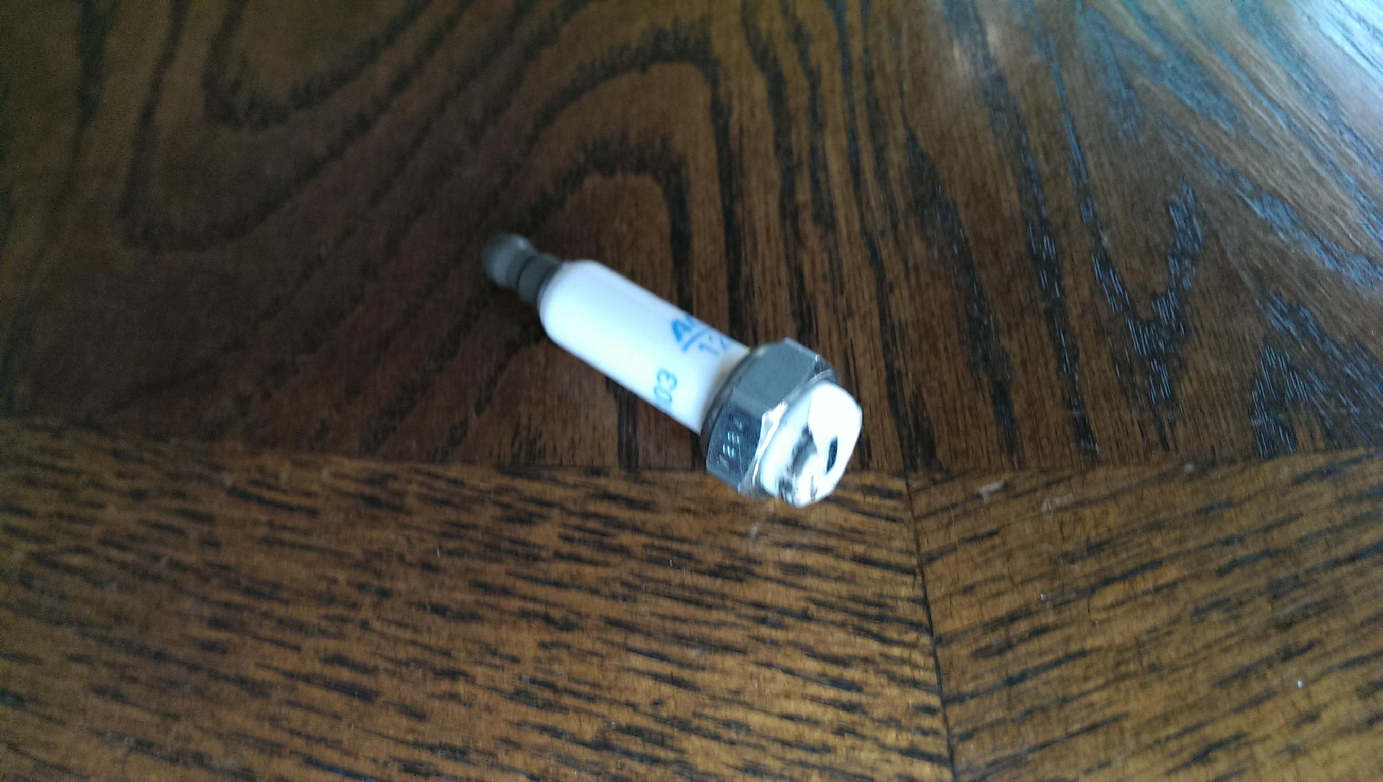

This is what broke off yesterday... everything south of that very important nut is still in the engine block... (The threads), Went out in between rain storms to try again with the extractors (After cooling down from last night ), and it's the same story, the extractor wont bite in either direction that I turn... Guess I've just gotta take the bullet and say that I'm S%$t outta luck till Monday... Just glad that it's the weekend, work less than 5 miles from home... Just hope that Monday It'll be fixed and I can drive it again...

chaos254
577
Broken plugs are a bitch. One of the reasons why I try to replace plugs before 75k. You can try to drill it and extract or weld a nut to the end of the plug
Soak that bitch overnight in PB Blaster...and use an easy-out on it. Easy outs work good especially on stuff bigger than 1/4 inch.
Thanks, chaos, definitely a bitch... tried every possible solution that has been suggested to me by auto parts places, lowes employees, etc... Sucker is not wanting to come out... Luckily my mom is letting me borrow her new Jeep to get to work till Monday.
Thanks 4speed... yeah, I can give it a try tomorrow... but I'm about tapped out. Don't think I'm gunna do something like this again on my own... will probably just leave it to a trained "professional"... atleast I can say that I almost know how to do it on my own, and that I'm theoretically running on 4 1/2 cylinders. :wink:

Finally got the H3 back from a day with the morons at the mechanics shop here in town... Fricken idiots tried to come up with all matter of things that were wrong with my 3... but they did get the plug out and put the new one in and it seems to be a bit more spirited then what it did... (Driving better/as good as it was before this low power problem) Just glad to have it back up to snuff and home... NOW on back to saving for my bottomless list of mods. :woot:

Maybe it was over torqued? You do torque your plugs?
In engines with tight specs I learned that the wrong torque can change several things, for the worse.

The plug that broke was torqued on WAY too tight by a dealership that we took it to when we were freaking out about the misfire about 2 years ago... Suffice to say, we don't go to that dealership anymore... But instead of me stopping and hitting the seized/over-torqued plug with pb blaster or whatever, I went at it with brute force and ended up with half a plug... Atleast I've got it back and it's driving well enough with the new plugs, that's all that I was worried about... Having my vehicle back before the snow hits...
