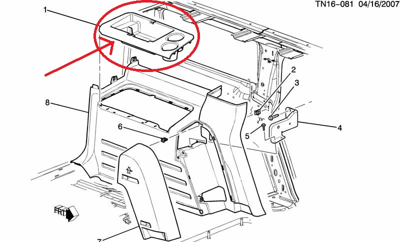

Pocket, Trim Panel - Left rear Part #20794441

I'm wondering if Part #20794441 will fit pre 2008 H2's? I need to replace my drivers rear pocket as well but Part #20794441 is listed for 2008 & 2009 H2's. Also searching for a rear pocket using '03 to '07 years doesn't show any results. The drawing of said part # also shows two cup holders and I know my '05 H2 doesn't have cup holders. It may fit anyway but considering all the changes they made starting in '08 I just wanted to point out the difference.

In earlier 03-07 models, the parts list shows the entire panel as being one part, not just the "pocket" piece itself. If this is the case, then that would be part # 25819224 (panel assy, side trim, Right).

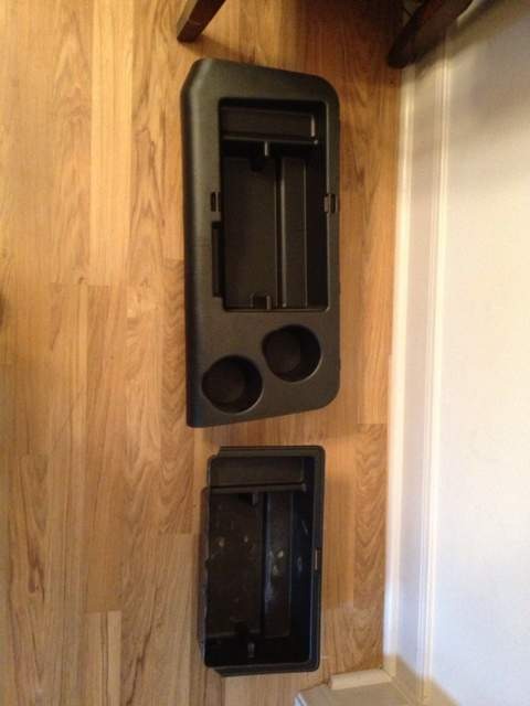

Well guys..... Here it is. Just got it.
Not even close....
The old beat up tray is mine. The new part number 20794441 is next to it.
No Joy.
Let me know if someone out there has a later year H2 and needs one.

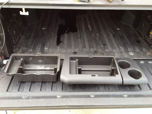

Well guys, while I'm waiting for a good part, I took the new "wrong" part I ordered and cut the cups off. It fits in there ok and it holds stuff really well. Just doesn't look all that great. Lots of gaps. Although I could trim it a bunch more and get it looking better. I'll wait and get the correct part.

I got it from the GM Parts Club for around $30.
The correct part would have cost me $229 to buy the entire left rear trim panel. Nobody I found would sell the individual tray. I'll have to find someone willing to part with one or find a recked vehicle.
I probably should have given it to someone, but I didn't think of it at the time. So I decided to make it into something I could use.
