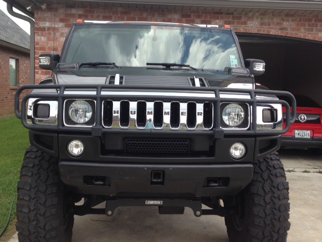

Blacked out my tail lights and front turn signals. Also used wipe new on my bumpers. The stuff works great. I also noticed that i have fab tech heavy duty tie rods. :)
