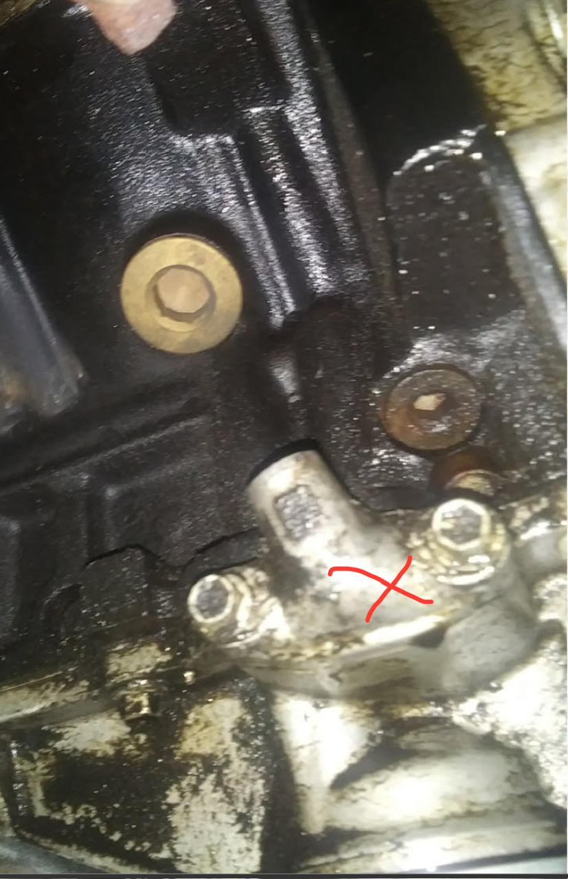

Used dye after cleaning engine, it's coming from under the head of the rear oil pan bolts on passenger side. Close to 2qt a week depending on how much I drive.
Friend suggested thread sealer since bolt is super tight already apparently. Will try that soon.
