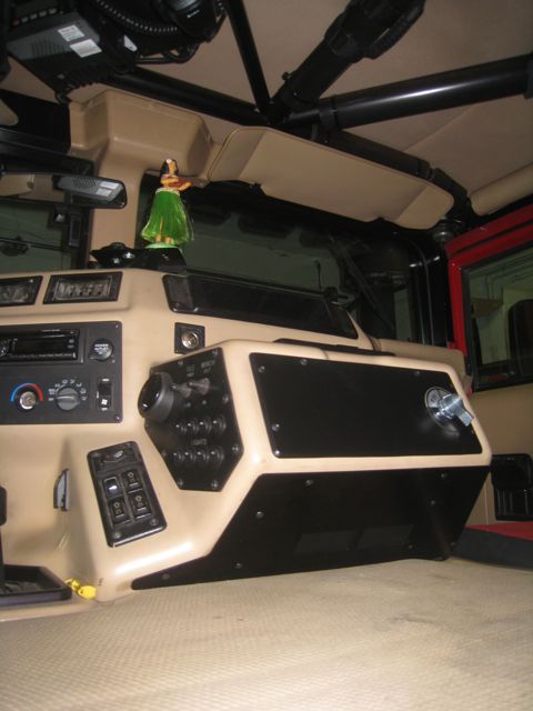

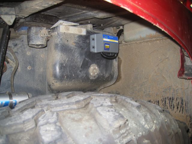

I also got a little bit of spare time to get some work done on the truck -- though only steps 1 through 3 of a 10 step list of stuff I want to do!
-I added a marine battery tender so when the truck is parked for long periods of time the batteries won't take a pooper with all the electronic doohickies sucking on them.
-I had a master battery kill switch installed where the glove box used to be and finally put the lower close-out panel on the hole where the ac used to connect. The panel my upholstery guy made to replace the glove box is where I will mount future switches to control the airbags and deployable stripper pole.
-in the new empty space where the glove box used to be I mounted my new manifold/solenoid chingus to control the airbags. I will replace all the lines with braided and run them through the access hole already in the floor where the old ac lines used to be (yay -- no cutting the floor open)
