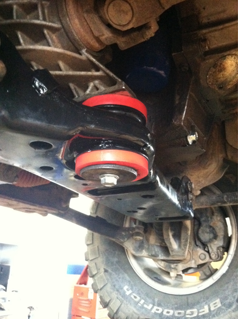

The first of the ScorpWorks H2 crossmember update prototypes was installed yesterday. The integration went well and fit great. Thanks to John for providing his H2 as the "guniea pig".

Wow, I was thinking about this very issue this morning, so great timing. Looking forward to hearing more and when they will be ready for sale. Looks like a thing of beauty.

I agree, does look very high quality. I'm curious if it makes it any easier to get the oil filter out without oil going everywhere...

The update does not change the oil change mess issue but the polyurethane compound of the ScorpWorks bushing will be more resistant to the oil bath condition the bushing is subject to during oil change. Polyurethane is naturally more oil resistant than the natural rubber used in the OEM bushing.

The ScorpWorks H2 CMU is priced at $250.00 plus $150.00 refundable core charge and actual shipping.
Availibilty is going to be based upon rotation of the few cores we have in stock.
Take a look at Zach's post in the H2 section on his installation.

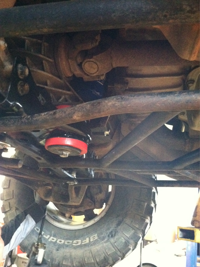

The are available. It is stout. I'm running one on the pig.
What did you do for the 2 other rubber bushings on the diff??? Did you replace those with poly also?
Looks real strong btw!
The two on the diff are the same. Both are encased in a metal sleeve. The lower one I replaced quite a few years ago with OE. They are not that common to go out

I have one of these bad boys on the way. I figured I had to get out some jack stands, but I should be safe.
I'll post some before & afters if anyone is interested. My old bushings look horrible.
Synthetickiller
96
Got mine installed.
It was a bit of a learning experience, as I'm new to working on cars. Took me much longer than 15 to 30, but I think if you have a set up garage & know what you're doing, it really should be that long.
I did only 2 test drives, one for about 15+ miles & another maybe 5.
The bushings have almost entirely stopped the shaking I had in the steering wheel. As well, I never get shaking in either the break or gas pedal. For that alone, it was worth the money.
I'm extremely satisfied. :D
