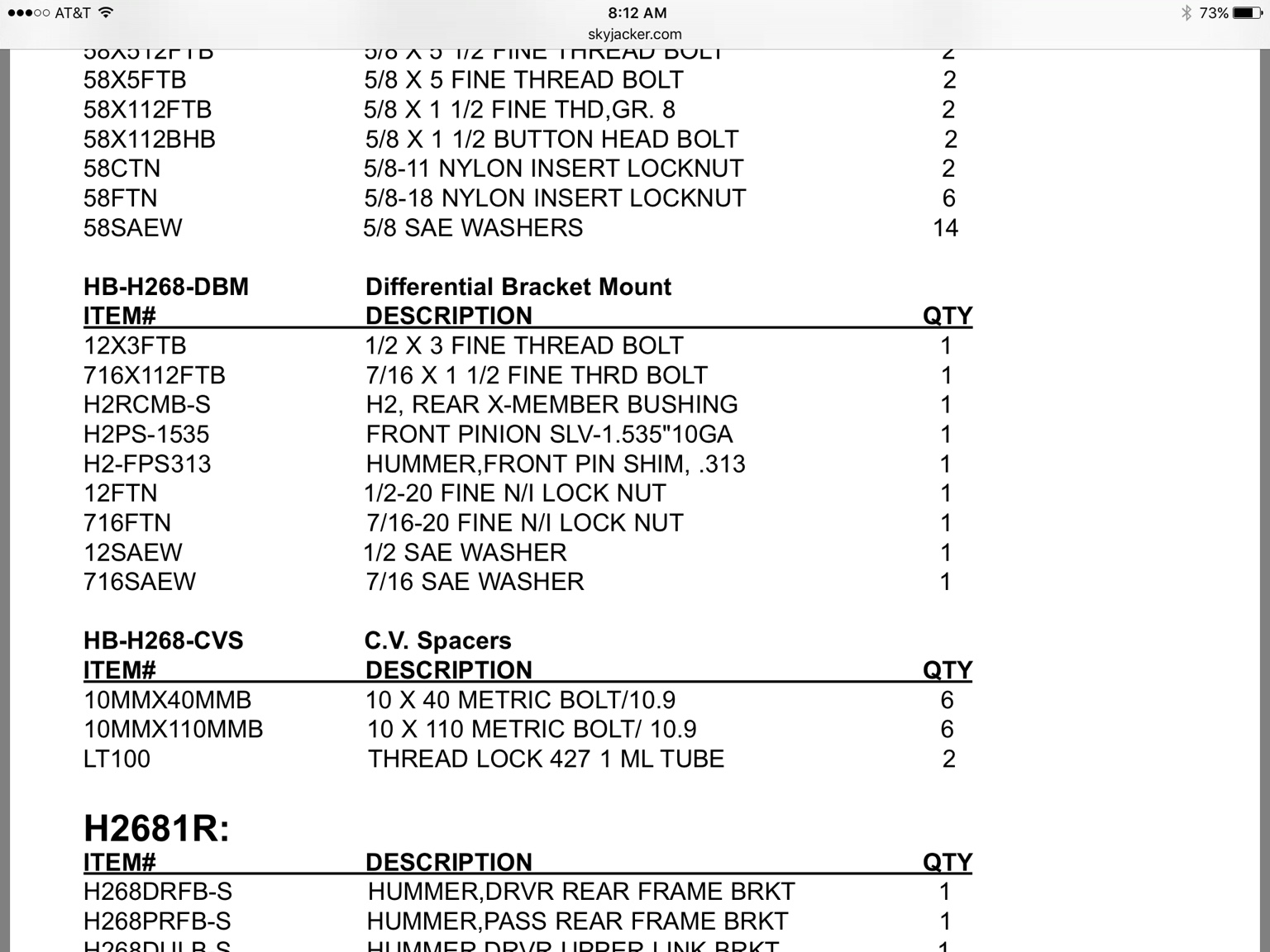

I have an aftermarket crossmember (at least I think I do!) with my skyjacker lift kit. Would modification to the bushing still be required? I'm at a loss and need to get this replaced asap!
Big2dabank
Central Florida
Is the cross member separate from the drop bracket, If so you may need to remove it and send it out. I would talk to Dwaine at Scorpworks to see what options you have or maybe call Skyjacker and see if they can get you a bushing for your kit.
Big2dabank
Central Florida
From the Skyjacker install manual. It looks like there is a replacement busing. Looks like it's part number H2RCMB-S.
Jasber, I spoke to Dwaine at Preferred Chassis late Friday afternoon and confirmed that his H2 crossmember bushing will fit only a Preferred Chassis-modified OEM crossmember and will not fit an aftermarket crossmember like the Skyjacker one that you have. Best bet, like Big2dabank said above, is to contact Skyjacker to get a replacement bushing. They should be able to help you out.
