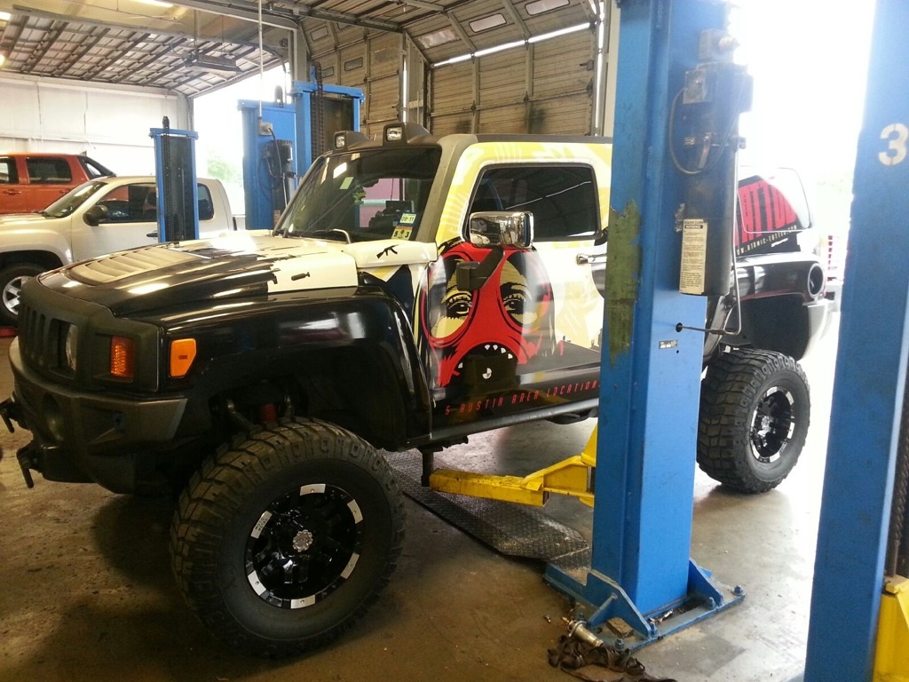

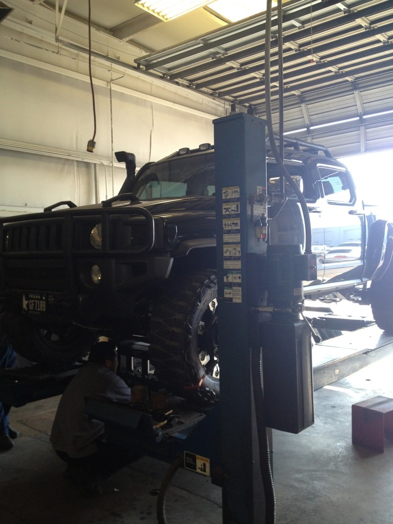

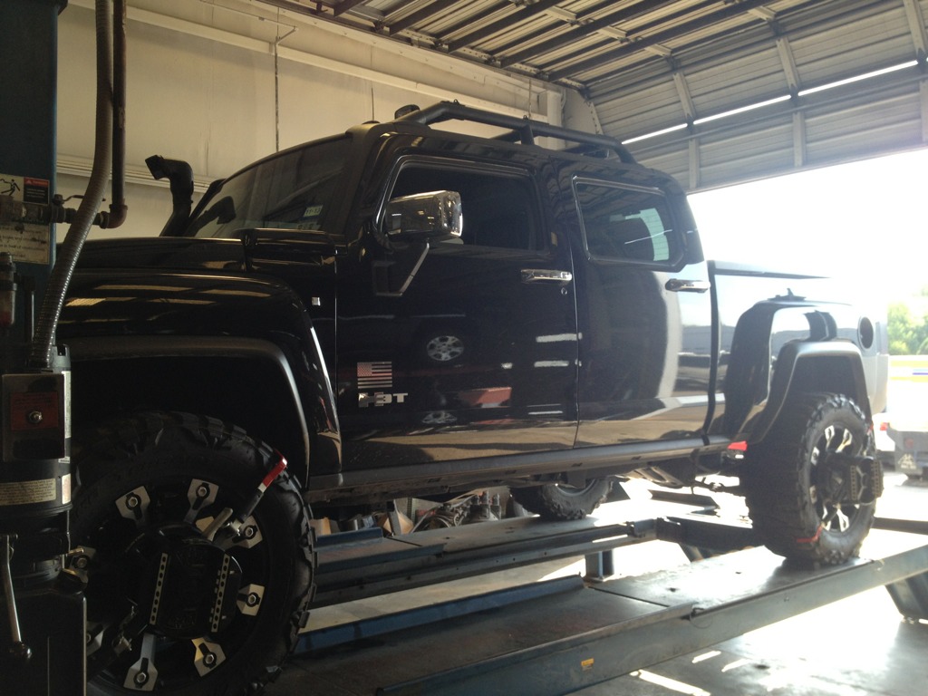

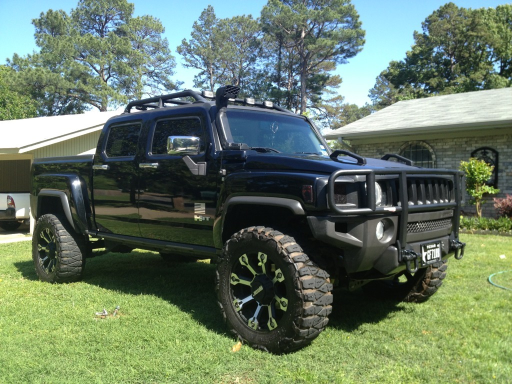

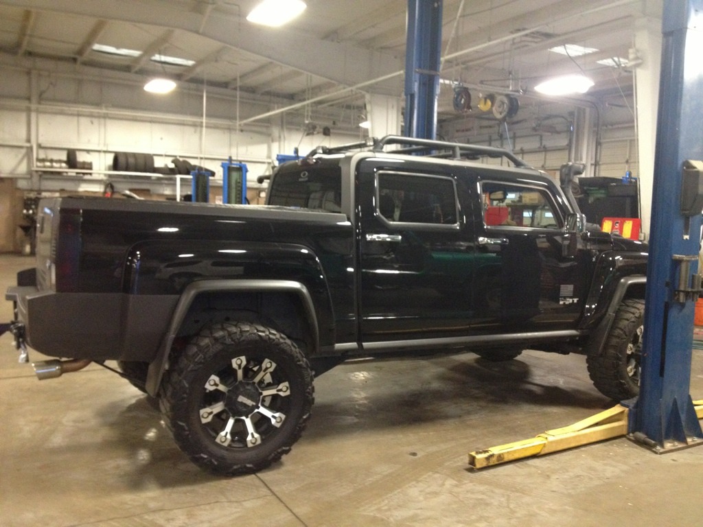

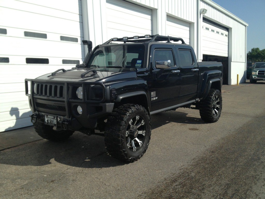

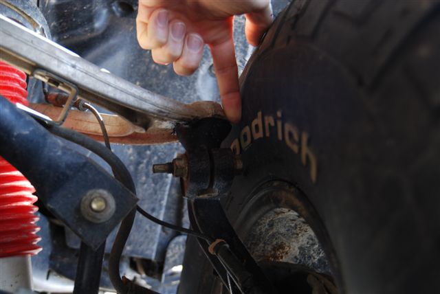

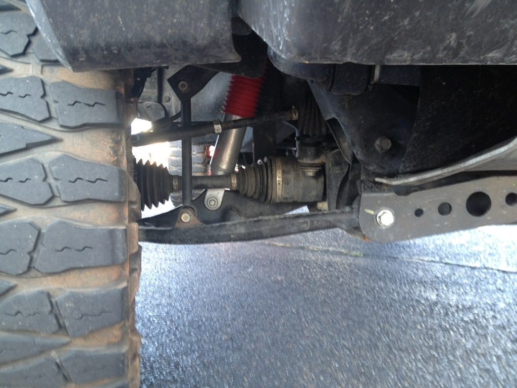

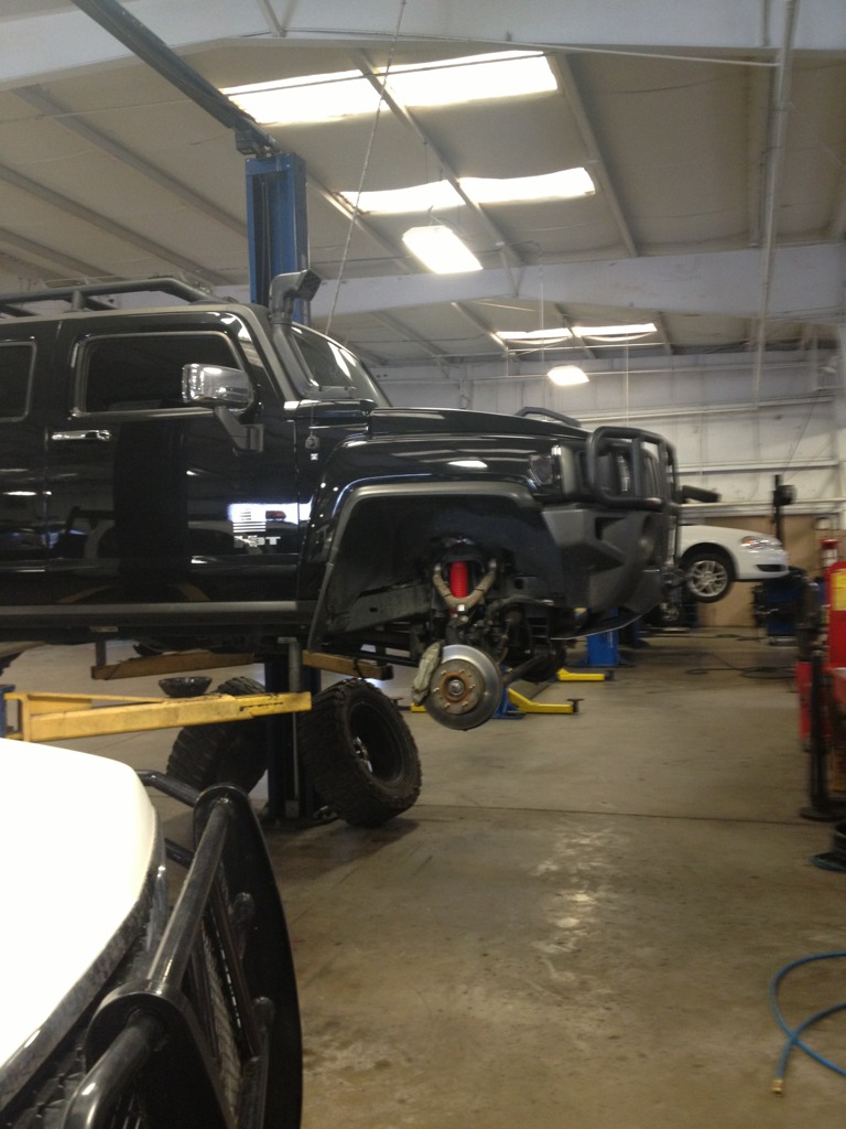

Well lift fits like a charge but ran into an unforeseen issue.. So I'm stuck in Austin for the night.. Will see what tomarrow has in store.. Ohh did I mention I'm hoofing it everywhere I go lol
TAPDH3T
1,510
Texarkana, Texas
Hope it wasn't a wheel issue.
TAPADROID
That's exactly what it is!!!!! When I bought these wheels I explained I needed a 5.0 back spacing so a Rancho lift would fit.. The wheel shop that sold them told me these would work.. Welllll they don't.. After searching I found that there back spacing is actually 5.71 and the knuckle rubs. So I had to stay over night and I'm now waiting until 9am for a offroad shop to open to buy 1/4 spacers...

I can't remember what my backspace is, but I went with the motor sport tech 1.25". I put them on and rechecked them, they were still tight. They were also long enough to put on and not cut off any of the wheel studs. I'd stay away from the slip on spacers if you can unless you put them on just to get by. Also mine were hubcentric. I can run 80mph with no vibration. Honestly I can't tell any difference with them other than visually and I like the looks of the slightly wider stance.

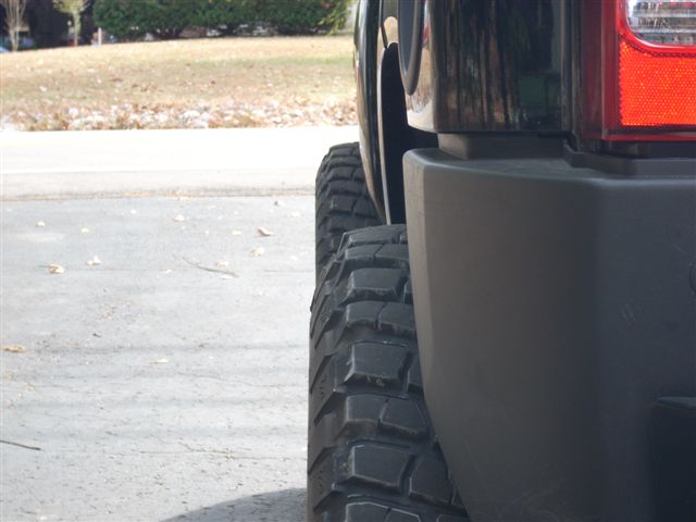

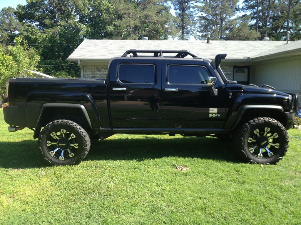

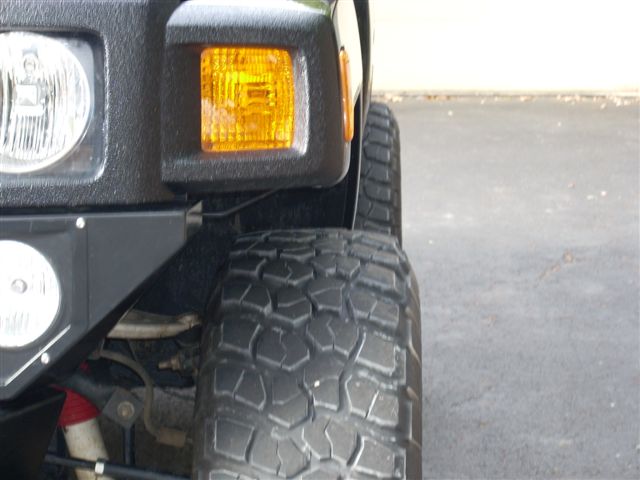

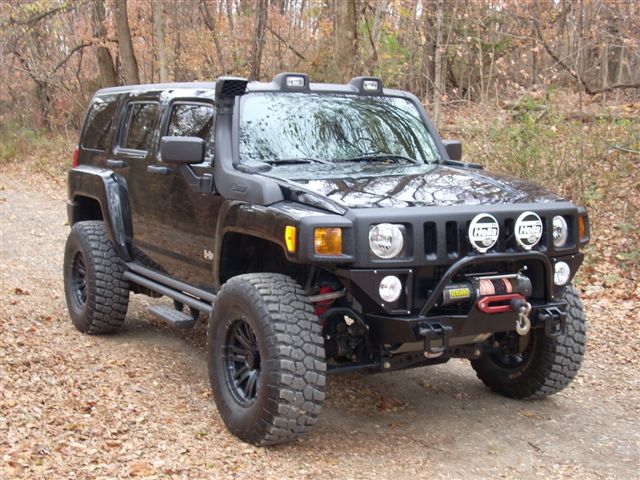

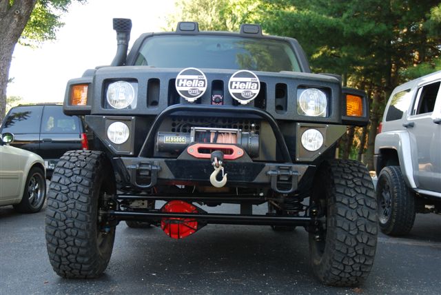

Rancho lift.

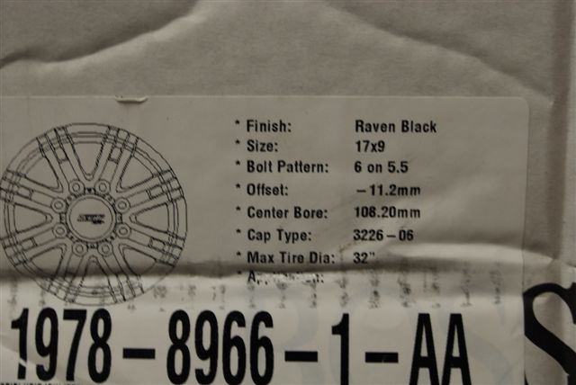

American Eagle 17x9s with -11.2mm offset
35" BFG KM2s

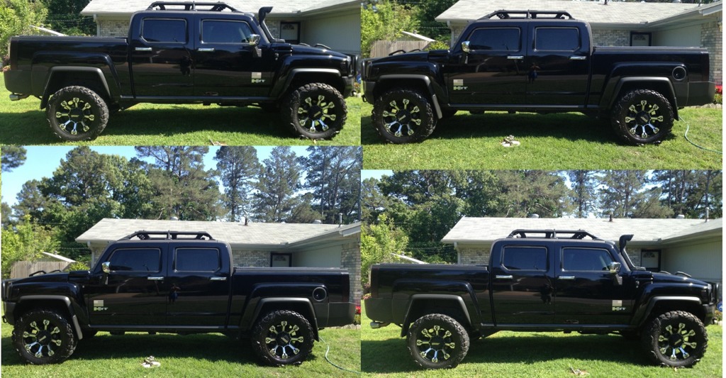

The fit looks like this...
Wheel info right off the box...
I've run 80mph with and without hubcentric wheels...doesn't seem to make a difference. The lug nuts center the wheel.
BTW...these same wheels fit the stock Dana 44 6-lug front axle. They don't stick out any further with the SA than they did with the Rancho. They look like this with 37"s...

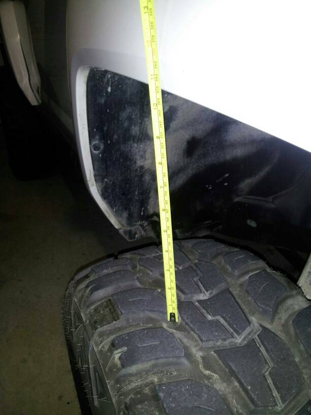

This is with 35s. The tape is at the bottom of the tread blocks. I think my hub center to fender was about 26.5". It rides nose up just a little.
