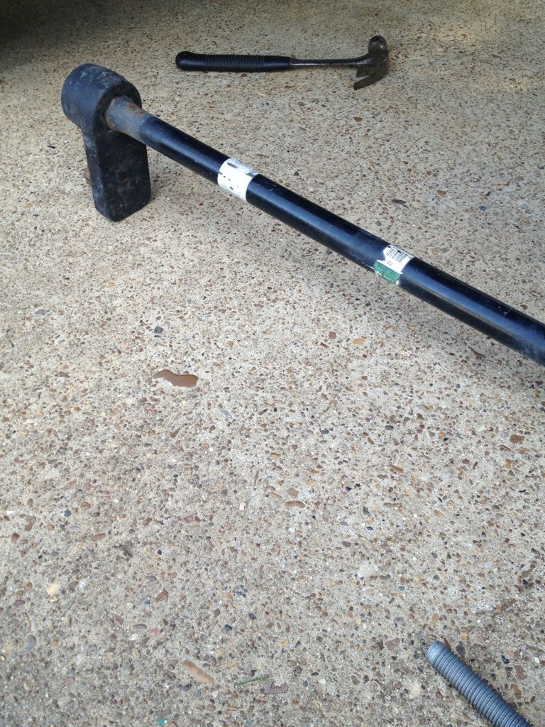

Ok got everything out and switched over.. Before I get to involved in the re-install the tape goes toward the engine bay??? I believed he also had one bar upside down cause the tape was closer to the rear end on the driver side

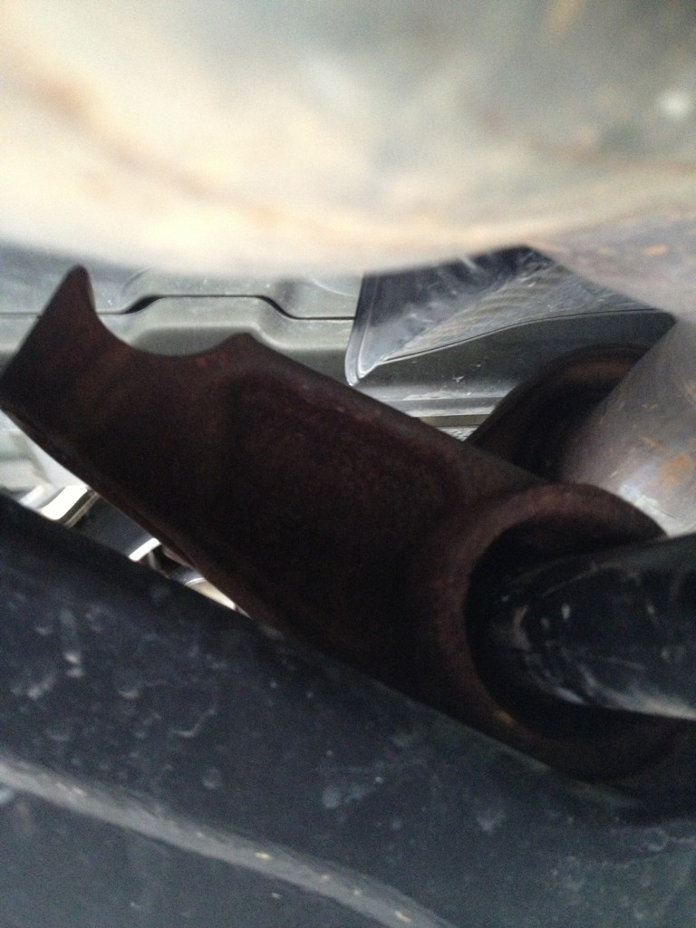

Alright everyone, I turned a 10 minute job into an 1.5 hour job.. Lmao
Not only were those shackles backwards but the keys were placed in a downward position..
(What it should look like with bolt out..)
That's why there was no lift.. Well common sense would of said when I went to take the bolts out and there was no pressure on them that would of been a sign but NOOOO!!!
