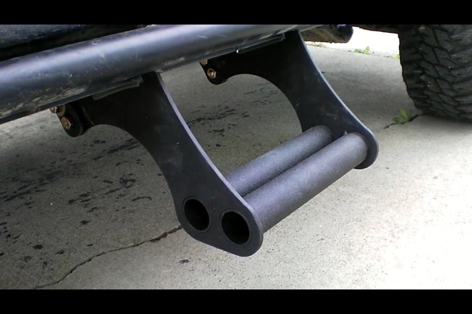

TAPD- I want to use rectangular tubing so it will match the frame and get that OEM look.
FRU- hmmm like this
TAPD- DANNNG UUU FRU!! Well I thought I had a good idea!
FRU- No u had a great idea. Great minds think alike.
Well it wasn't exactly like that but very close.. I just purchased 6X2" rectangular tube and 2X2" square tubing. Also 1/2 steel plate, 3/16 steel plate, & 1.5" round tubing..
FRUs pic is pretty much the look I'm going for with some minor changes.

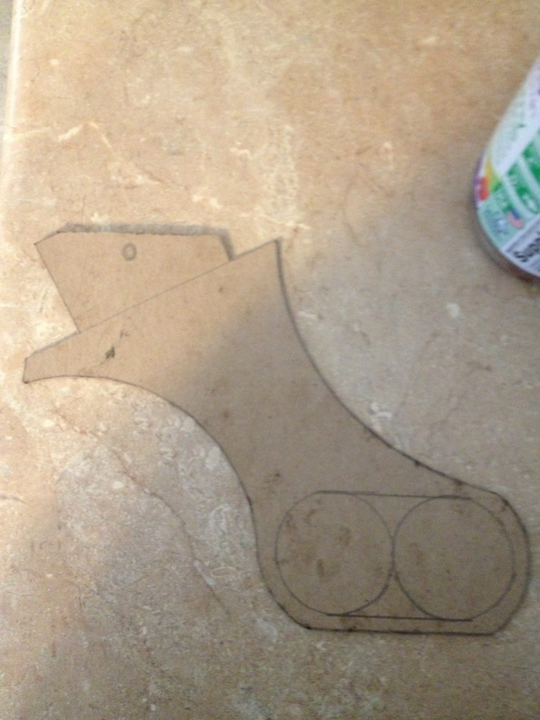

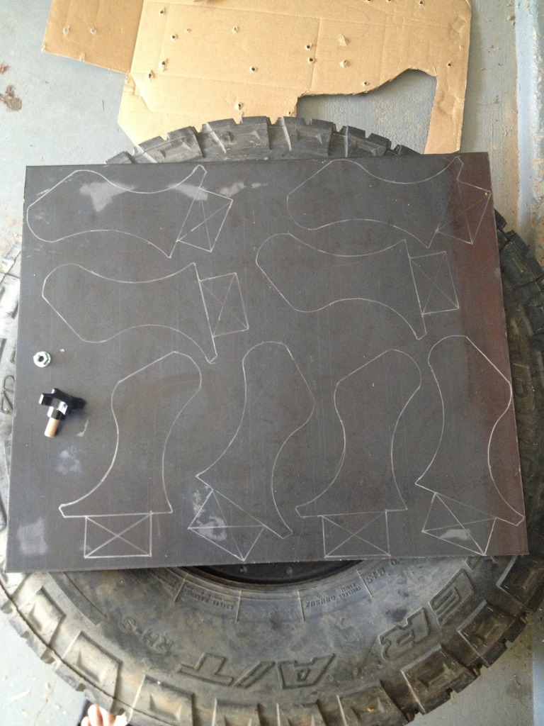

This is my step idea.
My template I drew yesterday.
I'm not going double tubes! I am going to cut one in half and widen it.
FRU brought up a good point about the steps- when they are off the mount point will double as and excellent point to use a highlift jack..

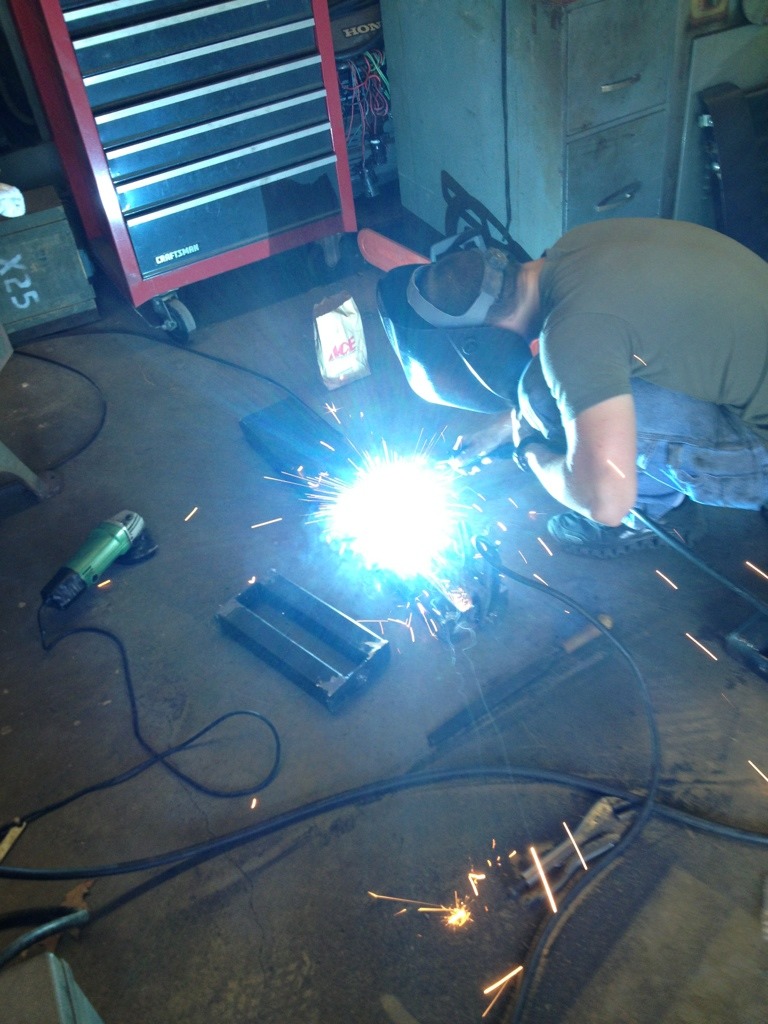

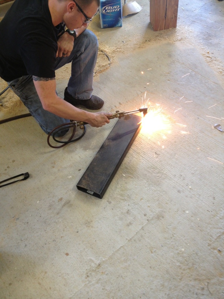

Sooo I lied.. Did not get the sliders and steps rapped up. Working three jobs has me pulled 500 different ways. We did get some work done and we almost have a complete slider built..
After cutting our 6X2 sliders in to 8' sections, we torched some scraps to make our step mount brackets.

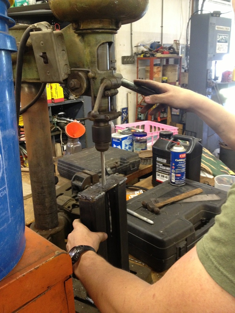

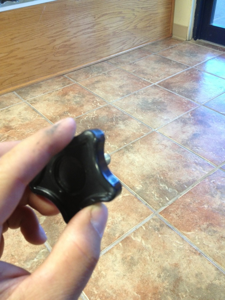

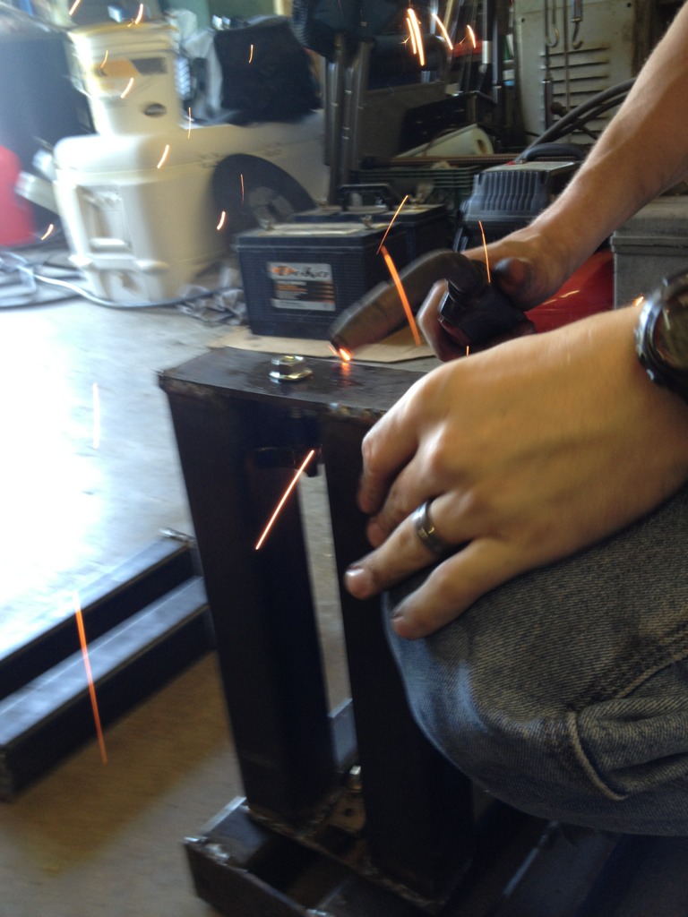

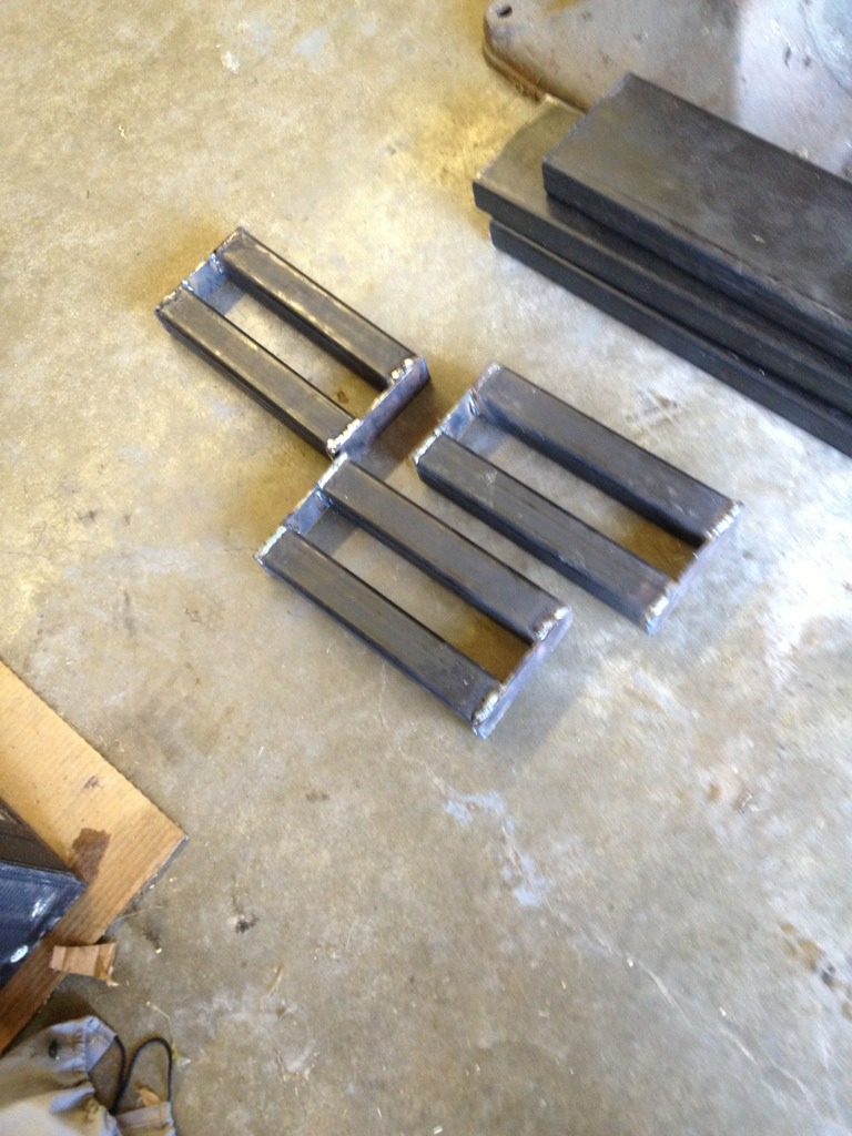

These are our step mounts built with the brackets cut from the scraps and 2X2 tubing. They will also be our lift points for our highlift jacks.. Each will hold a 12" detachable step.
Once built we drilled out wholes for our 3/8 screws and welded our nuts to the brackets... "OUCH" ;)

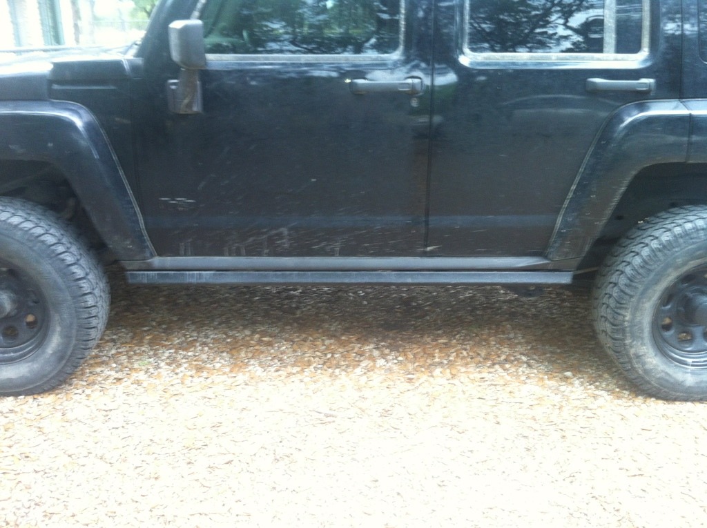

Finally we cut 45 degree angles at the end of the sliders and will be welding on the cover plates as soon as I get them cut.. We got two step mounts welded on but ran out of time to weld the center section to complete the slider.. Once all is done the welds will be ground down smooth for a seemless finish..
