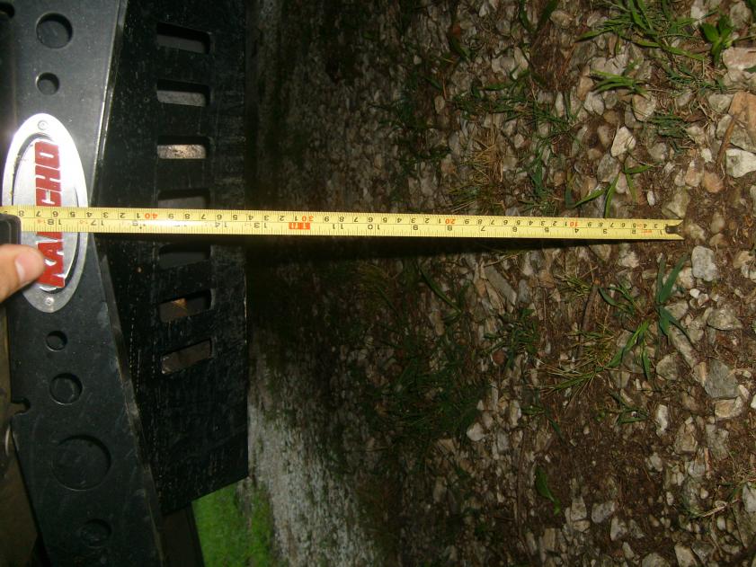

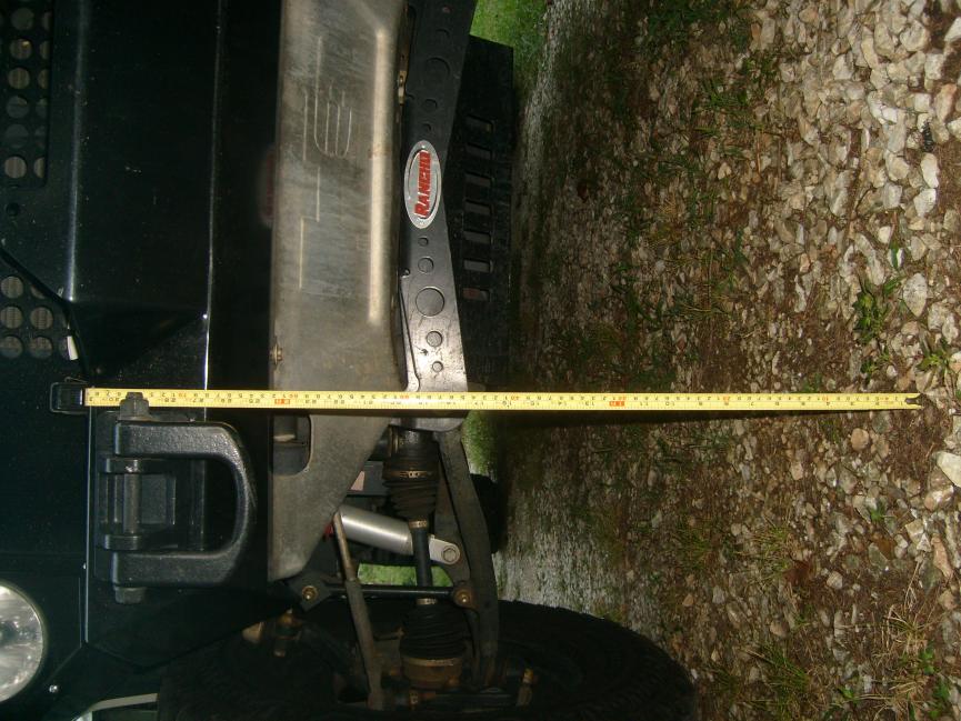

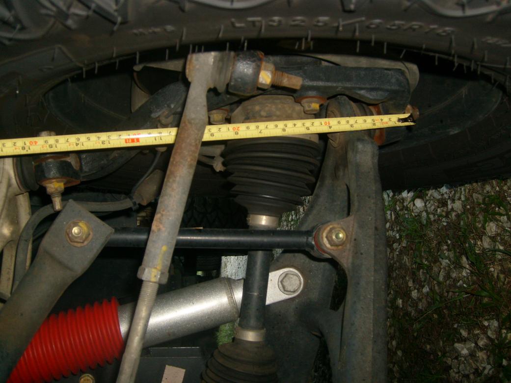

I just ran out side and took some photos and ruff measurements
The Knuckle is about 16''
The bumper ( Thorparts ) is 26 3/4'' on the front and you can see it tapers down in the back
At the center of the Front Crossmember it is 17 1/2''
9,498
Thanks josh! I need to double check but I believe I am at 12 on the front skid and the front skid right below the front crossmember looks like 13

The skid Plate is 1' 1/2''
My H3 sits on 325/65-18s. I did all the measuring on a gravel drive way so i know they aren't exact but I hope this helps give a little more info about the lift.

thanks Josh, while it isnt EXACT it is a good guesstimate. I will check mine now and even if we end up at the same of 12 in. you are at a lot nicer of an angle on the halfshafts
9,498
Pics above this post
crossmember 15 1/2
Skid 11 3/4
I used to be able 12 but overtime it settles. your tires are 35s right?
