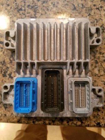

I want to thank everyone on this post & add my recent experience to the list. As part of "My Christmas to me", I sent the PCM on my 06 H3 to PCM of NC for a retune to match the new tire size I was adding. What should have been an easy swap turned into a week long ordeal. When the PCM was reinstalled, the truck wouldn't crank and it was throwing out all kinds of codes. Long story short, an unknown gift from a previous owner was the source of most all my troubles. The locking lever on the center connector and 2 of the 4 locking pegs on the PCM were missing. This was preventing the center connector from making a good connection and causing all the codes I was receiving, and as a result of trying to get the truck to accept the new tune, ran my battery dead. A new battery, clean terminals, and a lot of advice from online posts, PCM of NC, and the service dept at Serra Chev in Bartlett, TN, I was able to get my H3 up and HUMMING once again. Used a nail file to make sure all the pins on the PCM were clean, got a $3.00 tube of dielectric grease from Autozone, greased the pins and squeezed the snot out of the center connector to make sure it was fully seated prior to setting the locks on the 2 remaining pegs with a screwdriver.
Once everything else was hooked-up, she fired-up on the first try and hasn't run this good since I got it last August. Hope this helps someone else on down the line.
