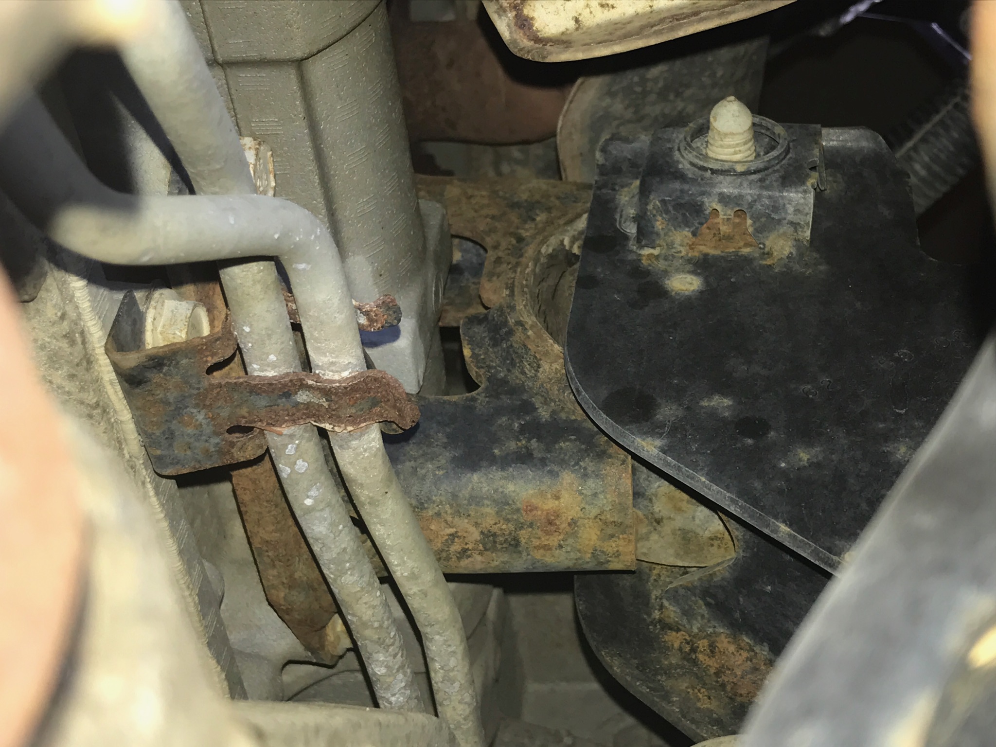

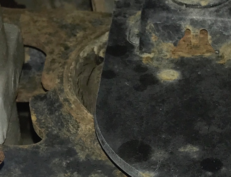

Now, working on fixing a rough idle/vibration which seems to be the motor mounts. I attached pictures of the cracked rubber on one of the mounts.

So replacing the mounts did improve the idling, but it is still not 100%. More often it is better, but at some times and after driving a bit, there is still a noticeable rough idle/vibration. I feel it mostly in the steering wheel.
Also, something new happening is that on start up, this is pretty difficult to explain, it kind of shimmys or wobbles (left to right motion). It lasts for a second or two and goes away.

The I5 is not a smooth running engine at idle. I get what you have from time to time. Seems it likes Shell gas the best for me.

I've been using Exxon for the past few months, but I will fill up with Shell next. Thanks USMC

Try running a couple bottles of fuel system cleaner through it too, idk how many miles you have, but I run a few bottles through mine whenever I remember and it helps clean out carbon
